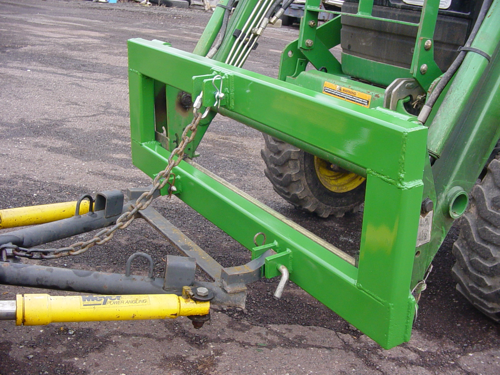

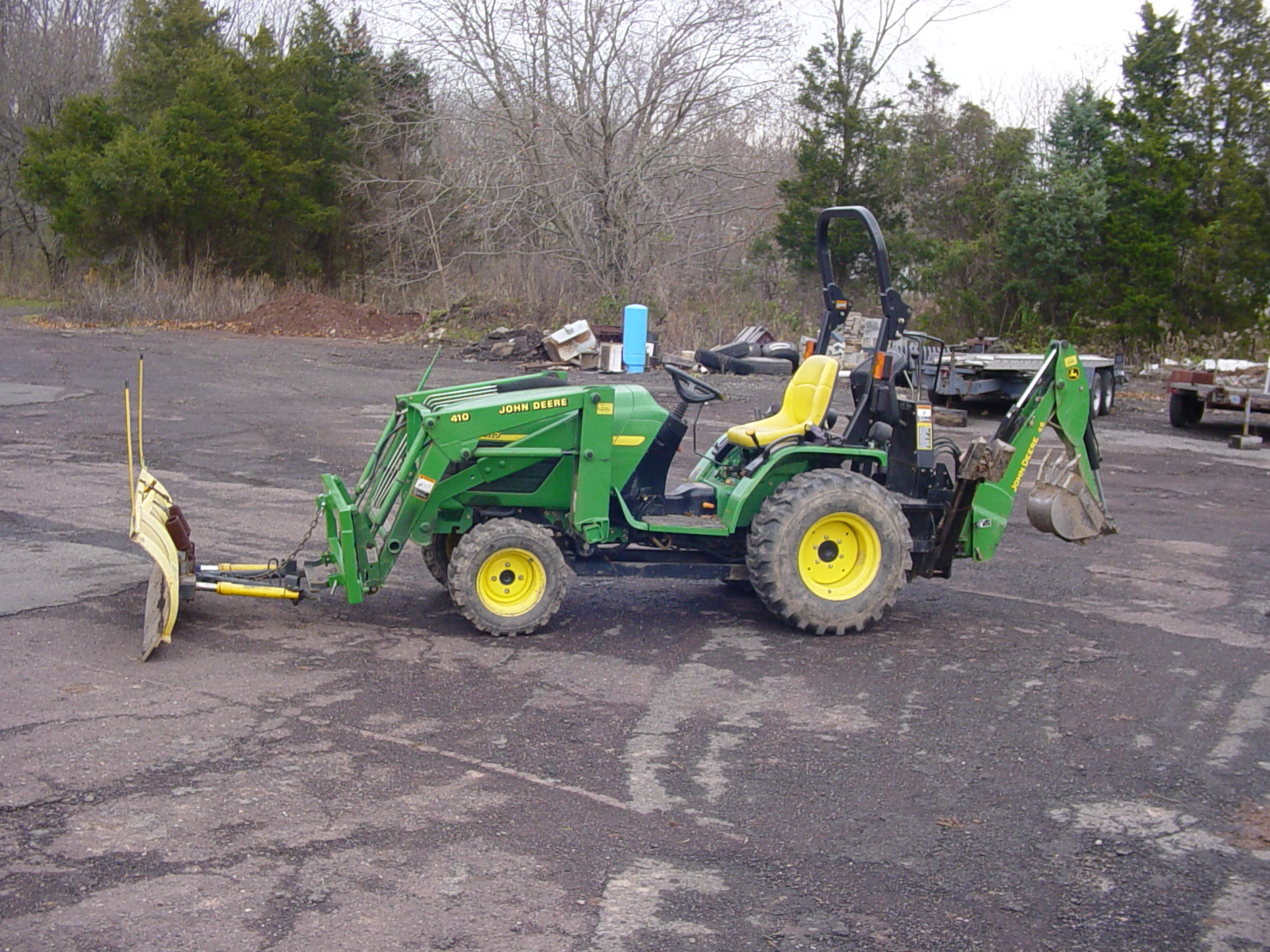

thanks to kennyd, here is my setup, works fantastic. the loader arms keep alot of weight on the front end, and combined with the steering brakes, i have no problems at all pushing a blade full and even turning with a full blade. the key is allowing the blade to float on the loader. plow blade is a full 6.5 ft, from a ford ranger.
Nice job! I hope it works good for you. Maybe my mistake was not using a chain, If I still had it I would try it.
One sugestion though: Find a way to limit the upward travel so the blade can't go 90* while your pushing up banks. The would scare the s**t out of you!
Lets get those hydraulic lines hooked up:D
/ 4100 plow blade quick tach/loader arms? #11
thanks kenny, those pics are over a year old, i have since hooked everything up using a prince manual diverter valve for the FEL lever to angle the plow. i dont have a problem with the plow lifting much, as i lift the loader arms to stack the snow into piles. one time, however, i was not paying attention and it came up on me. my thought was to put a pipe around the chain, limiting the travel of it.
since i use the tractor for my business, i got some contracts for snow removal using the tractor as a cleanup machine since it is so agile and fast, and can stack snow 6 ft high where pickup trucks can not. works great on small parking lots to get the snow stacked up over curbs to keep drainage systems open and flowing during snow melt with no damage to the curbs and landscapes.
