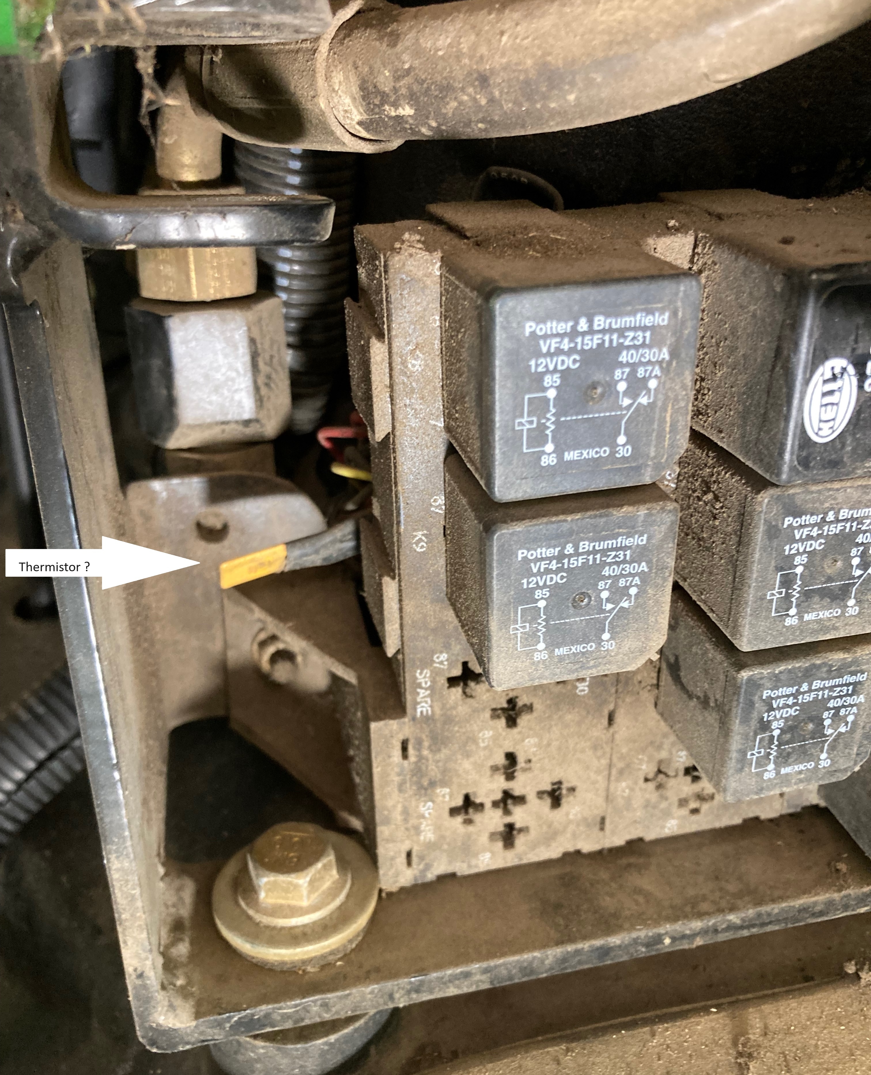

I have a 2001 4200 so it may not be the same, but had a similar issue. The 4200 has a fuel solenoid with a varistor that causes intermittent issues. I found after it was suggested by a Deere technician/mechanic to clean all the cube relays in the control/fuse box, but also to wiggle each one when turning the key. Isolated which one it was (for me, third down from the top) and it starts every time. Good luck.

I found that thermistor tied into the fuse block on my 4300. Innocent looking but packs an important part of the engine running. Arrow points to it.
