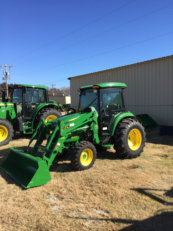

Does anyone have a good photo of the rear 3 point area with the downforce option? I would think the tractor could hydraulically operate both top-n-tilt and downforce but maybe there isn't enough real estate back there.
/ 4052R down pressure
#57
The case 570 Lxt-Nxt have down pressure for boxblades they do not come standard with pto. Admiitly it will drop traction to rear tires that is where experience comes in you don't have to fully engage the full down pressure just enough to get the job done. John deere brochures say for post hole digger and boxblades. I'm not a hydraulic genus and really don't need to be one to operate a boxblade. I just want to know why I can't get it with top and tilt. Don't over think the over thinkers.
