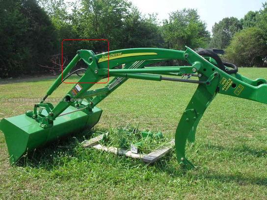

I have a 400CX loader on my tractor.
I see (in pictures) that the newer 400CX loaders have an added link between the booms and dipper arms (where the arms pivot). There is also a strut from that link to the mast. The link I'm asking about is in the red rectangle of the picture.
Is this part of the self leveling bucket, or is it something else altogether?

Yes, that is the star of the self leveling show. As the boom moves, that strut causing the bucket to pivot.

Arlen4720 is correct I have the 400x loader with out the self leveling jd used to have a video of this on their Web site maybe still there

Roy i believe that was always the difference with the 400 loaders... unlike the 300 where
the CX only designated higher/stronger lift.
the 400CX always had the self leveling ,, any chance you have
a 400x mislabeled?

If you aint got that part you aint got a 400CX you have a 400X

I will say though I THINK the self leveling parts and maybe the curl cylinders are the only differences, a dig around JD parts may confirm.
So it possible yours was / is a 400CX that for some reason the self leveling parts were removed or is a 400X that for some reason the masts have the 400CX stickers on them - mystery it is.

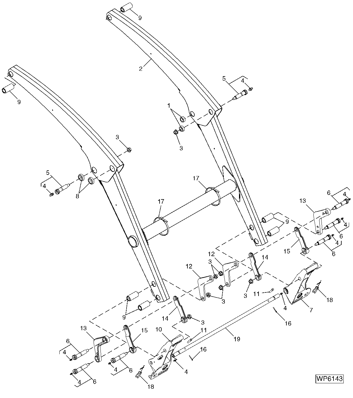

400X:

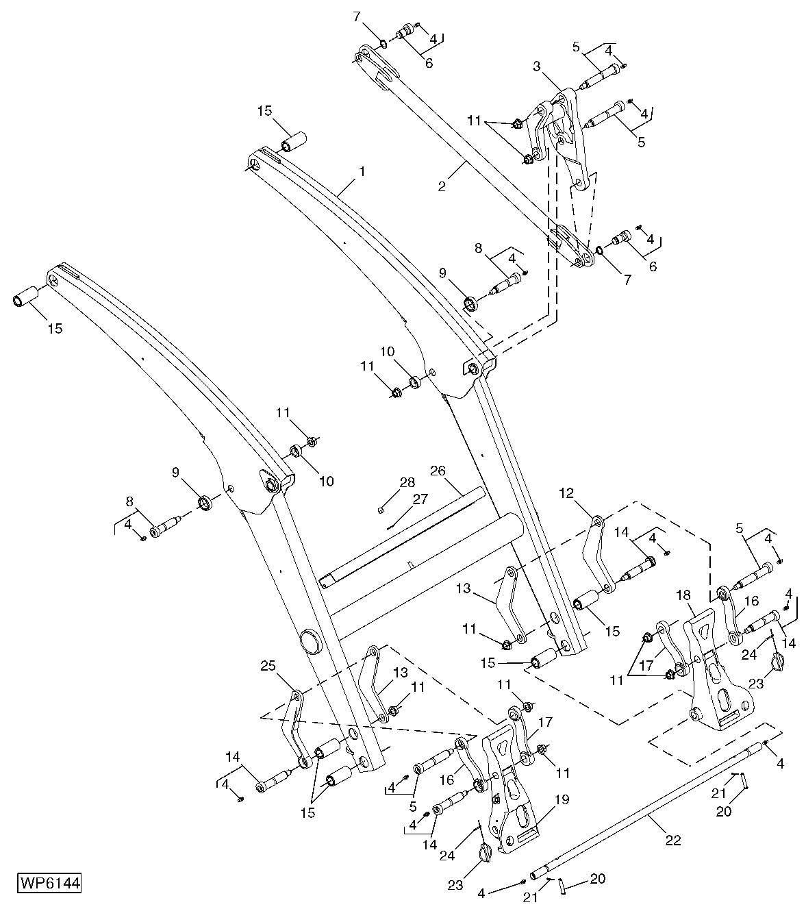

400CX
FYI, there are no serial number breaks listed in JDP for either loader so there is no "old" or "new" 400CX or 400x.

I do have a 400x...made a mistake when I first opened this thread.

What is everyone's opinion of reinforcing those struts, I bent both mine. I am thinking I hit a rock plowing snow and sprung them then when I went to lift up a log they just buckled! I have two new ones ordered for 140 each, dont need to do that again.. Here is my concern though, when I hit the rock I remember thinking dang, surprised I didnt break something. What I am thinking now is JD has those "struts" designed to give, possibly bend before you break something else and by over engineering them I am going to subject myself to a more catastrophic failure... On the other hand I dont need to be picking up a $4,ooo seed tote and have them buckle under the weight spilling seed
