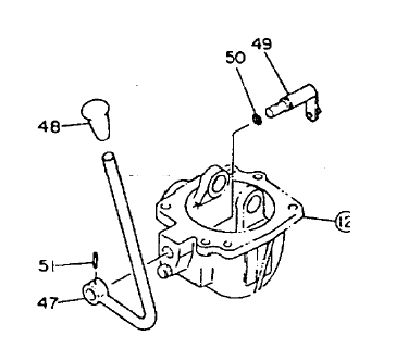

rgood,
Does the 4WD lever have tension on it or does it just 'flop' back and forth? The little tab on part #49 is easily bent or broken and you will lose the ability to shift into 4WD.
Keith
/ 4 WD Broke - 2210 #6
Sorry....forgot pic.
/ 4 WD Broke - 2210
Kzack - The lever feels like it works properly - Thanks for the idea though !
