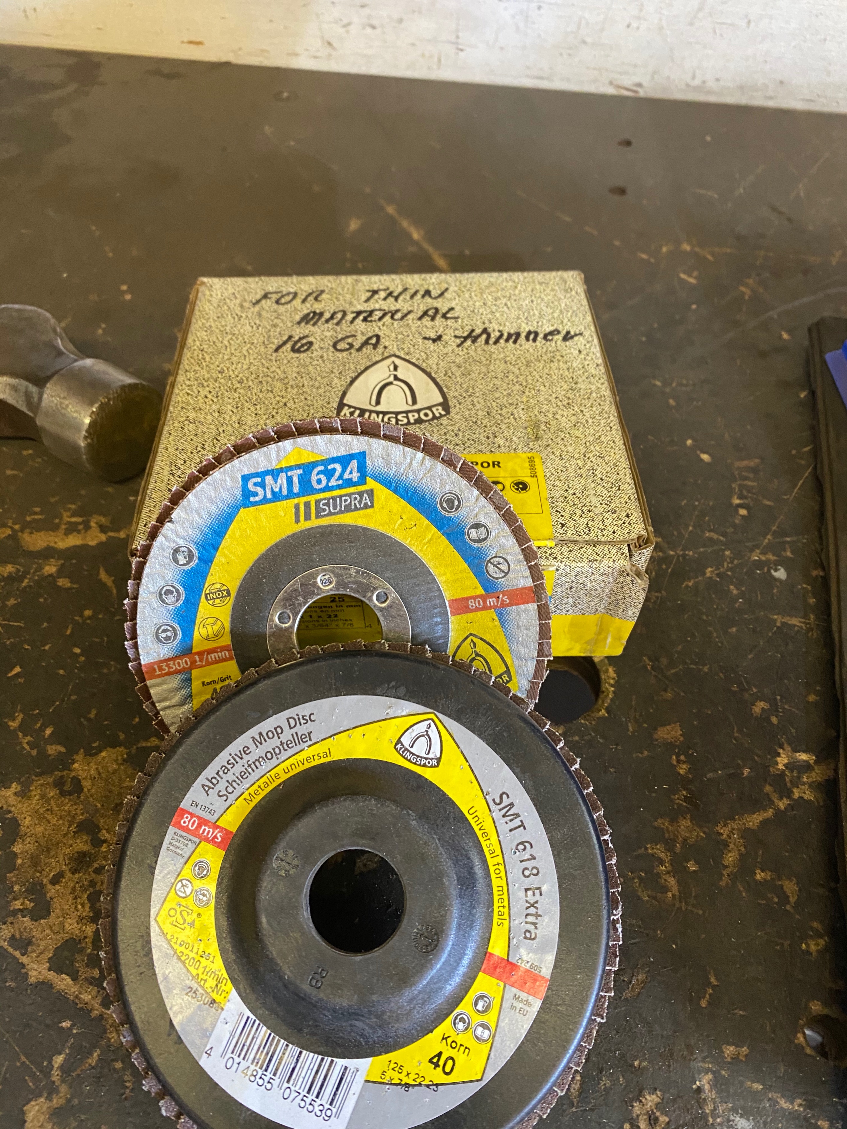

I have had good luck using Klingspoor abrasives for many years as I bought them from a good friend who ran a tool truck. Unfortunately the franchisor screwed him and the the other franchisee over when he didn’t make good on his contract and turned to an online business model.
This is the last of my Klingspoor flapwheels

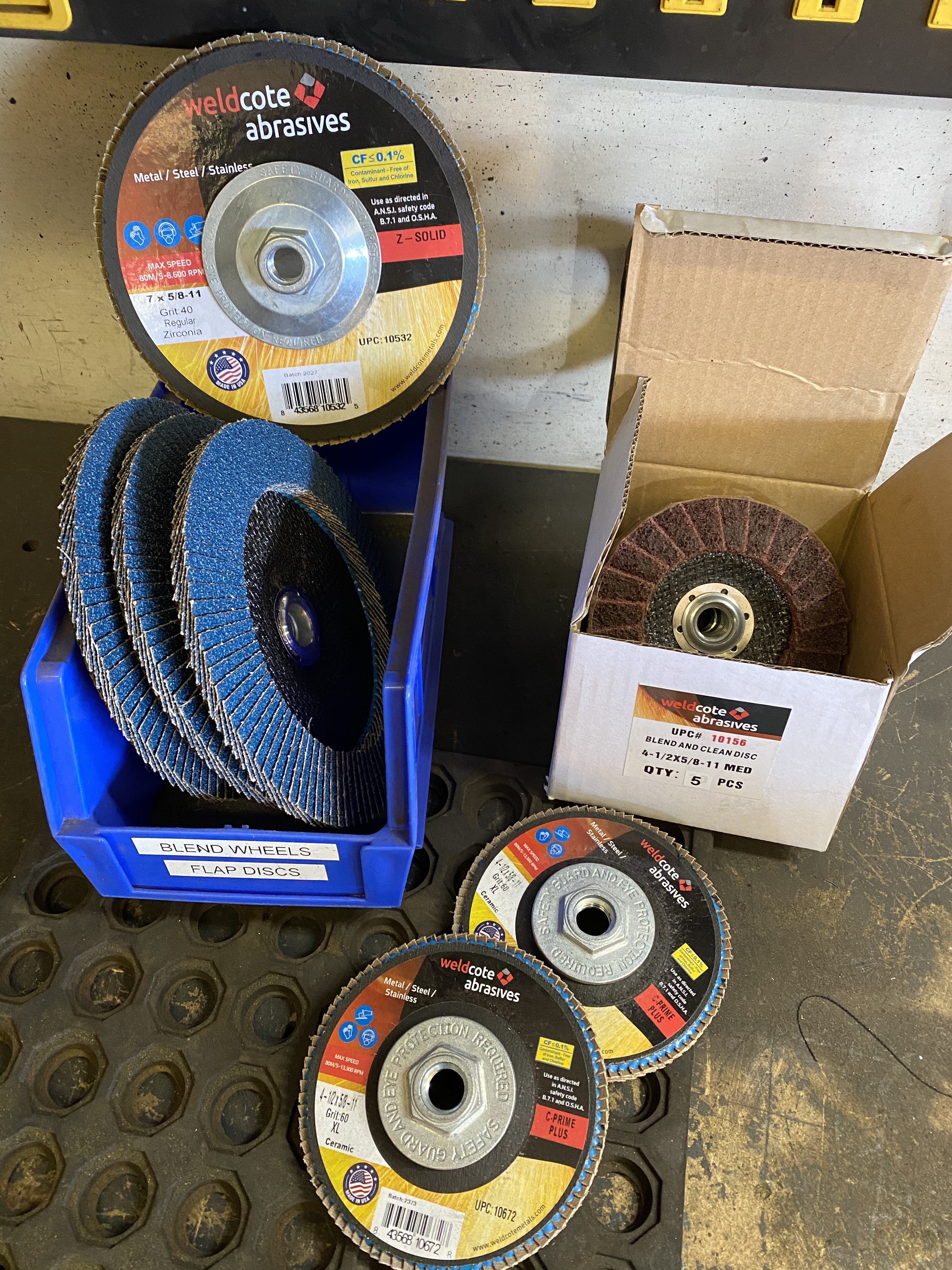

On recommendation from yomax4 I now use Weldcote products which I really like

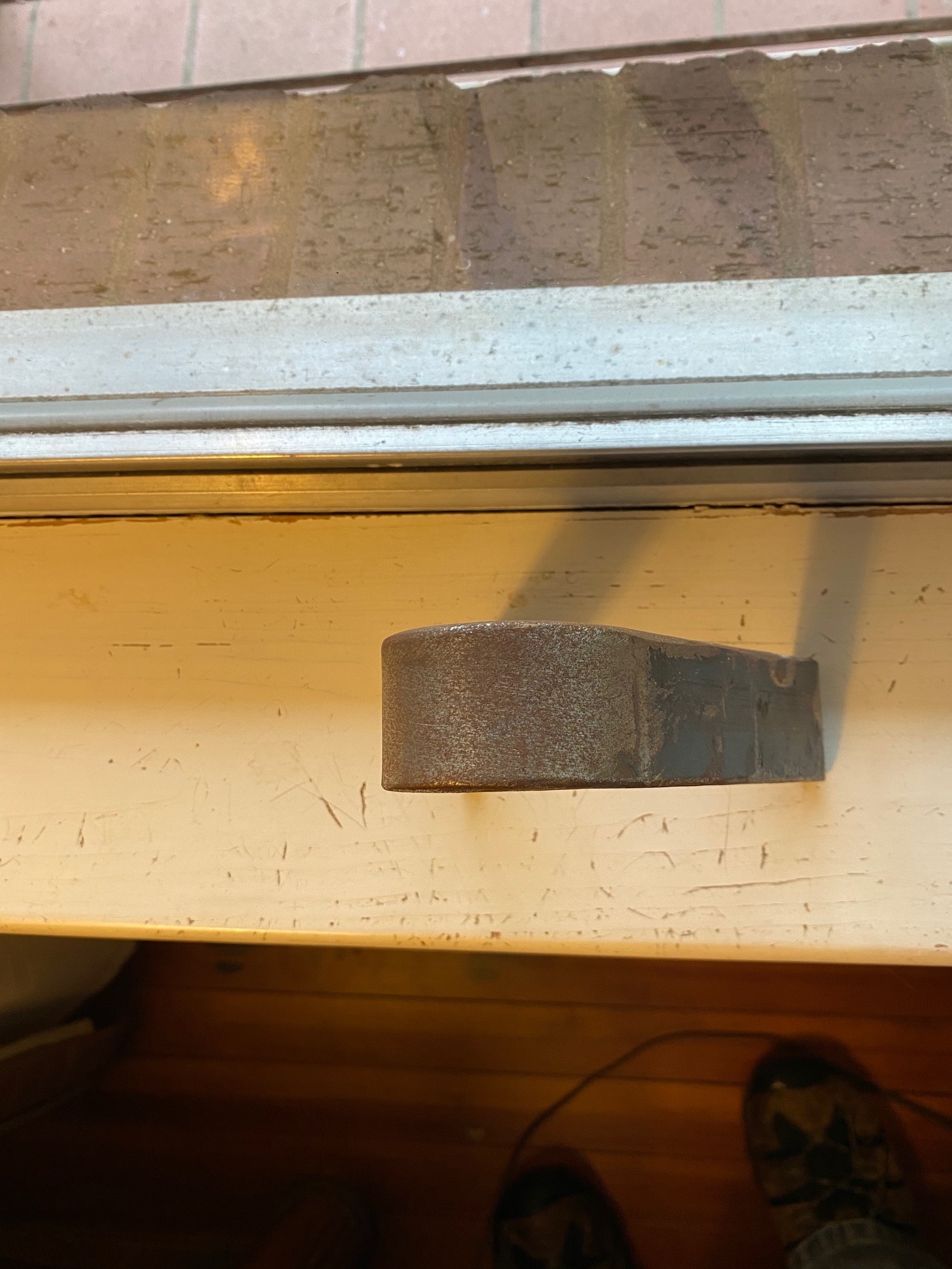

I am looking for the type of flap disc we used in MIG class. I can't remember what it was but we used a grinding wheel then a flap disc and the steel was shinny bright. What grit do you think it was? 80 or 120? This was a test bend I did in MIG class. I guess it has gotten a little rusty now.
I don't see Weldcoat on eBay. What do you think of 3M? I started to use 3M sanding paper in wood work because it last so long. I get it at Sherwin Williams.
I had my own grinder and hard wheel but I borrowed a flap disc for this test from central checkout.
