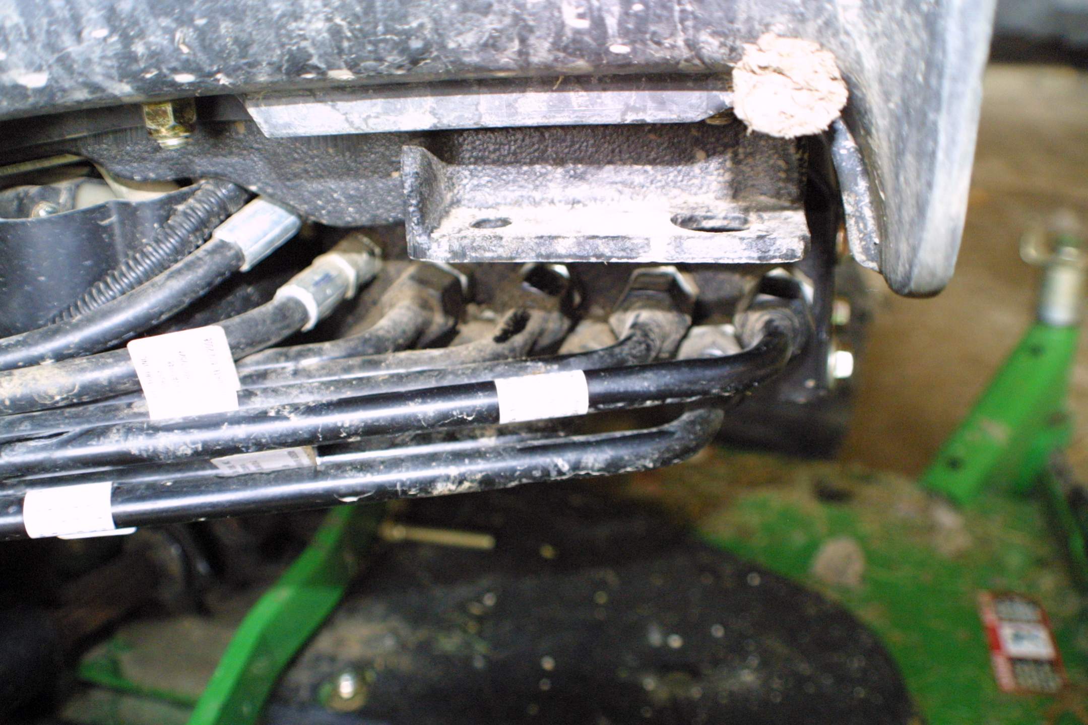

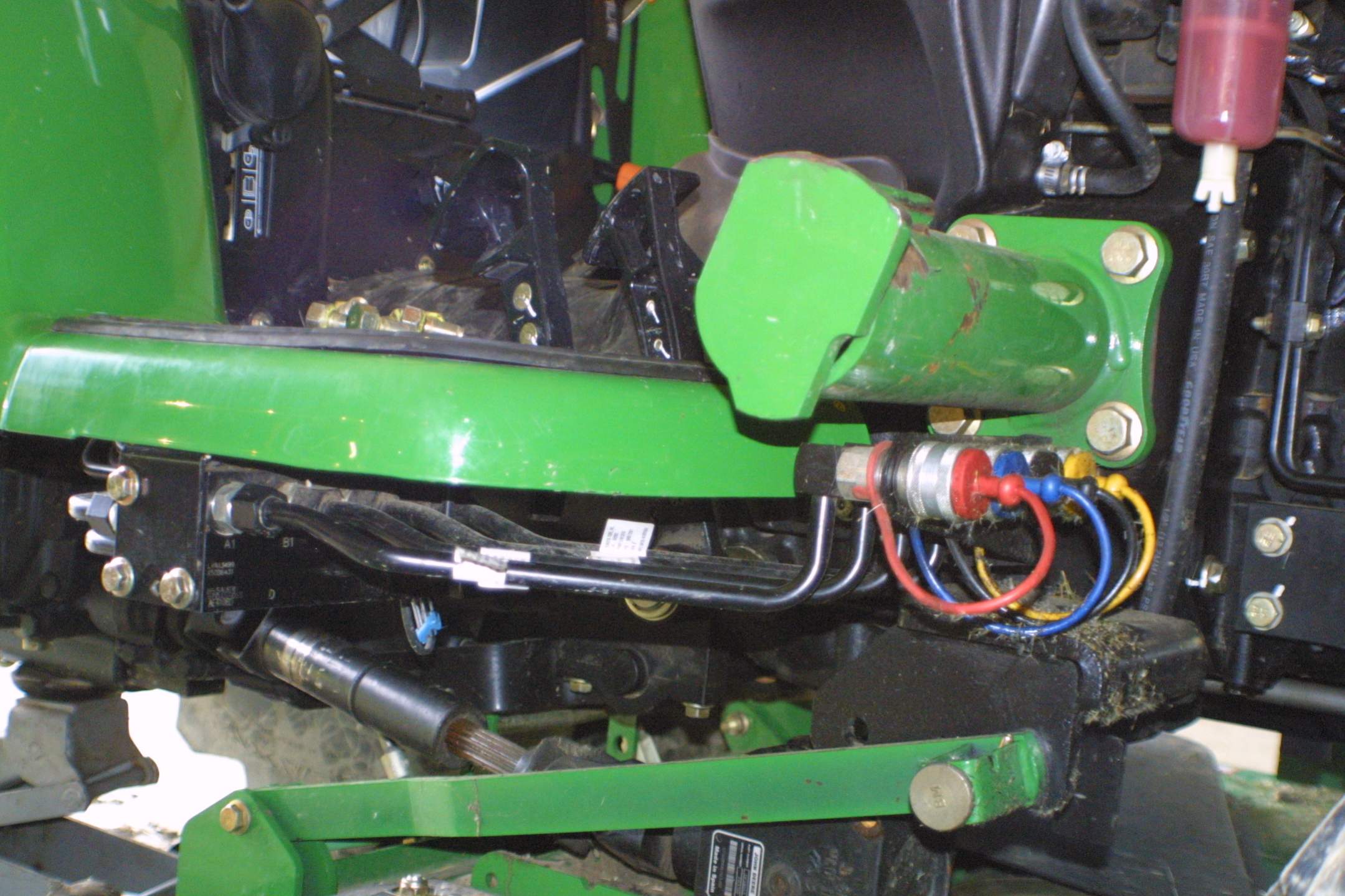

Here are some pictures of the diverter install on my 3320 open station. Wouldn't trade it for the world. Please disregard the mud.

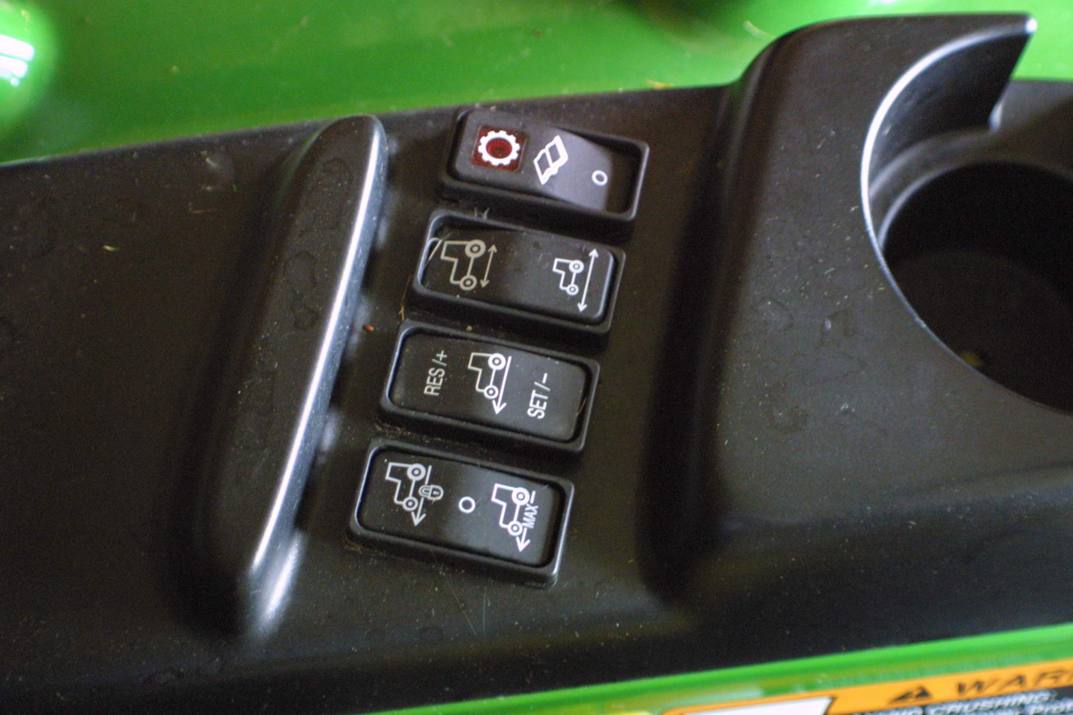

Eric102,
What year is your 3320 and where did they locate the toggle switch for the diverter? My instructions wanted me to mount it right next to my 3rd scv lever. The knock out was actually under the decal for the 3rd scv. I chose to move mine to the fender next to the cruise switches. I have 2007. Just wondering if they changed that on newer versions. I couldn't help but think JD was pretty cheap to save 3ft of wire by not locating it on the fender. The fender and cruise wiring has to be removed for the install anyway.

mdmjrm,
I have a 2008 and it sounds like its in the same place as your knockout, just in front of the rock shaft lever. I would assume they located it there because the other knockouts on the fender are dedicated to other optional switches. I suppose in an ideal world they could have included a wire extension in the kit so you could use the fender location.

An update, I finally got some spare time so installed the diverter kit on my 372. I didn't remove the wheel as per the instructions. With the 6" wheel spacers there was enough room to work and get the kit installed. The trickiest part was installing the lines to the rear of the tractor.
The kit instructions are straight forward and the only issue I had was installing the lines to the rear of the tractor. The instructions said which line part number to install to which fitting but the lines did not have any part numbers on them and the instructions had no pictures saying what each line looked like. Since each line is different it would have made life easier if they had part numbers on them.
