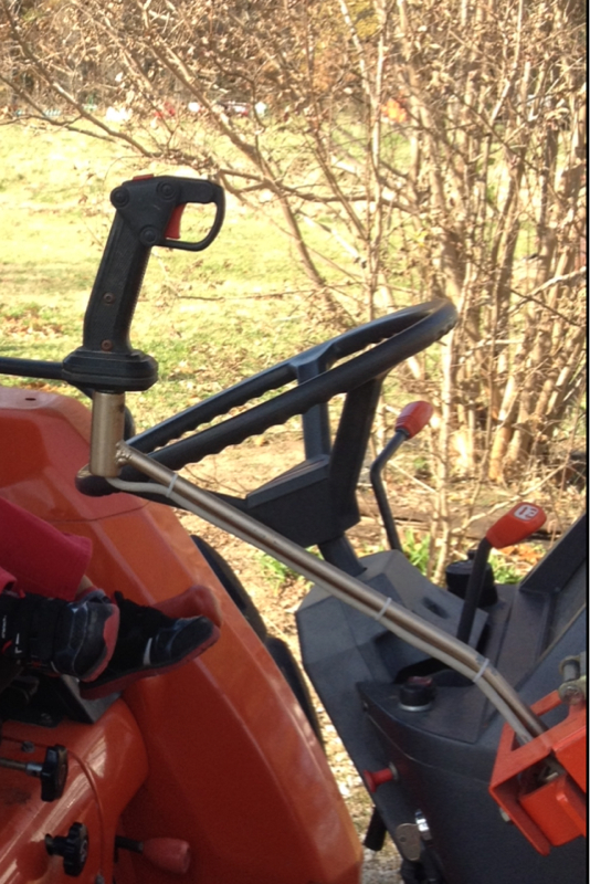

Here is how I mounted mine , it had the round rubber knob like in the video. This way is very comfortable and really easy to operate.

Must be a Cal Smith fan to. Looks like it's welded on, I see a button on top for opening and closing a grapple and a trigger for a grenade launcher, awesome, where 'd you get your 3rd function setup. In this world wide web I found only two easy ordering web sites for a 3rd. function setup, ( Everything Attachments) and ( Idaho Implements).
   / 3rd function valve kit #38
The button on top closed the grapple while the trigger opened it. I bought the pieces and put it all together myself, the handle had a 1/2" shaft about 1 1/2 long that sticks out of the bottom that the cable runs through, so i found a short piece of 1/4" wall tube with a 1/2" I.D. And tapped it for two small set screws. Welded the tube to the loader stick and slid the handle in and tightened set screws.
