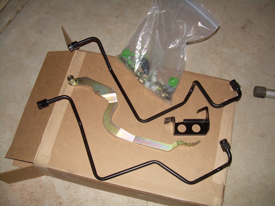

I've got the 4310 which may be the exact thing, I installed 3rd scv on mine, it was inexpensive, not easy to install on mine with the power beyond already in place but not complicated, just a couple of hard lines and a lever.
If the 4300 is the same, the loader's valve already has a 3rd valve built in and you just need to tap off of it with the lines and the lever.
Well worth the effort, cost is minimal compared to what options you get out of it, I also have the HTL and love it, I use it with out exception, every time I operate the tractor.

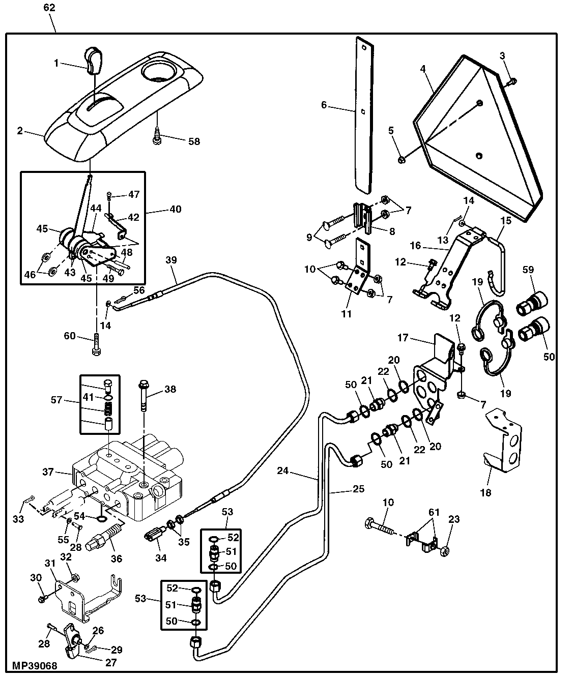

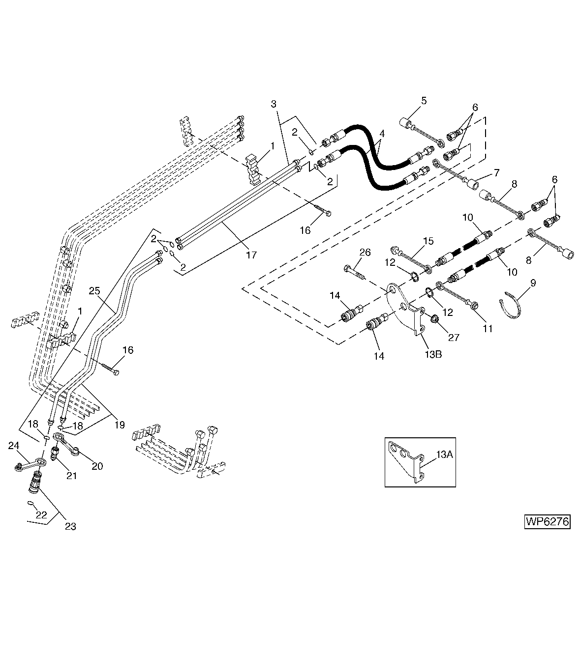

The WR Long is a good kit-it will have everything you need to add independent control at the FEL.
TnT can be hard, but doable. As mentioned, you already have a 3rd valve-just no way to control it until you add the 3rd SCV option from JD that adds the handle on the right fender and all the hardware and hardlines for about $250. JD also has a kit that adds hardlines to the loader, and hoses that run under the tractor and connect to the 3rd SCV QD's (quick disconnects) at the rear. I posted the pictures of the two kits below.

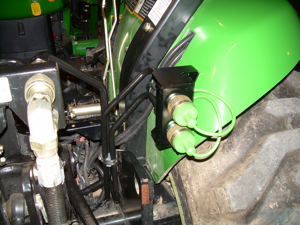

Hope this does not scare you, the 3rd scv is a little pain in the butt, but well worth it.
This is on 4310
JB

JB4310 What you have shown is a bit different from the 3rd SCV for the 4300. Likely due to the ehydro controls in the right fender whereas the 4300 kit mounts the lever for the 3rd SCV.
Difficulty just depends on the interest and mechanical skill of the doer. More for some, less for others. Does require removing the right rear wheel, seat, fender and some work on the control valve. Good directions came with mine. And I enjoyed the task.
I've not found the lever on the fender to be in the way.

Hey Kenny do you know the cost of that set up to extend hard line to loader? Just thinking about a home made grapple down the road.
John
Sorry John, I don't. I seem to recall in the $300 range maybe...

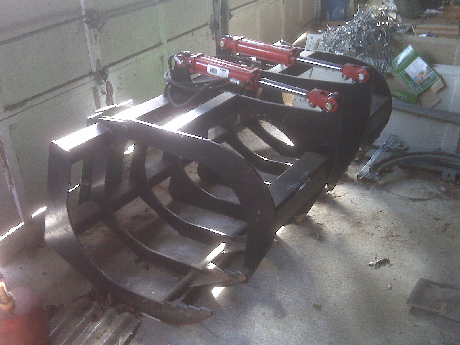

I have the grapple (pic attached). I just am trying to decide the best (not necessarily easiest) way to go about adding 3rd function to control grapple. I also want to add TNT and outlets to rear later so I am not sure if doing the prep and valve work all at once would be easiest or not. Please weigh in here. I like the idea of the W.R. Long kit with the ability to control the grapple without having to remove my hand from the joystick. I am dumb when it comes to the hydraulic set up that is currently in place so anyone who has already accomplished this and can help me learn from their successes/mistakes will be greatly appreciated.
Thanks
frc

That looks VERY heavy...how much does it weigh?

Your information has been very helpful. I am just trying to piece it all together. Not too heavy but I haven't weighed it.
