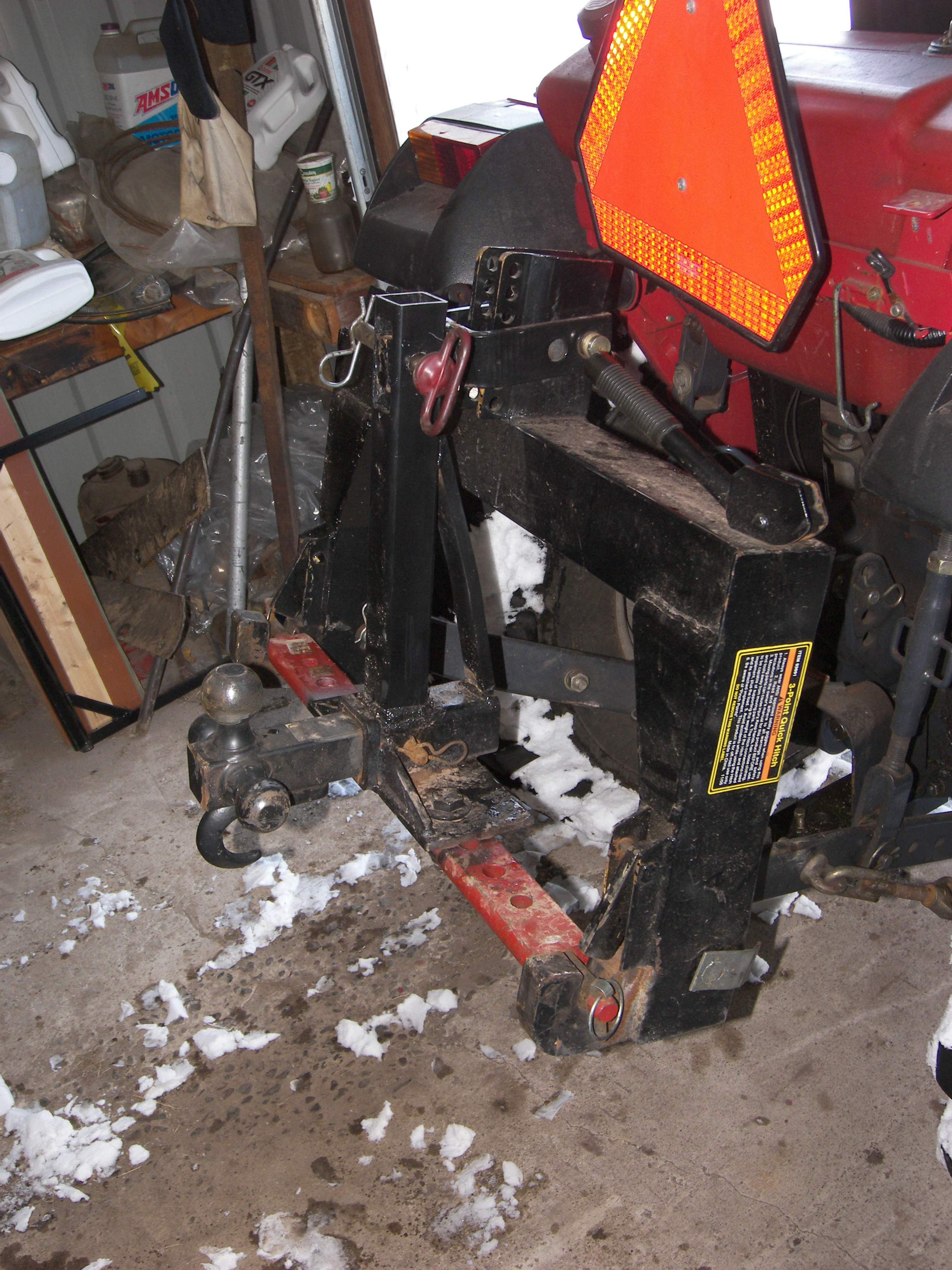

Here's the hitch i made to haul my dump trailer and other flatbeds around with. I run this with my dump and 4 face cord of wood on the road with no problems. works great! Sorry for the bad picture but you can get the idea. I run a safety chain from the hitch to the stationary drawbar hitch so the dump trailer can't raise the 3pt hitch when dumping . . .John
