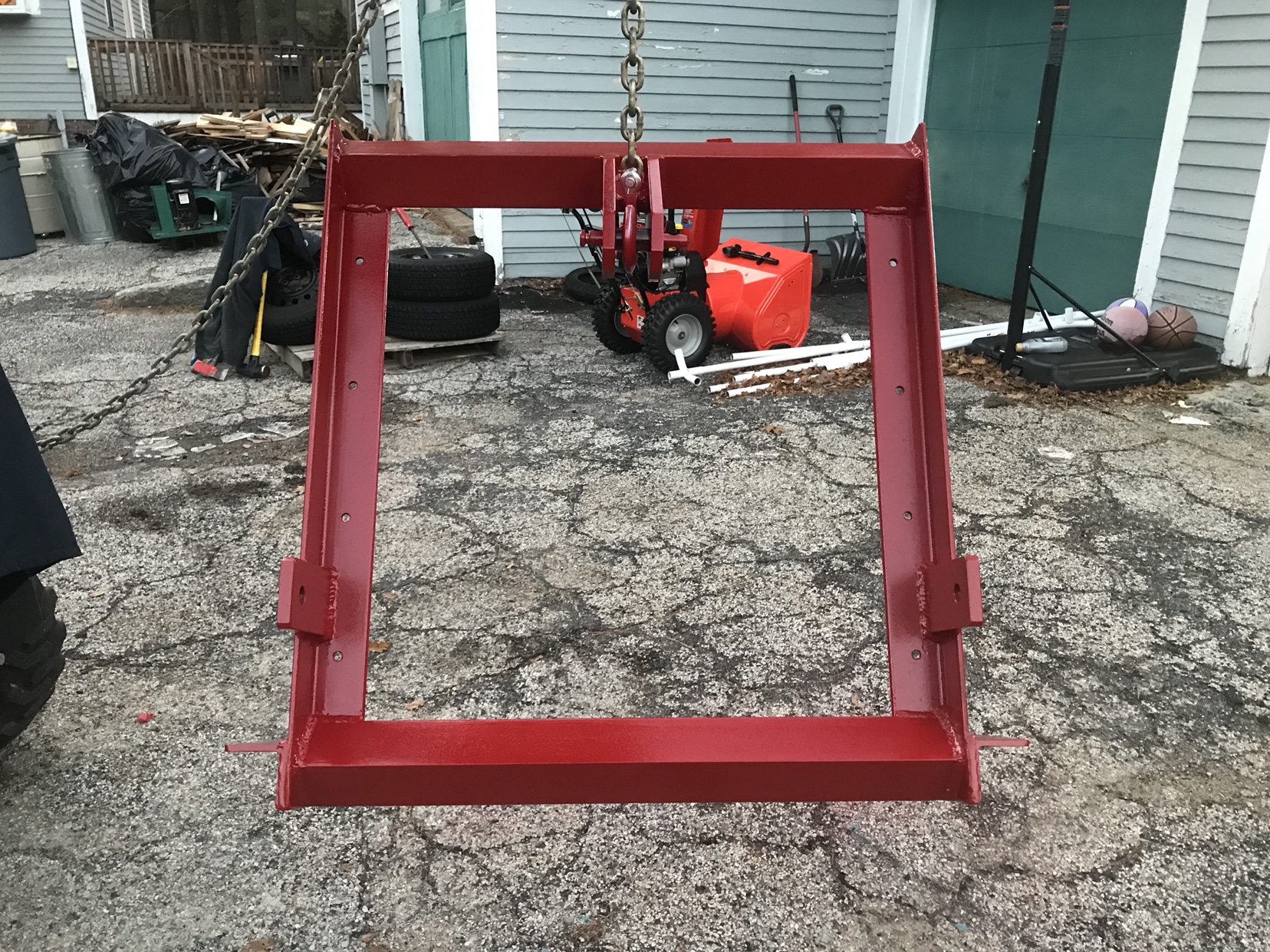

Got my 3pt carry all finished today. Still need to add some storage type attachments but using it as is already.

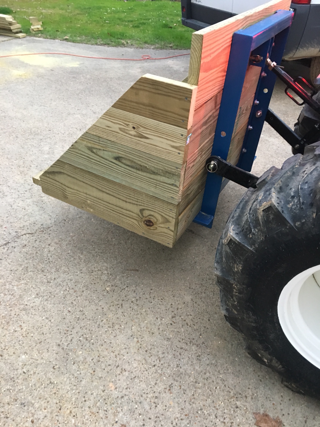

Turned out nice.
I've noticed a few others that cut the sides at an angle instead of running flush vertically.
Is there a reason that I'm missing. It seems like you could haul more if the side boards were all extended flush.

I hope the angle will make it easier to reach over the sides

I owe MMfrompa for the design. Got the dims from his YouTube channel. I have decided that there are 100’s of ways to customize these things

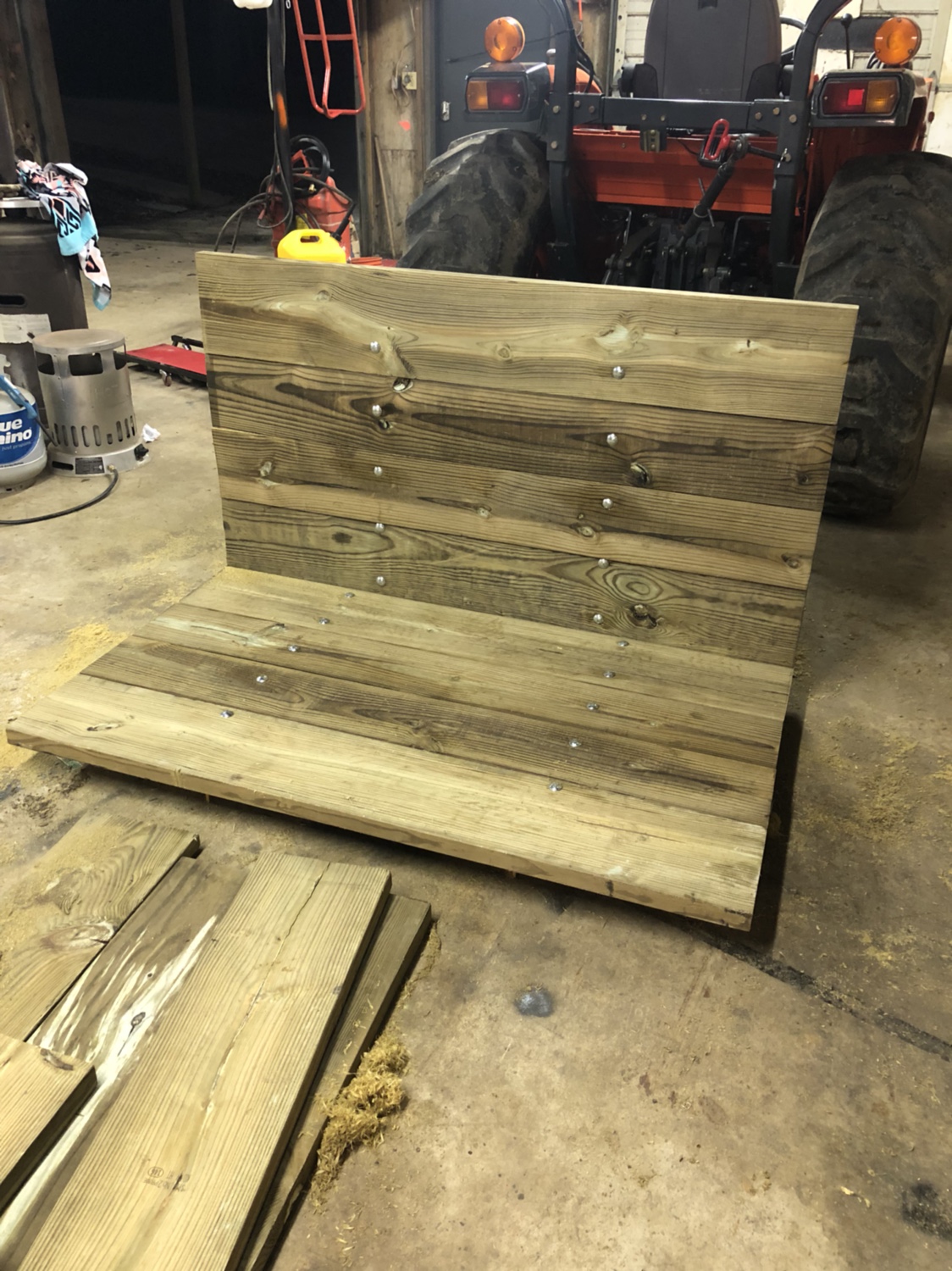

I made my own and just copied a picture I saw on TSC web site.
What thickness did you use for steel?

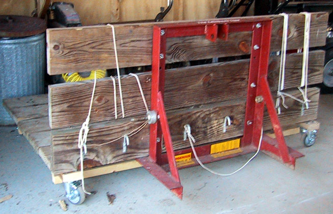

I built mine with no sides at all. Makes it easy to carry long stuff. I mounted hooks on the front of the headboard and under the rear deck and keep a length of small nylon rope which works great for tying down loads of firewood, which I stack crosswise in two or three rows. Hooks visible front and rear here:

I bought the Countyline carry all from TSC. Added PT lumber on it and painted to match LS tractor

Just did mine this last week. Still haven’t decided on how I am gonna do my sides. IMG_1266.JPG
Ahh okay. Do you have a guess what they used?
I made mine from 5/16 3x3 angle iron with 5/8th thick mounting points.
