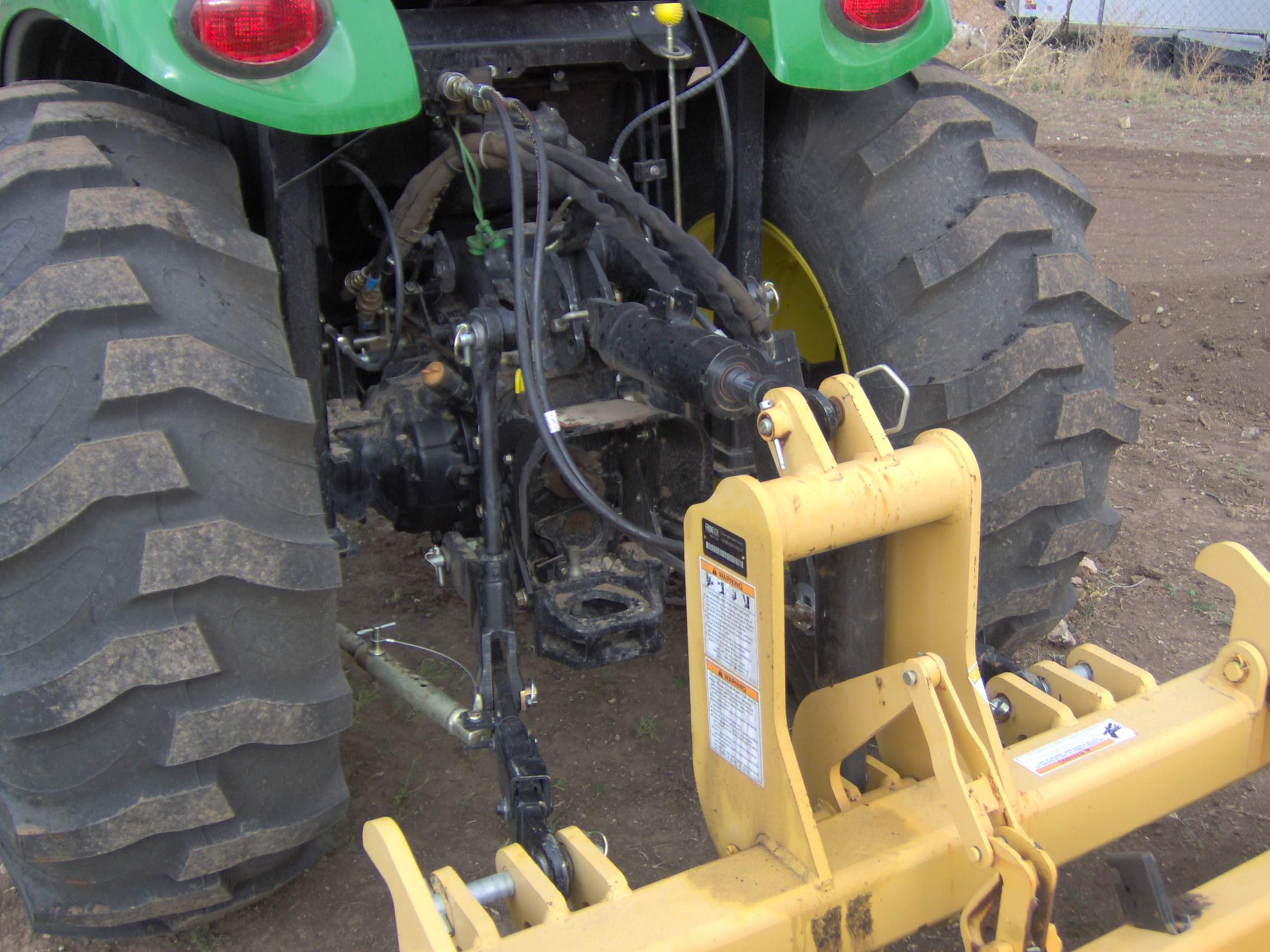

Eric,
If you want the geometry to work I recommend you go with 18" vertical spacing. Here are some pics of both factory made and home made implements. Most factory built implements today offer the 18" spacing and the 15" for the quick hitch. Notice that the quick hitch connects to the tractor side using the 18" spacing, that keeps the geometry the same as other implements that are not using a quick hitch.
