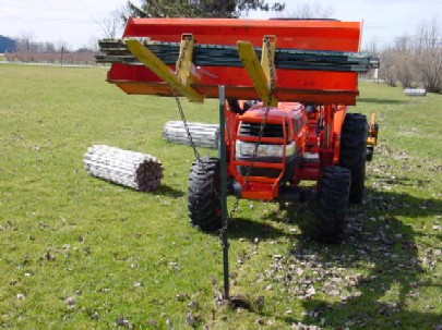

The homegrown version....
Very handy when PULLING A PLOW!!!!!

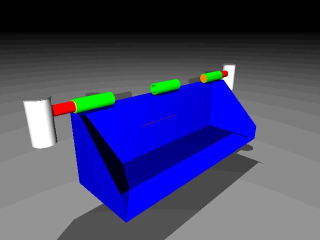

I was pulling T-posts out today giving this some thought. I don't have anything specifically designed to pull them, I just make a couple loops out of the middle of the chain, drop them over the post, walk back to the joystick and raise the bucket. I was operating the joystick with my left hand and got a little choppy one time lowering the post back to the ground so I could shake the chain off. The post swung under the bucket and I ended up shoving it right back into the ground (different hole) slicker than you know what. Because it took no effort at all, in my ground anyway, I wondered why the post driver had to be in the middle of the bucket, so this is what I came up with.
Bear with me, I don't have all the software loaded for my copier, so can't scan a drawing.
How about a bracket or two welded to the top of the bucket towards one side. My bota has about a 4" lip on the bucket that would work for this. To these brackets you would weld a pipe running parallel with the top edge of the bucket, side to side, maybe a foot long. This pipe would accept a slightly smaller diameter pipe or a solid steel rod. We'll call this pipe rod B. Rod B would be doing the work, so I was thinking maybe 2" diameter.
Let's say rod B is 18" long, so it slides into the pipe welded on top of the bucket and overhangs the side of the bucket. To the underside of rod B is welded a pipe to accept the T-post. You could even use the hand T-post driver. Because rod B swivels inside the other pipe, this "receiver" would always hang plumb, perpendicular to the ground.
You stick the T-post into this receiver, maybe use a bungee on one of those **** to hold it up in there, and the T-post should hang nice and plumb and be ready for you to lower the bucket and push it into the ground.
If anyone follows that build one and let me know if it works /forums/images/graemlins/grin.gif

Here's a rough picture to see if I got your description.
The blue box is your FEL.
Green is your unnamed pipe.
Red is rod B.
White is the receiver.
Should work...

Hey, that's pretty cool /forums/images/graemlins/cool.gif
Obviously the blue box could be any kind of bracket. I'm sure you knew that. I was thinking of a couple short pieces of 1/4" plate. There is a small lip on the side of my bucket I need to get over.
The white receiver for the T-posts... I was going to weld it on the bottom (so to speak) of the red pipe or steel rod to keep the whole unit swinging below this pivot point. I see no reason why welding the the red rod (rod B) to the wall of the post receiver, as you have drawn, wouldn't work either.
I also thought, if you had the ability to drill or burn some nice holes... you could make the brackets taller, heftier, and use them in place of the pipe (green was it?), that houses the pivoting rod. When the post driver is removed you would have a couple attachment points for a chain.
Put one on either side of your bucket and you add a couple other options. If you drive your tractor perfectly perpendicular to your fence line, you could space two posts a bucket's width apart without moving, or toss a couple shovel, rake... handles into these brackets /forums/images/graemlins/smile.gif

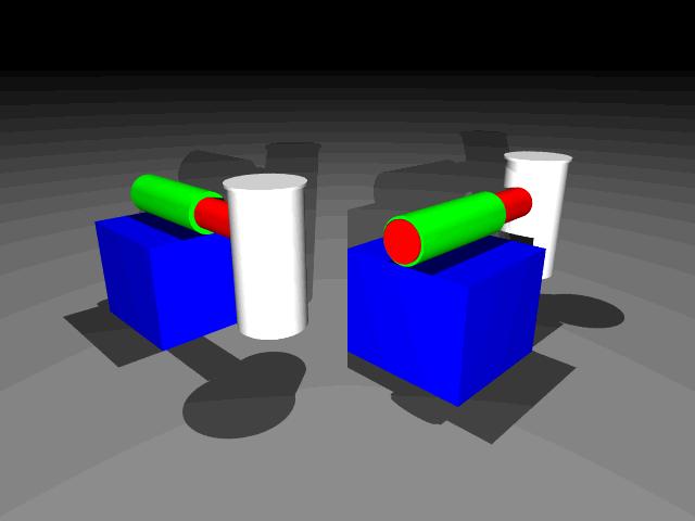

Hi Freds,
My thinking:
Weld the green pipe directly to the top of the bucket (or spaced to cover the lip you mentioned) for maximum strength.
The white receiver is positioned so that it will hang open-end-down when there's no pressure on it. Once it's pushing the T-post, the pressure is on the top cap which is above the pivot point. This keeps it from trying to rock off the post which would happen if it was welded to the bottom of the red pipe.
I would stick to using pipe to house the pivot rod as it's simple and would allow for a grease nipple.
Definitely put one on each side of the FEL.

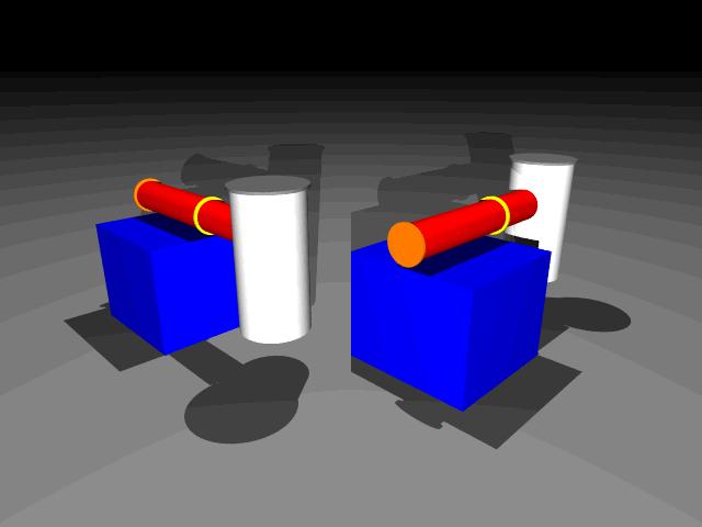

I've attached another image with the green pipe missing and the end caps re-colored. You can see the orange cap on the red pivot rod. This cap could be attached a bolt in the center to allow for easy removal.
I've also added a ring (yellow) to positively locate the pivot rod in the pipe bracket.

I may have had too much coffee...
Just had another thought. If you weld a bracket (green pipe) at each end of the FEL and line them up carefully, then you have the base for even more attachments. Think about options if you slide a solid (hardened) steel bar all the way through both brackets. Hhhmmm... Fork mounts... Grapple mounts... Better add a third bracket in the middle before we bend something.

I was going to have a cap on the white receiver to prevent post slippage. I had even mentioned using a hand T-post driver, if you have one already like I do. After all, once you get one of these bad boys made up, who would use the hand operated model? /forums/images/graemlins/grin.gif
I just like everything hanging below the pivot rod. Don't ask me why... less stress on the receiver wall, all the weight is below the pivot rod, the rod adds strength to do the pushing with....
I'm sure both designs would work, but it's how I will make mine.
Definitely one on each side. W/O caps though. I think having the pipe always at the ready to slide a shovel handle or something into would be handy without having to remove a cap, but it's a nice touch.
Also, maybe a small eye bolt or two welded to the white receiver. One could be used to fasten or hold the T-post into place (I'm hoping a bungee hook can get enough bite on those **** that are on T-posts, but the hook could be modified). This would also keep the posts all facing the same direction, saying your tractor could always face the same direction.... And one to have a length of dog chain or similar hanging from to let you know when your posts are at the correct depth when it touches the ground.

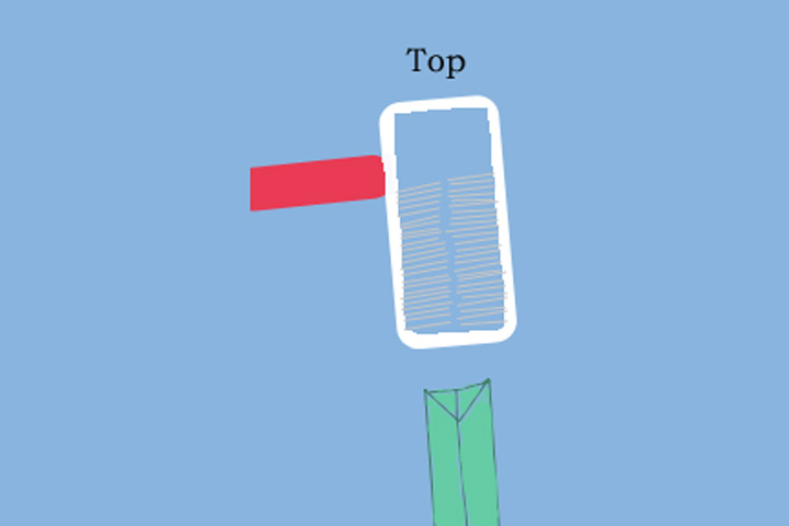

Hello! Guys
Hope no one minds me bumping up this old thread but I really like this
T-Post driver idea but I wouldn't like the idea of getting off the tractor
to settup every single t-post so what if you ran lots of heavy wires in to the reciever, like the kind on a large Brushwheel and used it to hold onto the t-post (grapple like).Then you could pick them up from a upright postion and move them without ever leaving the tractor except when you first unloaded them from the rear bucket. Do ya'll thing it might work ??? :)
Really bad pic below.
