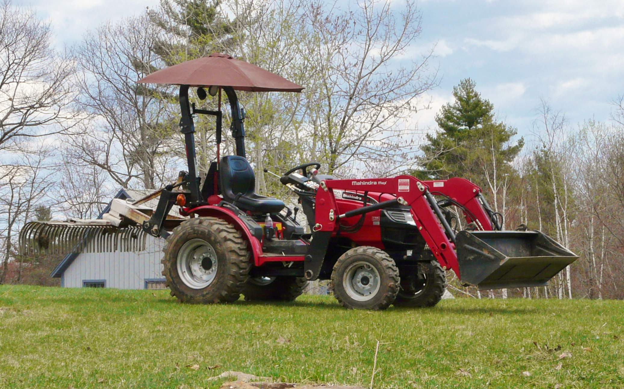

I have the Pats weld on hitch on my dads and mine. Made rigid stay bars in place of the turn buckles. Had to put some flat washers behind a few of the pins on the equipment to get them all the same width. Works great

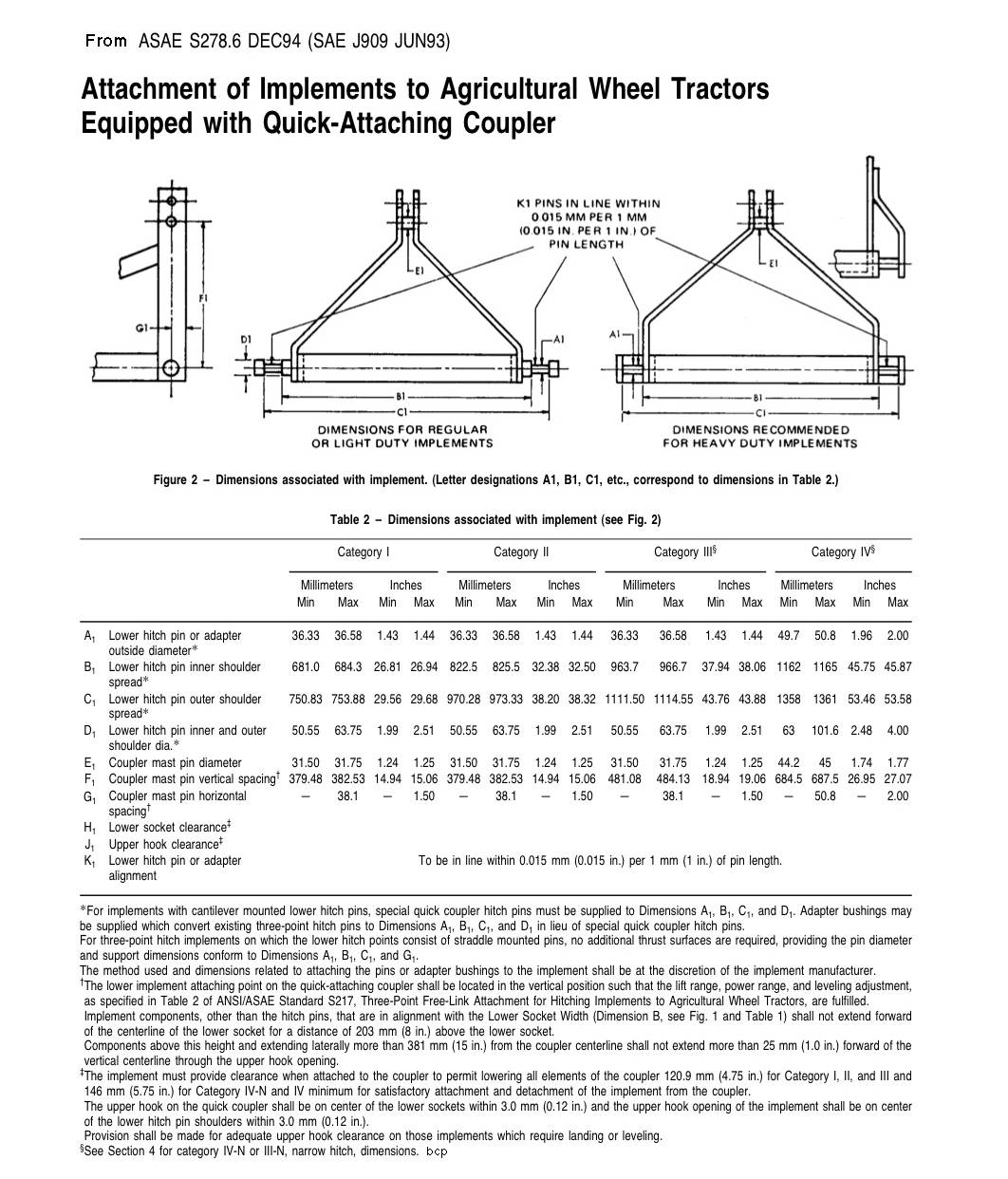

According to ASAE, Cat 1 lower hitch points should be just a hair under 27" on the inside and just a hair over 29.5" on the outside.
I plan on buying one within the next couple weeks and have found different widths on some. Measure twice as to what will fit your stuff or what can be easily modified.
Someone from here gave me this handy reference page:

looks like good info...do u have it in higher resolution? some of it is hard to read.
I will probably look into this for a few more days but maybe Pat's with the spacer bar will be the easiest given the different widths..

Here is the quick hitch I used with my BX. Price is higher than what I paid, which was well under $100 (on ebay IIRC). Similar to Pat's but it doesn't move the mount points back further which was important to me since I already had my chipper PTO shaft cut down to the right size. These move the lower mounts up a few inches. These, plus Mark Hodges telescoping stabilizers make hook up a breeze. Mark's stabilizers can be set at about any spread to match varying implement widths. Set the stabilizers to the correct width, back up and raise the 3PH to hook the implement lower pins, then connect the top link. Good luck whatever you decide.
