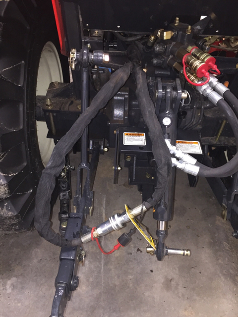

I have a Branson 3520H with a BH76 backhoe that feeds off the tractor hydraulics.
Problem is when I remove the BH for storage, the hoses on the tractor has to be hooked up to maintain the loop BUT it is quite long and gets in the way when I use other implements and it steals the top link holder to hold the hose up out of the way. I would LOVE to rework the hoses into a stationary two outlet coupler with a bypass valve that loops the flow back into the tractor and when using the BH, the valve gets turned to allow flow to the BH. Is there any valve setup that does this?

You could rearrange the way the hoses connect. Pics from your current setup would help us understand how it is now.
One possible way is to leave the long section of hose on the hoe, by cutting and refitting the section that is currently coming from the tractor to supply the hoe, then installing a new fitting where you make the cut, to allow for the 'return line' of fluid to the hydraulics of the tractor to be shorter. Then the cut section gets attached to the hoe so when using it, you plug it into whatever fitting you have attached at the supply from the tractor. I did this with my FEL hoses that supply my plow and grapple, tree shear, etc.
The new fittings are a compression type that screw into the inner hose liner, (reverse thread) and the 'nut' tightens over the outside of the hyd hose. I have no leaks from this shortening of the hoses. You must keep the fittings and hoses, inside and out free of dirt/debris, and when done right they are not noticeable as different from the crimped on ones from the factory. Readily available, and you could probably buy a bracket so you'd have the hoses mounted neatly in the rear of the tractor, and then just plug and go as needed- depending on your current config, and what needs changing.

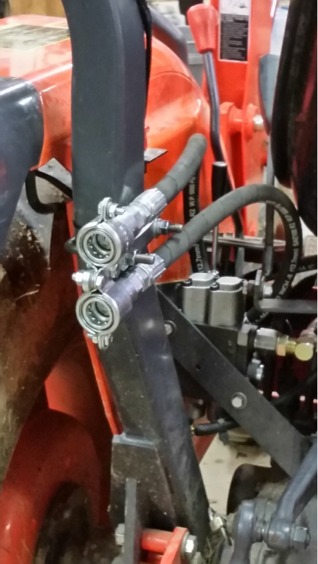

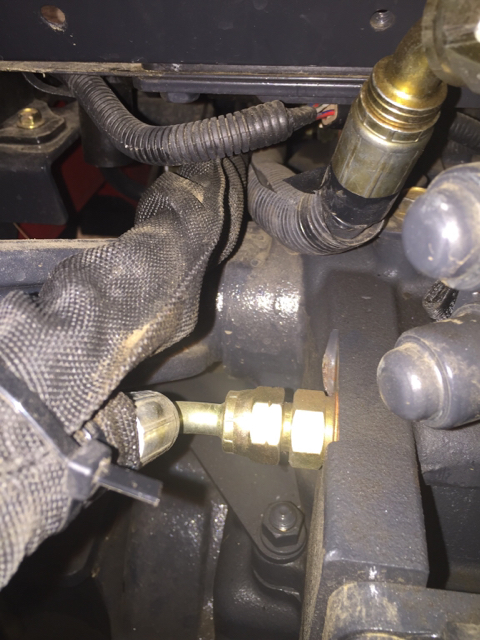

Here are the images. In the second image, you can see the two hoses wire tied together which I'm referring to. I'd like to avoid looping the hose and your suggestion still does this. If there isn't any type of bypass, I may cobble some fittings with a ball valve to tidy up the rear and gives me two fixed coupler points.

Ok the pics helped a lot, I was thinking that you had two quick connects mounted on the tractor and the hoses were left with the back hoe. I would probably look at doing some thing along the lines of what coyote machine is saying, shorten the two hoses by instilling new ends with quick connects on the rear of the tractor and then a short jumper hose or a u shape fitting with quick connects to jumper the circuit on the tractor with the long hoses attached to the hoe. I'll see if I can dig up some pics someplace.
Remember I was shooting blind before the pics. :cool: I still think you could avoid valves/shutoffs by just cutting/rearranging the hoses and a couple of new QDs and possibly bracket to hold them, similar to how your factory valve is now.

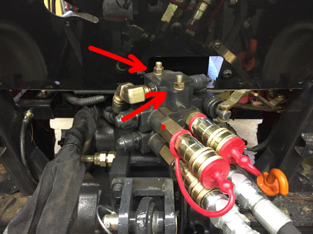

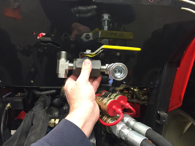

I went to a "hose" store where they also have fittings, etc. got a few items and after looking over the tractor, I believe I have an excellent plan which would make the install look factory sharp. So good that I just might offer it as a bolt-in retrofit kit for 3520 owners w/ backhoes.
The ball valve fitting has no attachment points but I plan to weld mounting nuts on the bottom side and secure it on a fabricated bracket using the existing hardware from the top of the remote stack as seen in this top picture.
I'll get started on this in a week & post updates.

That will sure beat what you have now - one more suggestion you may already plan on - if your fittings to the hoe are one male, one female (opposite on the hoses of course) then when the hoe is off you can couple its hoses together to keep all the dirt/bugs out.
Then just a matched pair of QD caps on the tractor side, ball valve open and you're good to go... Steve

With your proposed setup what happens if you forget to manually move the ball valve to the open position when the hoe is off the tractor?

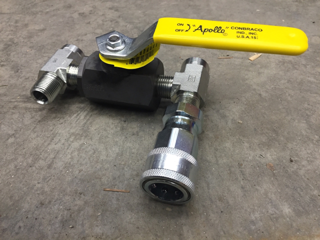

Looks like a good plan, but I am concerned about the NPT fittings. They are hard to get tight and pointed the way they need to be.
The "hose" store should have sold you O-Ring Boss (ORB) fittings that you put in position and snug the nut down on the o ring till it doesn't leak. SAE Straight Thread O-Ring (ORB) Hydraulic Fittings

You know what, you're absolutely correct. I'm going to take a few steps back and try to locate an ORB ball valve. I think I found one from Ball Valve, 3/4" ORB and I'm waiting for them to supply more info & pricing. I'm hoping this one has the means to mount it too!
I know I could have gotten adapters but that would just clutter up the rear so I'd thought I'd try to do it right as if I'm engineering the setup at the Branson factory.

Got the info and it looks that this ORB ball valve I mentioned will work well. It has means to bolt it to a mounting plate and thanks to Xfaxman, the correct valve is on the way to me! The minor downside is the company is from Canada and shipping & tariff amounts to about $30 for a $48 dollar part. Not too bad since the original valve is about $58 bucks. Had I stuck with the original valve, I'd have to buy adapters and it would make the assembly wider, cluttered, and I'd still have to fabricate a unique way to mount it. In all, I came out ahead!
