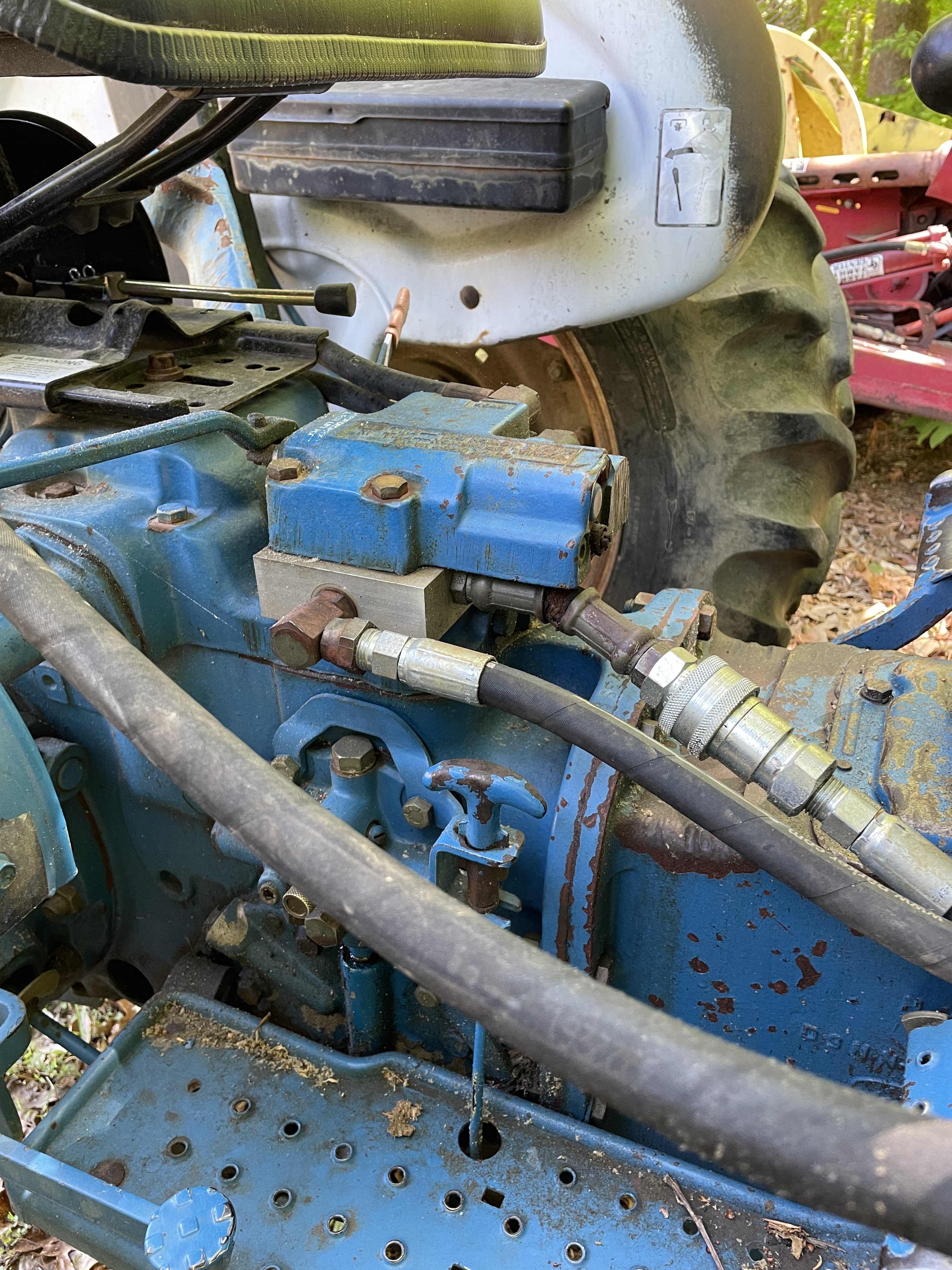

I'm doing some research/planning for this 3910 I've just bought, before I tear it down to fix leaks, clutch etc. The pump I have is in the rear casing, below flow valve. I presume this is the 7.7gpm pump? Tractor Data says there is an optional 12.8gpm pump which I presume is the one that mounts on the left of engine? These engine mount ones are available for around $340 but ... how do they work? Do they work in tandem with the rear pump or are they used independently for a loader etc? How are they plumbed in? I have scoured the internet looking for info but no mention of it anywhere. There's videos on youtube about both types of pumps but nothing about retrofitting one. Anyone with any knowledge of this here? Any info or links greatly appreciated.

If anyone has the tandem pump on their tractor, could you post a photo of where the lines go to? I have a feeling, from what I've read, that the pressure line has to go to the deluxe rear remotes valve block behind the seat rather than the standard, under seat, priority valve. Is this so? If that the case, the project is dead in the water.

The line from the front pump goes to the priority/unload valve as this is the way the system combines the flow for the deluxe remotes.

I don't have the 'deluxe' remotes, just a set coming from this valve. Am I just chasing my tail or is there a way to combine a front pump?

A adapter plate added is interesting to attach the lines! My old Ford They left the 3Pt. factory Intact. But ran a Aux. pump off the Motors Crankshaft pully. Easy to setup. My reservoir is in the FEL. also. 6 nuts and bolts to Remove the FEL. or attach it. Org. they used it for a Hay. Bolted a spike to the bucket.
