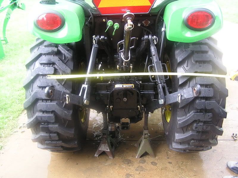

Go with the R1 tires and wheels. That way you can turn the wheels out to a wider postion to give you the stability you want and need. With the R4 tires and wheels you can't get as wide. I have R4's on my 3520 cab and no way could I ever get around my place with the R4 rear wheel stance. I ended up adding unverferth 4 inch extensions giving me another 8 inches width in the rear. It makes a difference but, I still can't take the 3520 in places I took my old JD870.

I'm not talking tires, I'm talking the rear wheel stance. You just can't get enough rear wheel width with the R4 wheels unless you go with some sort of wheel extension. The R1 wheels have the ability to adjust to several different widths. So, the R1 wheels are the way to go if you need extra stability.
Below pics: 3520 with R4 wheels and tires.
Before I added 8 inches to the rear wheel stance.
After I added 8 inches to the rear wheel stance.
There is NO WAY! I could have used the 3520 on my place with the factory wheel width.
Sincerely, Dirt
