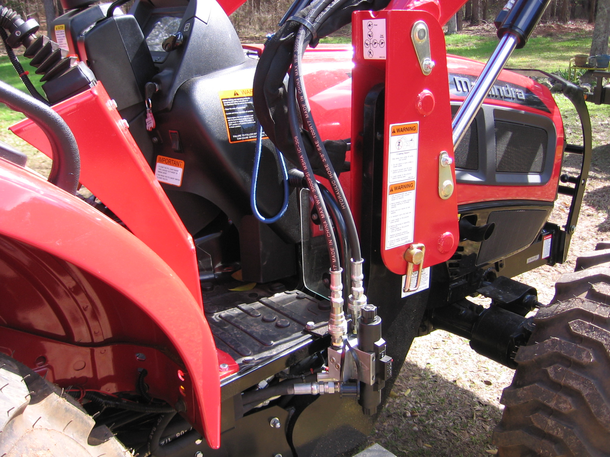

I have a 3540 that hasn't got 15 hrs on it yet and so far I have fixed a pain in the butt to get to oil leak,upper radiator hose coolant leak,re engineered the bolt setup on the backhoe frame so I could actually use the lift arms after removing the bh.When the dealer installed the bh frame they put some bolts in backwards making it impossible to pin up the lower lift arm balls.The low beam headlights stayed on all the time so the dealer drop shipped a new light switch to me and I installed it to get that fixed.On the plus side I have hooked it to a heavy duty 7ft box blade with a hydraulic top link that I rigged up and graded our 700ft rock driveway,moved a bunch a dirt,dug up a couple of stumps before I took the bh off,moved my trailers around with a new ball hitch I made for the bucket,installed a WR Long third function valve and a sun guard top complete with stereo system.With 14 hrs and a half tank of fuel burned this is where Im at with mine and I really like it.The way it looks,the weight,lift capacity and easy operation appeal to me so Im gonna keep mine and keep working on it for sure. :thumbsup:
