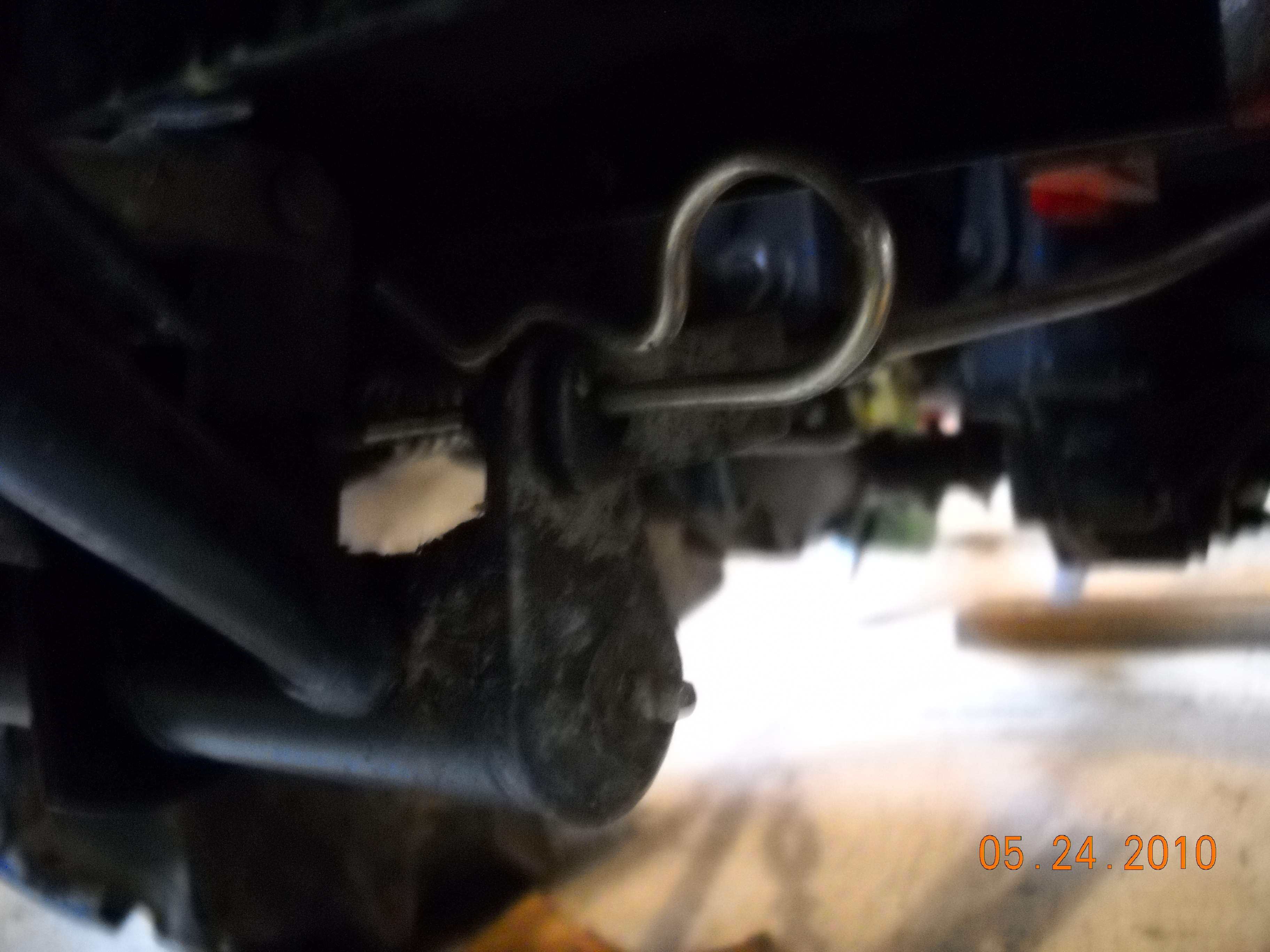

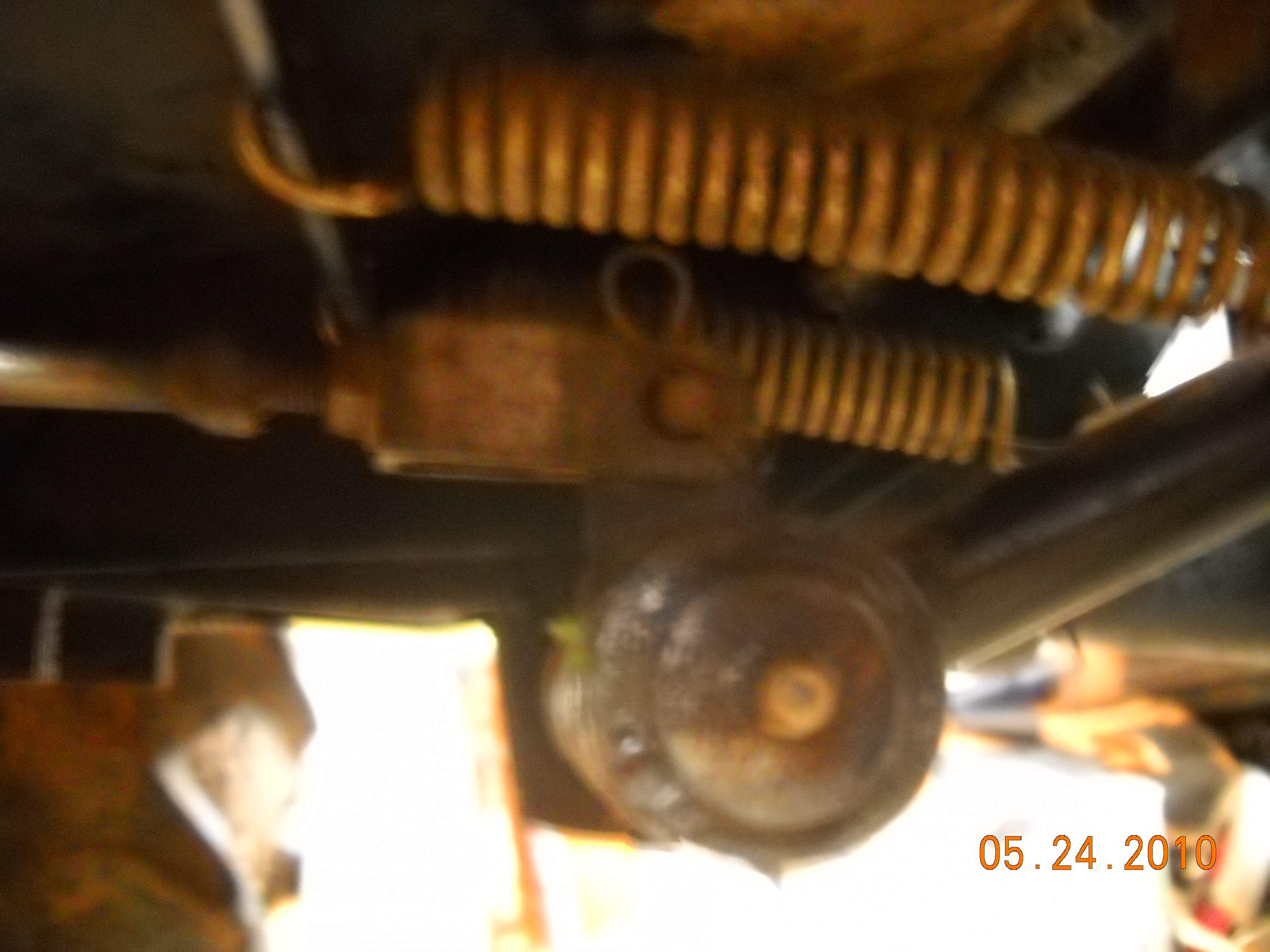

Easy fixes are very nice to have. With my Yanmar I noticed that the left brake was no longer working and my left brake pedal had a lot of play in it. I took a look under my tractor and found out that a small pin had come out and the brake pedal was no longer attached to the brake lever underneath. So I took a large cotter pin, stuck it in there, has worked ever since. I know i need to get a new pin but the cotter pin has sure worked out well. :thumbsup:
