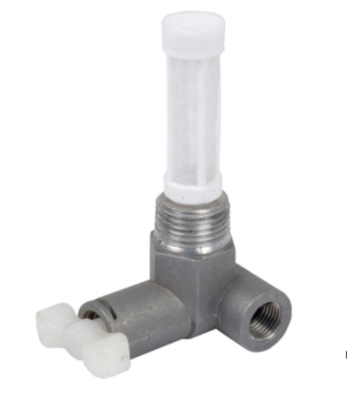

Welcome to TBN. You may have a clogged fuel valve. You can blow compressed air back through the line from the filter and see if this fixes it.
If so, the strainer on the fuel valve in the tank is missing and allowing gunk into the valve opening.
/ 345 D Ford stalling #3
careful blowing air backwards up the fuel line, real easy to blow the strainer out of the top of the cutoff valve in the bottom of the tank. If it were mine, I'd drain the tank, undo the fuel line and unscrew the valve out of the bottom of the yank. I'm betting you'll find a bunch of trash stopping everything up
I'm thinking that the filter already fell off in the tank and the trash/gunk is already in the valve opening. Regardless, the tank will need to be drained to repair filter and clean the tank.
This is just a diagnostic procedure and I agree, 5-10 psi air pressure would be adequate.

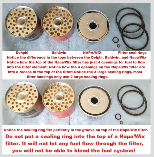

/ 345 D Ford stalling #7
That illustration says don’t put an oring on top of the Napa/Wix filter.. but it doesn’t say to put it UP IN THE GROOVE in the filter head.. it’s a smidge mis-leading..
U DO use an oring, it’s placed up in the f head..
Be SURE to check that shut off tap filter screen.!!
Good luck..

Wow guys I don’t know what I’d do without you guys, I’ll let you all know how I make out tomorrow. I’m gonna check to make sure the o ring isn’t blocking fuel and if that isn’t the problem I’ll drain the tank. I bet it’s clogged

MAKE SURE the TOP ORING on the fuel filter went UP IN the filter head and NOT ON the filter.!!
It was the o ring on the fuel filter!! It was blocking fuel flow, so simple and so crazy. It is a Napa filter. After I bled everything, fired right up. I ended up having to make a key, that was nuts. I can’t find the right key online but made one easy enough! Lol thanks again everyone, love tractor by net
