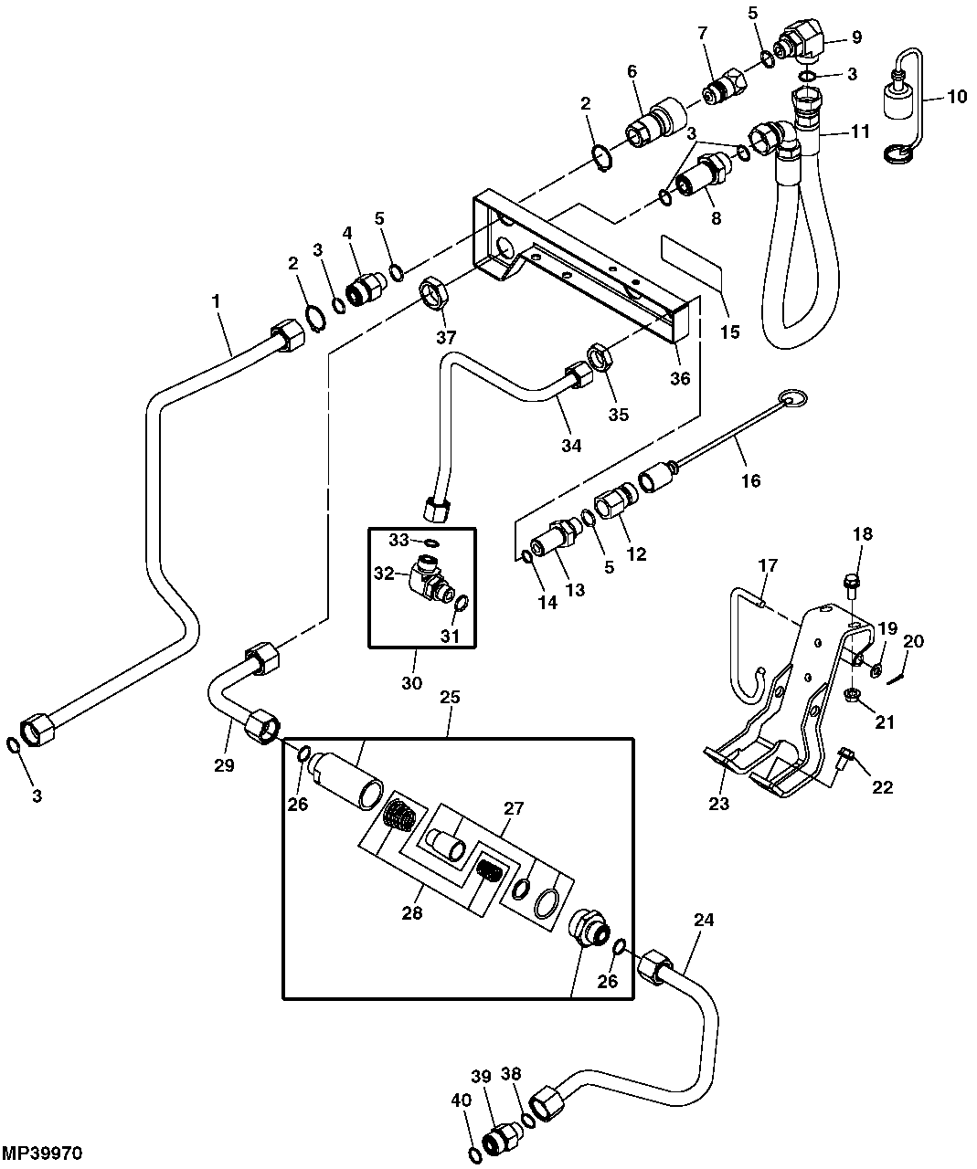

There are two "return" fittings that the PB hose can plug into...one bypasses the 3PH and goes directly to the tank, the other feeds the 3PH and is used when the hoe is removed.
/ 3320 rockshaft doesn't rock #10
The PB that is on my 3720 has only two fittings. One is the pressure fitting (looking at the tractor from the rear looking forward it is on the right) It is a female quick connect. The other is a male plug, which is the return fitting (looking at the tractor from the rear looking forward it is on the left). John Deere says that the return fitting is not used when the hoe is removed. It should be capped. So I really don't see where the "second of the two "return" fittings as you describe are located. If you could she some light on that, it might solve the problem. Thanks
/ 3320 rockshaft doesn't rock #11
On the bracket there is two return fittings, #6 and #12.
#12 feeds directly to the tank bypassing the 3PH.
The picture I posted is for the OS tractor, not the CAB model.
OK, yes and I have the OS tractor. In preparing to detach the hoe, there is only one hose and associated quick connect which will hook up to #6. I think that I know that #12 is a by-pass used only when the hoe is being used. I used a plastic dust cap to seal #12 and hooked up the other hose and quick connect to #6. I think that is the way it is described in the manual.
