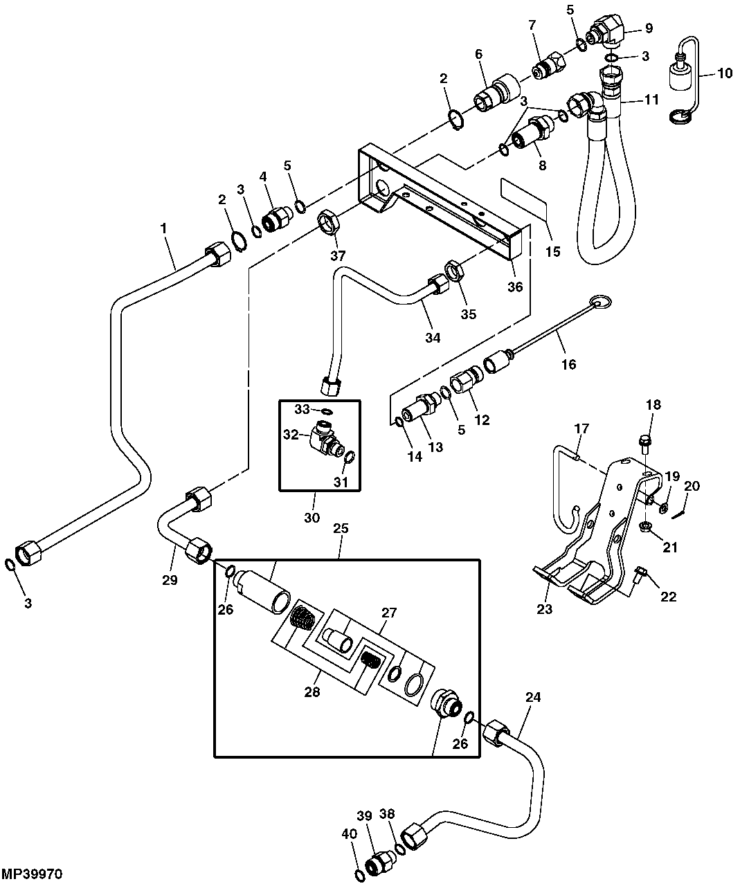

I got a new 3320 with the 485 hoe delivered a week ago saturday and had the same problem. The dealer came out and tried to get the 3 point hitch to work with no luck. They
came back the next day and took it back to the shop. They got the hoe off and said that
a hose was hooked up wrong from the factory? They put the hoe back on and brought it
back to me last Friday. I was able to take the hoe off with a little help from the stabilizers.
The 3 point hitch seems fine now.
Be nice to have clarification of "which" hose and "where" it was hooked up "wrong"?
/ 3320 rockshaft doesn't rock #22
I'm not sure what was plugged in wrong, but I have everything tagged now. They think it got over pressured and caused the stabilizer cylinder to start leaking. They rebuilt the cylinder and everything seems fine now, except the 3 point hitch can't quite pick the hoe up high enough to take the L pins out, but you can feel it trying, which is more than it did before. I won't be putting the hoe back on for at least a week with all this rain.

Your hydraulics are connected correctly. Can you raise the lift arms manually? Is the hoe still on the tractor? If the hoe is still on, the arms cannot drop much because they are hung in the hoe hooks, and may not lift sufficiently to remove the hoe if not adjusted correctly (see below). Did the hoe work correctly when attached?
There is a rockshaft height adjustment mechanism on the left lift arm. Make certain it has not come loose or something. Its adjustment determines the max lift of the hitch arms. The "feedback rod" is lengthened to increase lift. Do not adjust it (too long) to where the system goes into relief. Should be 17.7 inches from center of lift arm pin to top of PTO cover.
With only 20 hrs on the machine I wouldn't monkey with it too much, just call the dealer.
I now have come to the conclusion that as others have reported, that the rockshaft arms will not lift the hoe far enough to install the L-pins, requiring the use of the hoe hydraulics to put it in position. I agree with others that this is a pain. It's supposedly designed to work as advertised. I am waiting to receive a technical manual which will hopefully address this, but how does the rockshaft height adjustment mechanism on the left lift arm work? If I could get it to lift just another inch or so, I could probably get the pins installed. Thanks.
On the left lift arm axis there is a piece of tube with a threaded shaft running through it. The shaft sandwiches the tube between two nuts. If you loosen (CCW) the nut (15mm wrench I think) nearest the rear of the tractor a couple of flats and then turn the front most nut CCW to take up the slack you created by loosening the rear nut, you have effectively lengthened the shaft (rod) and will cause the hitch to lift higher.
I would only do a couple of flats at a time and then test the results. Do not adjust to the point that the lift goes into relief. It is a combination of lift adjustment, hook adjustment, and patience. Tighten things up when you are done. If push comes to shove, rather than grind the hook slots I would recommend getting a couple of bushings from TSC or elsewhere. I can't remember the exact size, 3/4 to 1 inch maybe. Slip them over the lift pins and you get another 1/8 lift for next to nothing.
At any rate, even using the stabilizers, the hoe goes on and off fast with practice. The best advice I have is to but a cinder block or chunk of wood under the bucket when you drop the hoe. If you do not do that the hoe will lean back too far and you will not get the lift pins to engage the hooks.
