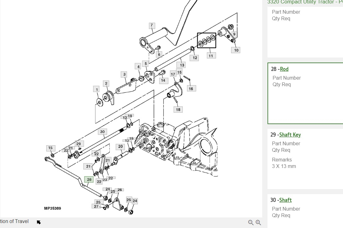

My 3 point hitch just started, or I just noticed it, dropping about an inch then raising back up on its own. It only does it with an attachment on. You can rear the pump building pressure or hissing then it drops and raises back up. I remember other members having this issue on other 3000twenty series tractors. I can't seem to find the thread on it or what the repair detailed. Anyone have any ideas or answers...Thanks.

It's possible the rockshaft piston seal is leaking causing the hiccup affect.

Thanks guys. Anyone have an idea of how hard the seal is to replace or a diagram?

It's also possible the RS control is no totally returning to neutral with 3 pt height is reached.
1 ea M136632 O-Ring ADD 2.25 USD
1 ea M136631 Seal ADD 35.43 USD
2 ea Z62523 O-Ring ADD 1.03 USD 2.06 USD

Have you tried adjusting the control linkage that kicks the valve into neutral at the top of the lift? Sounds to me what needs to happen before replacing seals.

I agree with beenthere. I'm not familiar with the 3320 layout but my 4400 was doing as well. With mine there was piece linkage you could follow up from the lift arms in back that had a threaded rod with a couple jam nuts on it. The had gotten loose over the years and was causing the porpoising effect. Essentially it would lift to position then drift down then go right back up again. Just had to tighten it a little bit and the effect went away.
As others said, if that doesn't correct then it is most likely the piston. You could also try adjusting the flow rate valve under the seat to help at least minimize the effect until you can get it sorted out.

Once I adjusted this same rod on my 4410 the drop and rise again every 5 minutes or so went away. I don't remember which way I adjusted the rod but it's very simple to do. On my 4410 the rod is on the left side fastened to the rockshaft arm.
