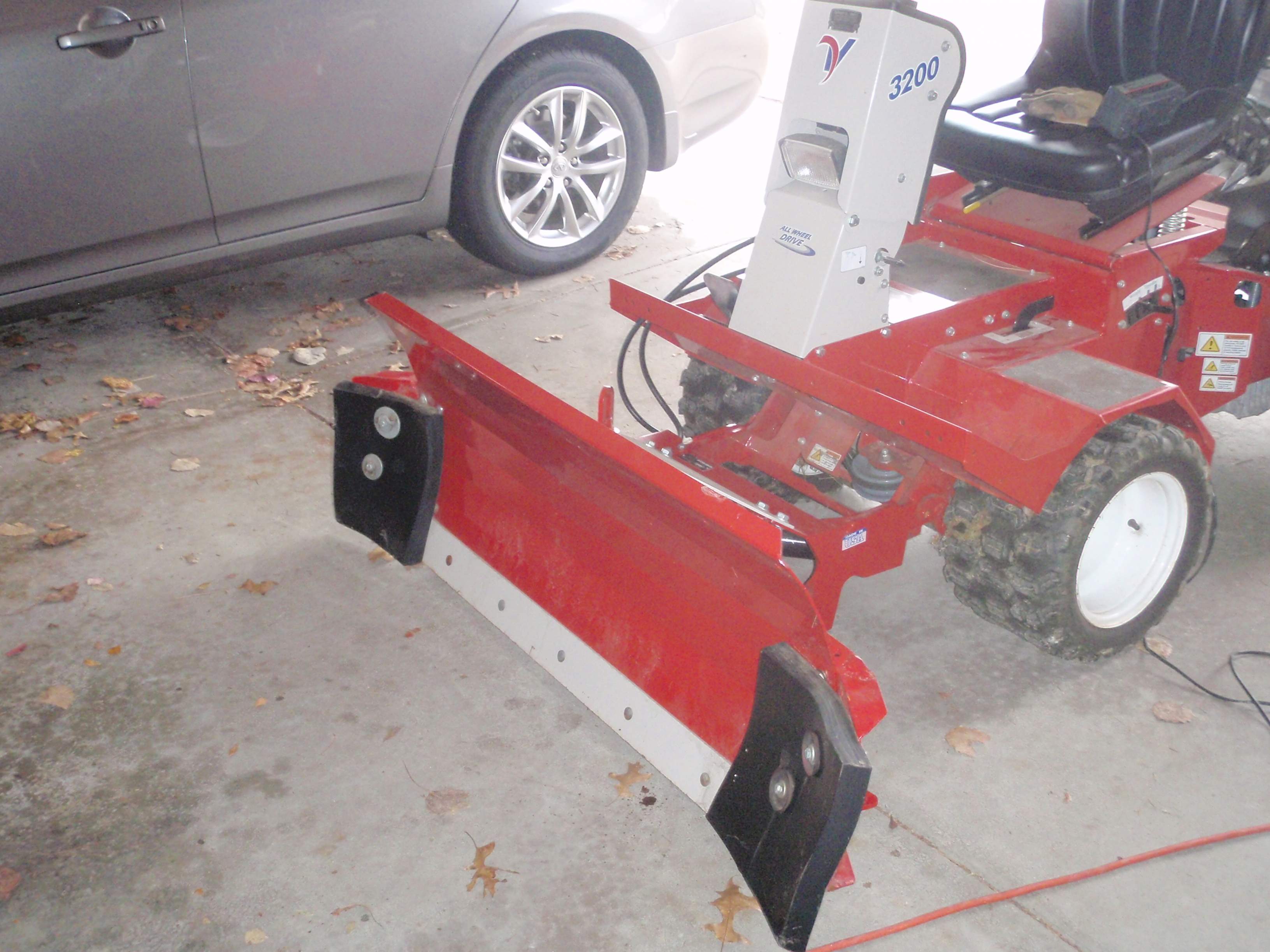

Thought I would post a picture of My Ventrac with the plow on it.
My driveway is pretty steep and with any ice traction can be an issue. I think I will add some weight this year to the rear of the tractor. I would like to add some wheel weights but not having any luck finding them.
Anyone else adding weight to their 3000 series for traction?

I hope to purchase a 3223D with 60"mower and V-blade once I sell my 2210. The dealer stated rear weights were not necessary with the diesel unit due to the added weight. I don't have much to contend with in terms of steep slopes for plowing. Is the 3223D run a plow fairly well as far as snow removal goes? I do plan to upgrade to the knobby tires. I currently plow with turf tires on my 2210 and it does well enough to meet my needs 95% of the time.

With the knobby tires I think the traction is pretty good. Only if it is really icey have I had problems.

@marnett...Your dealer is most likely correct on the diesel unit as the engine is much heavier than the gas engine (guessing 200-250 extra lbs?). The option is there to add the rear weights, but aren't necessary for the 3223D imo.
What my friend did, rather than adding more weight to the back, was add weight at the front. Don't know if he simply bought some extra suitcase weights from Ventrac and hung them right at the top where your toes would be or if he actually welded a bar to hang them on at that point. That way the weight is still right over the front axle and you have solid contact on all 4 tires. I haven't used it on icy ground since he did that little mod, but he says it has helped enough that any spots where he may have had a small traction issue, it is now gone. Just an option if you are experiencing traction issues, but I think it is unnecessary 99% of the time as the 4WD and traction of the Ventracs is superb and they can push a lot of snow!
Also to note, I am sure your traction on the front end is variable to the weight of the operator lol My buddy is smaller and only weighs 130lbs. Get a larger operator on there and you might not need any extra weights :laughing:
Thanks
Have you done anything for weights yet on your 3200? I have a early model, 3000 and I made a "weight box" to hang weights on the back. I'll try to post pics soon.

A friend of mine had some 50 pound weights they would use to test large scales. They are almost a perfect square shape. I used 2 of these the other day and they worked pretty well.
