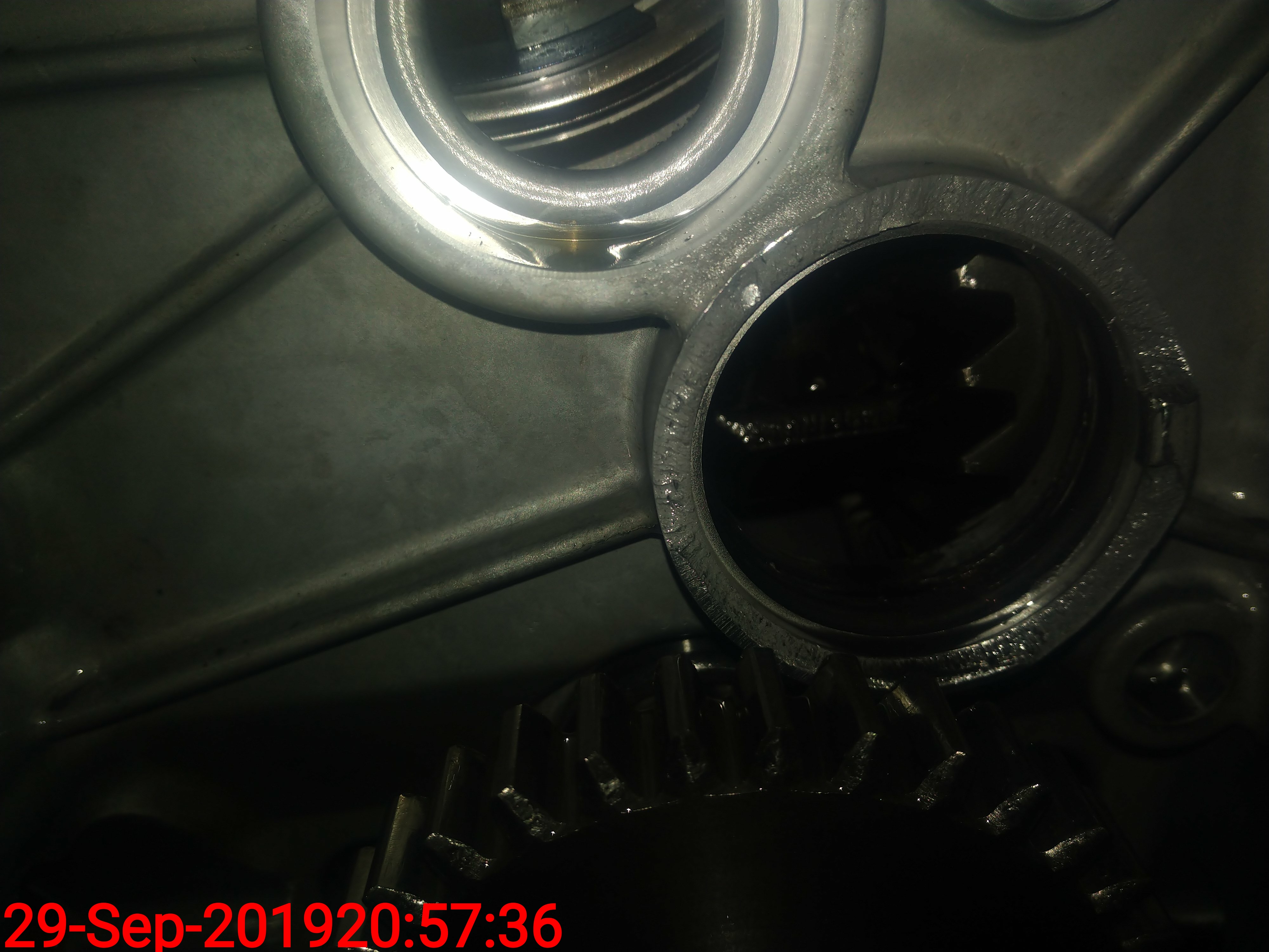

started with left side axle case, and ended up removing everything from the transmission back! pinion bearing seized and broke out the bearing seat and snap ring grove in the cast aluminum housing and chipped some pinion gears.....
and yes there was or seemed to be lots of oil in there, i pulled dip stick and was at full mark. before we undid any bolts........we drained a full 5 gals of hydraulic fluid out..

ill attach housing pic, might not be able to see clearly. was dark by the time we cleaned up tools etc....

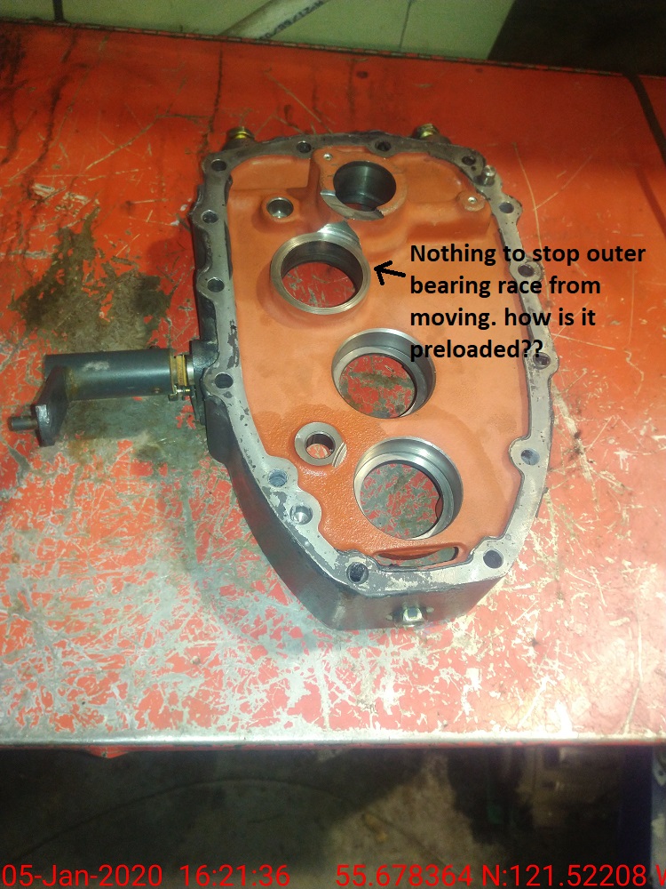

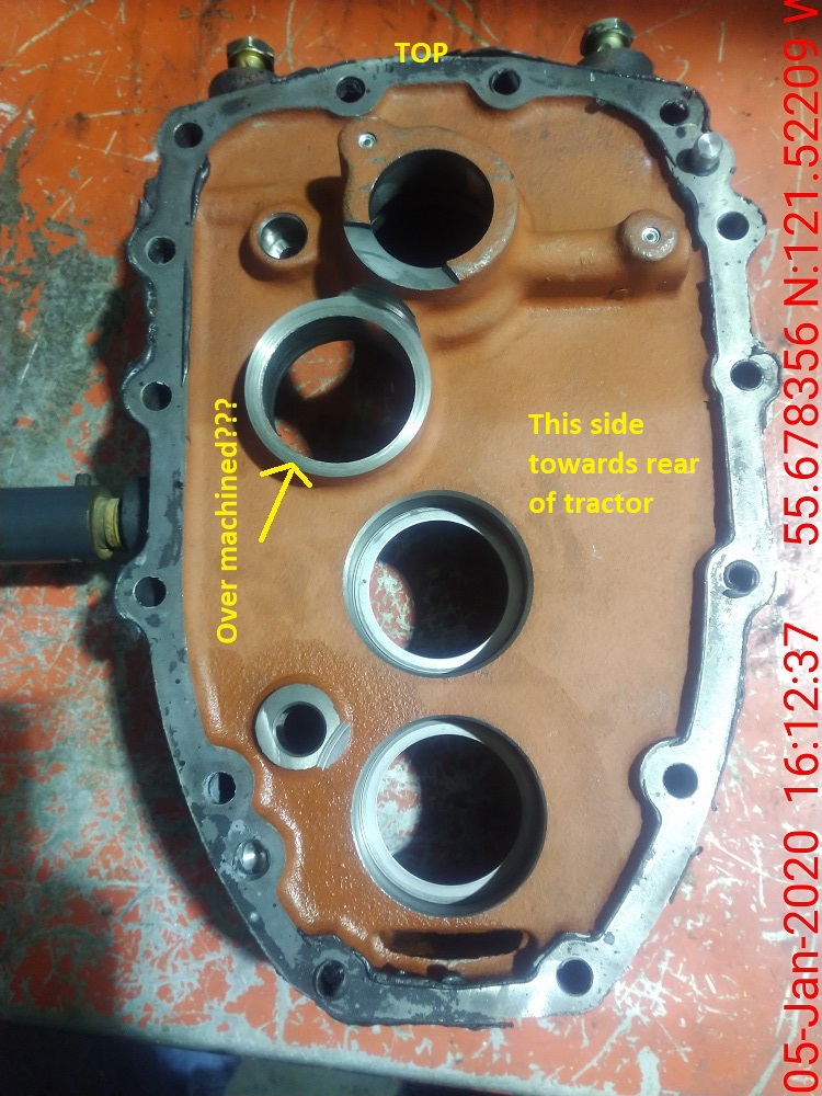

So our parts arrived for my uncles 3215 a few weeks ago. finally swapped the parts from old housing to new one inc new pinion and ring gear.

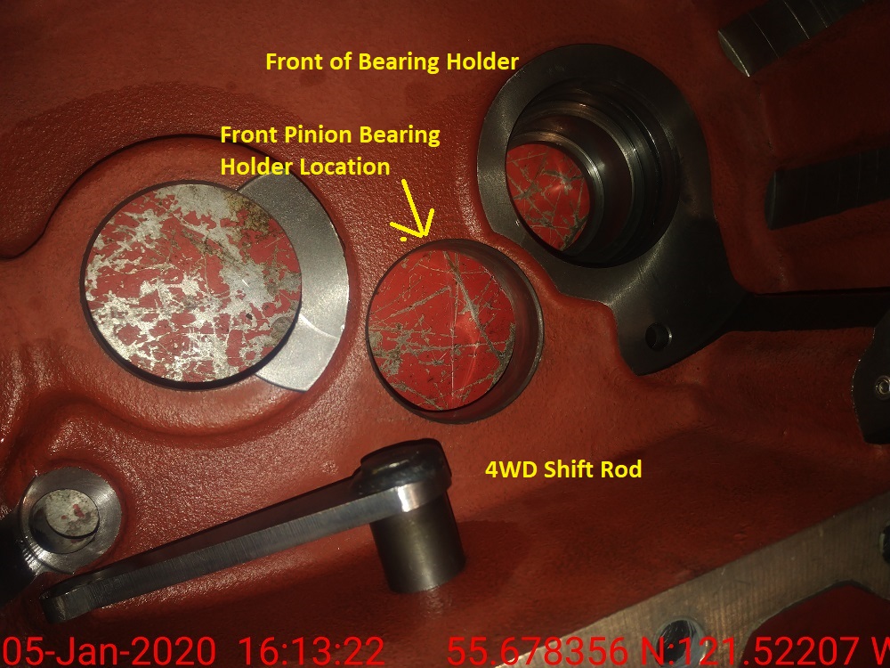

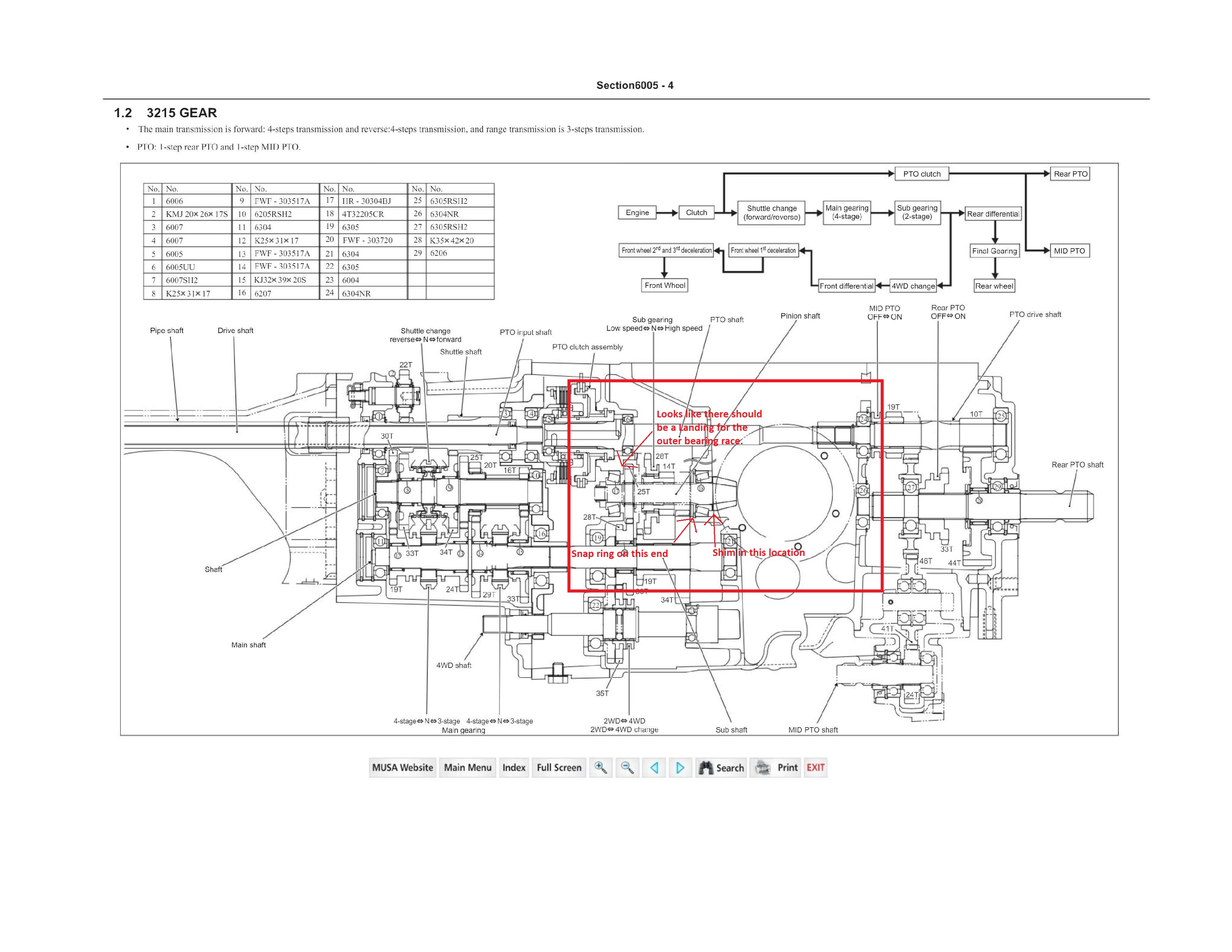

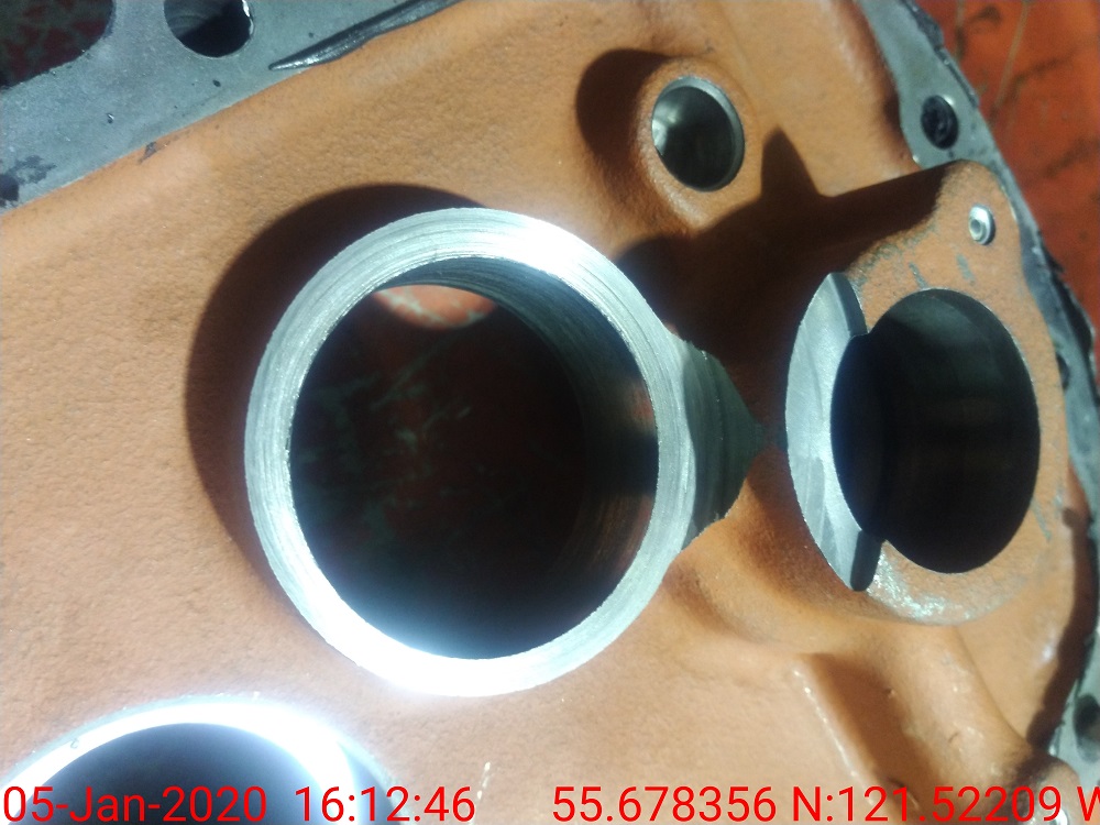

but as we were assembling the bearing holder that attaches to the front of the axle housing we noticed that there isn't any snap ring or landing for the outer bearing race (on the end of the pinion shaft with the nut). so my question is how do you set pinion pre load if there is nothing to stop the outer bearing race from moving? and it went into the hole too easy in our opinion.
i think there is something missing or possibly a factory defect... see images.
what are your guys thoughts?? link to service manual included. page 218 i have drawn some info...Back of Bearing Holder.jpgClose Up of Front of Bearing Holder.jpgClose Up of Rear View Bearing Holder.jpgRear of Bearing Holder.jpg
Dropbox - mah3215service.pdf - Simplify your life
Thanks
Shawn

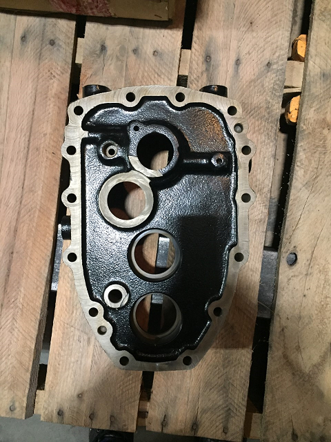

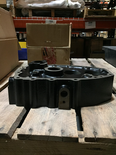

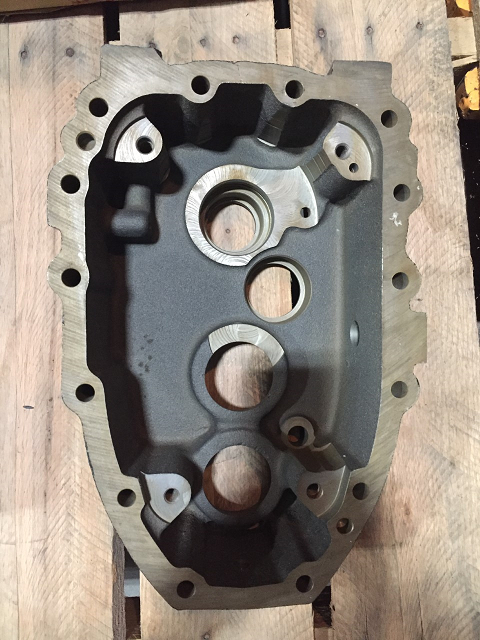

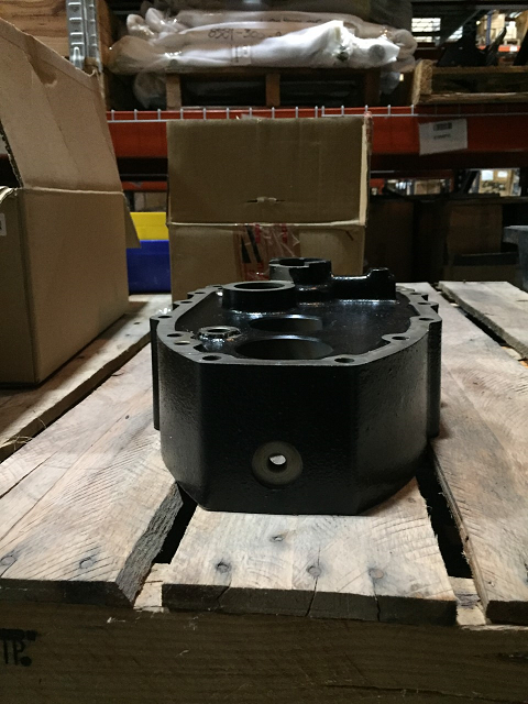

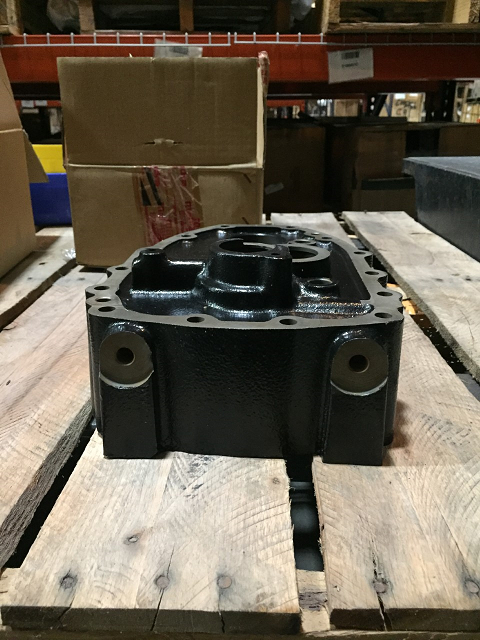

/ 3215 Gear Differential Housing
Update: got my awesome dealer where i bought my 2638 HST Cab from to do some digging and got confirmation today. the new bearing holder housing does indeed have a lip or landing(call it whichever) for the outer bearing race to seat against. kind of what we thought and as the page from the service manual. so my uncle ordered the new housing today... probably could have got a good machine shop to do the repair if we could have got some measurements but for his peace of mind he bit the bullet. hopefully no one else has this happen to them but i think it was rare factory mishap IMO.... here is the new pics from the parts warehouse.3215 bearing holder.png3215 bearing holder2.png3215 bearing holder3.png3215 bearing holder4.png3215 bearing holder5.png3215 bearing holder6.png
