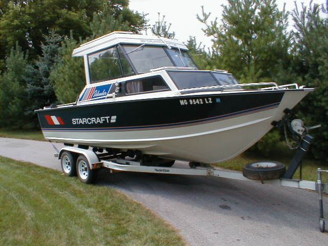

My first barn was 34 x 48 x 10, it came with a house I bought. I had to use my garden tractor to get my boat in there because it was to tall when hitched to a normal vehicle. My motor home had to sit outside and be serviced outside....
12 foot tall should be a minimum, my new barn is 40 x 60 and has 14 foot side walls. I have never heard anyone say "I wish my barn was shorter" but I have heard many people say that they wished their barn was taller. Going up is the cheapest way to get a lot more cubic foot of building for very little money.

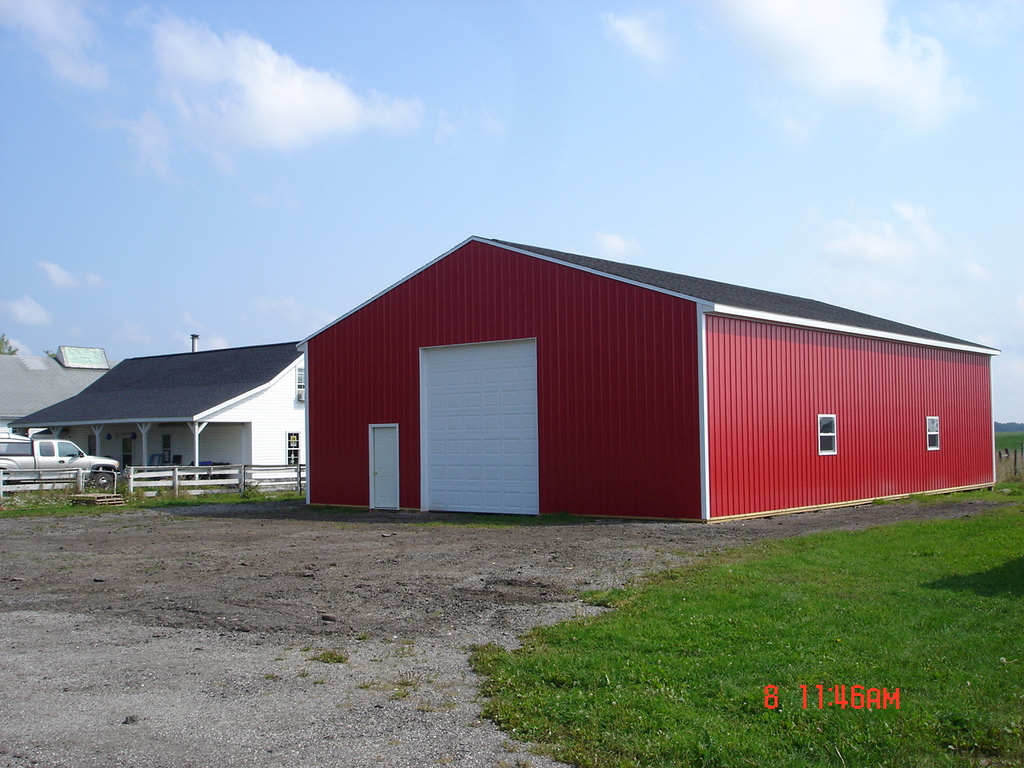

now my stuff will fit through the door.......at least the stuff that I still have...
