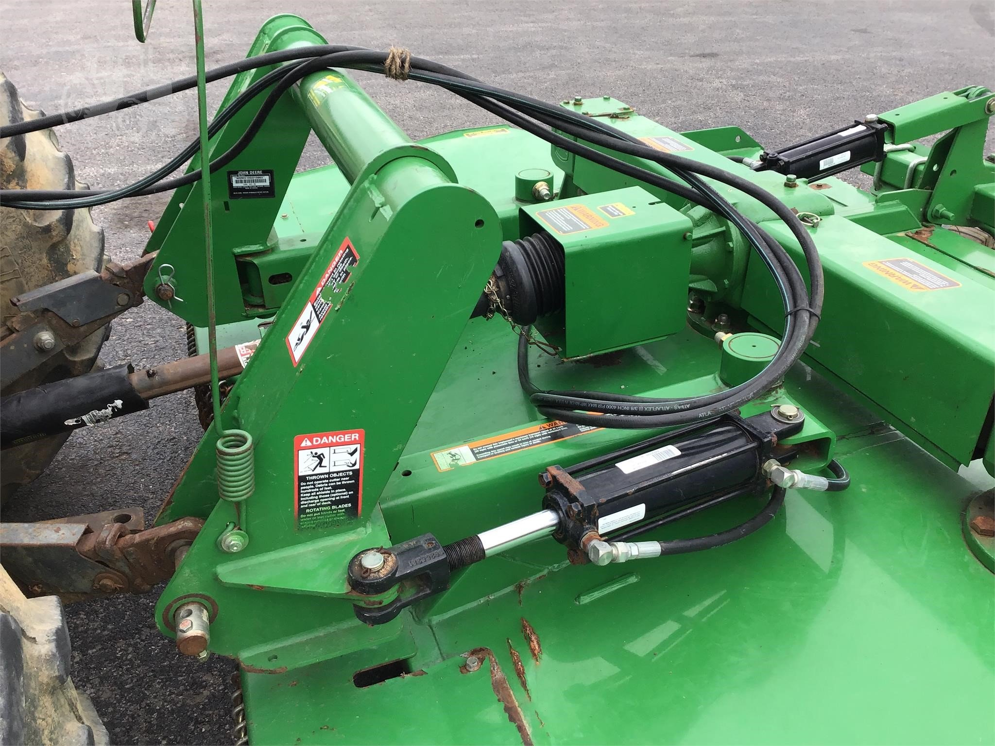

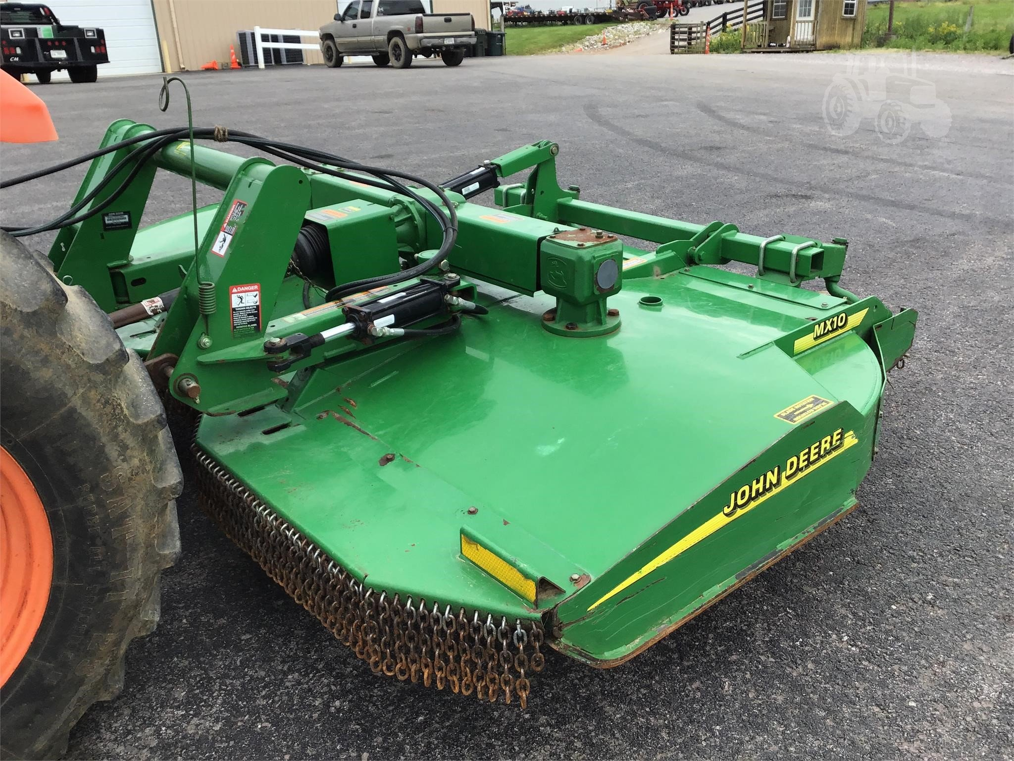

What is semi-mounted?
The cutter uses the lower two arms of the three point but not the top link. It uses a set of tail wheels attached to a hydraulic cylinder to lift the cutter. This results in a cutter that doesn't put all of the weight on the 3 point but isn't as long as a drawn cutter attached to the drawbar.
Interesting. Any chance you would have some pictures of this?

Do note there are other semi-mounted implements that attach differently. A semi-mounted implement simply doesn't carry all of its weight on the 3 point hitch and instead uses a tail wheel. There are a lot of plows in particular which are semi-mount and they use all 3 three-point links but have a tail wheel and a cylinder to raise the rear of the plow.

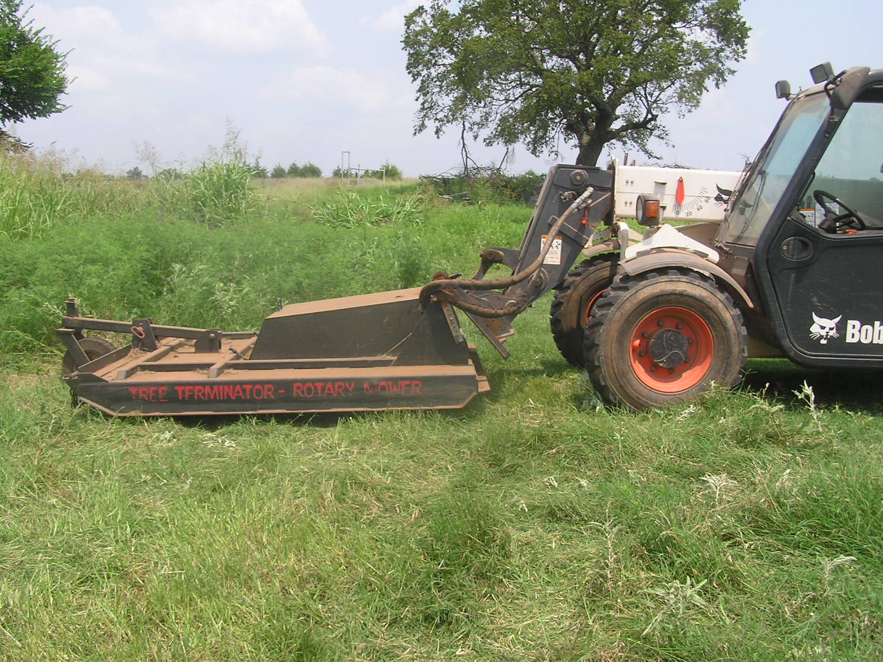

I just learned something new. I never knew this until you pointed it out. Thanks!
