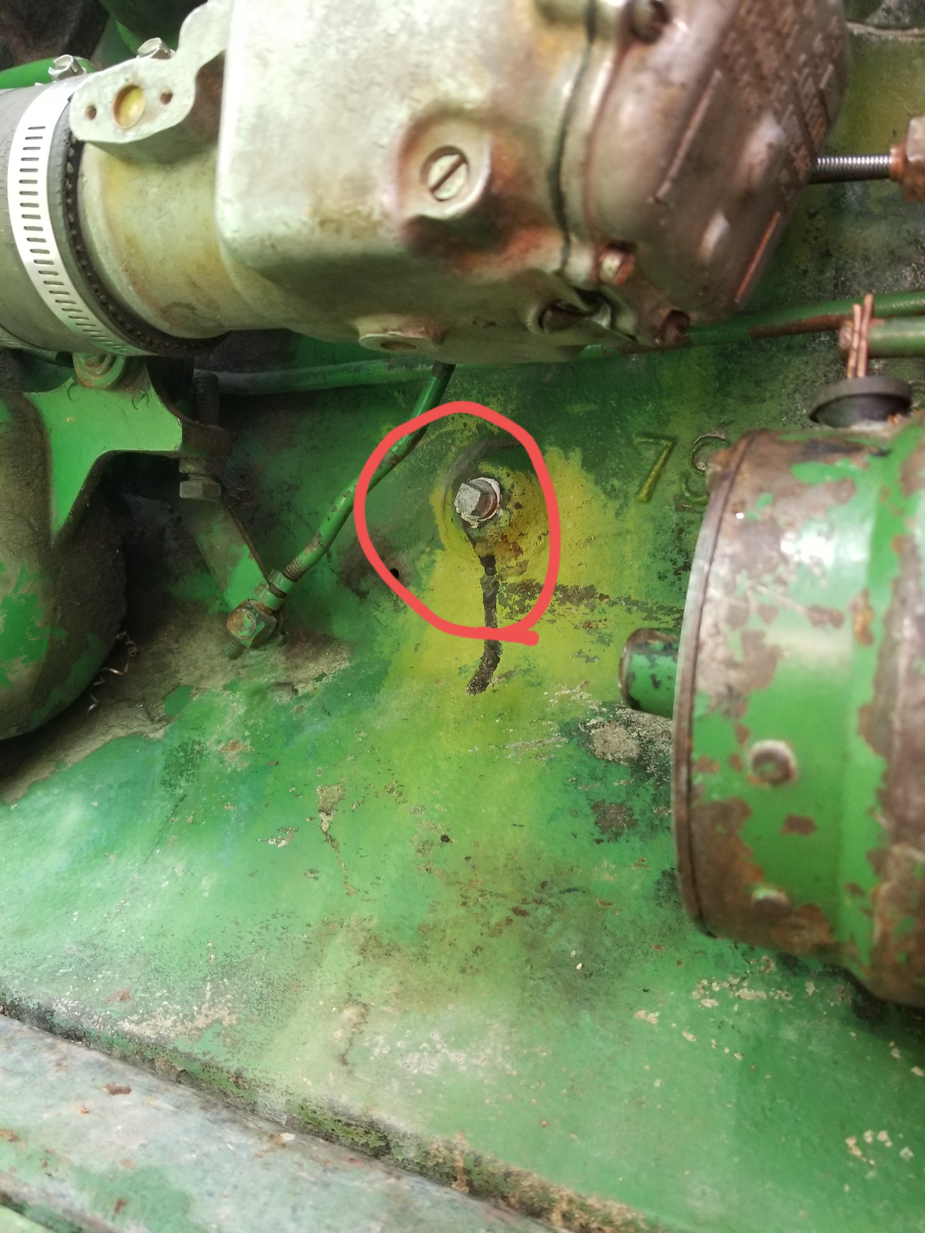

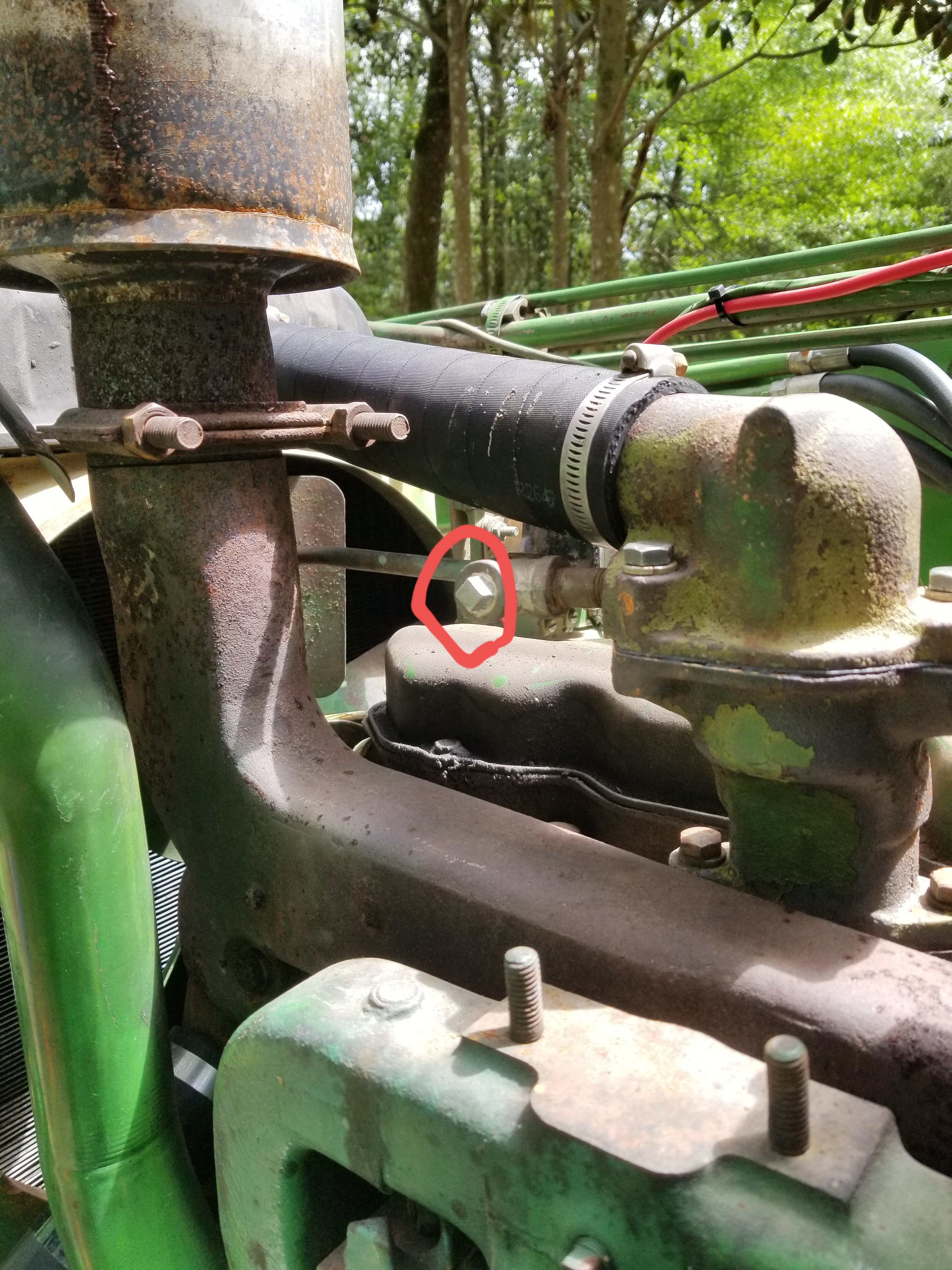

My gas 3010 is peeing out coolant from the overflow tube when it gets warmed up. I had removed the block heater and plugged it. It was teed into the bypass line and went to the drain plug in the block. I just installed a new clutch and it did not do this before. Assuming it was the thermostat I replaced it along with the cap and both hoses. Any suggestions? Removing the heater wouldn't have done it would it?

/ 3010 coolant overflows
Here is where the heater was plumbed into.

I was hoping that is it but i had drained all coolant from the block too. I just checked it after letting it cool down and it is still full. Shouldn't the thermostat have opened up letting coolant fill the block back up then I would have needed to top it off.
