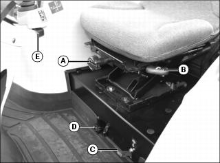

Locate your Operators Manual. If you don't have the manual go here: OMLVU19809_L8
Scroll down the left side and look for "Operator Station Controls (EHydro With Cab) go to that location. The lock lever is located at (e) on the bottom of your joy stick according to the JD pictorial photos.There should also be a label affixed near the lock lever with two locks, one locked and one unlocked. Move several times from the locked to unlocked position, leaving in the unlocked position. When placed in the locked position it prevents the joy stick from being moved.
A - Operator Seat Weight Adjustment Knob
B - Operator Seat Adjustment Lever
C - Differential Lock Pedal
D - Rockshaft Rate-of-Drop Control Knob
E - Dual Selective Control Valve (SCV) Lock Lever

I took my panels off and also the wheel so I had full access to the cables. There is obsolete lay no way to take up slack. The slop is in the stock cables themselves. If you adjust the connections at the ends, it doesn't take up slack but only moves the joystick off center. The joystick lock is a joke. I did center the joystick by adjusting the cables and got the lock to engage but it still sucks
