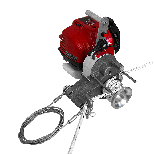

About 1500 bucks. That's not too bad, all things considered. I wonder what the specs are on it? I can't find any on their website.
I got a note back from the company. Here is what they said: "Hi Tom
The cost of the Skid Winch is $1475 + Shipping, It can use a pump with as low as 4-5 GPM." So, it appears to still be available and it would work with our CUT and SCUT hydraulics.

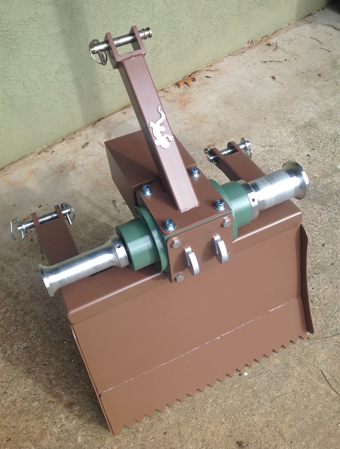

Alright, did a full write up here: http://www.tractorbynet.com/forums/build-yourself/392375-pto-capstan-winch-scratch.html
flingwing1969 - I consider the Norwood Skid Winch video to be...how shall we say, less than impressive. Skidding over clear, leaf-covered ground, is as easy as it gets. The videos of Farmi winches are typically much more interesting, stuff like pulling three trees at once through nasty terrain.
Originally I set out to just build my own clone of the Norwood, it looks so simple, anybody could build that. But hours of shopping for hydraulic motors came out with nothing that made sense.
High speed, low-torque hydraulic motors are readily available, but useless in terms of pulling power.
Slow speed high-torque motors are also plentiful, but all require massive flow rates, like 15-20 GPM. On the hobby-end of the tractor market, nobody has tractors flowing that.
I have no idea what Norwood picked for their unit, but given the video, I suspect they had to make a compromise in the end, and the unit lacks pulling power. Pretty sure my PTO winch easily out pulls it.
PILOON - If I didn't have a dual-shaft gearbox, I would have done vertical mounted drum. Working out the mounting for this gearbox in a vertical configuration was hurting my head too much to attempt, so I just went with horizontal.
Great write up and a very nice build!
Correct me if I'm wrong but doesn't a horizontal capstan require you to stand in the danger zone from a line snap? The advantage to a vertical capstan is that you stand off to the side a bit and out of harms way.
Could you weld a couple of eyes to the top link bracket and use a snatch block on the low tension side? That way you could operate it off to the side of the pull line.
Just my $.02

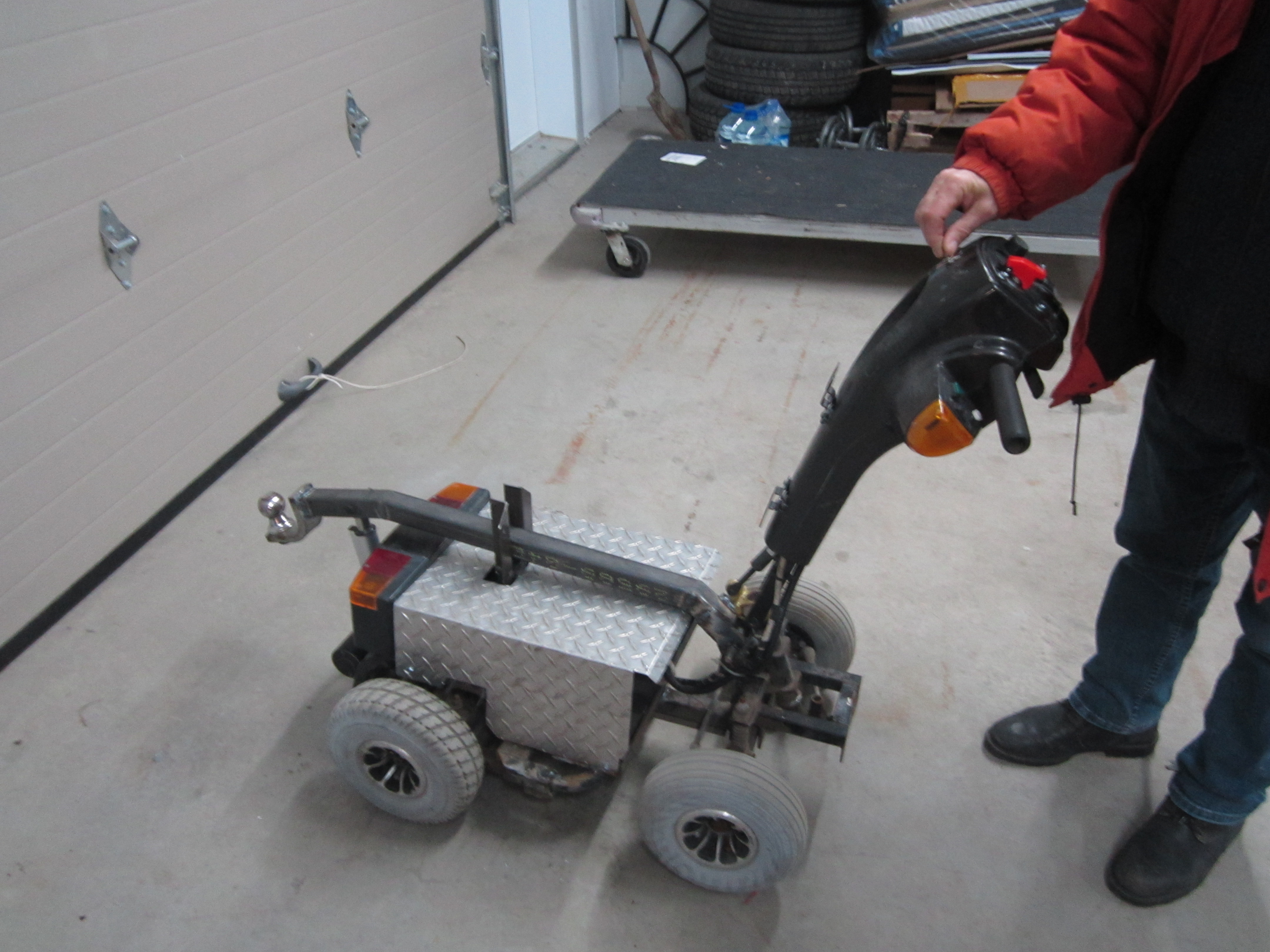

Do a new Thread for that one - assuming we're talking about the "wheelchair trailer mover thingy". Love to see that too as I happen to have a nice motorize chair not being used. They can be had "pretty cheap" too.
Photo should be attached.
Sorry only one I have is the finished project.
Note reversed handle bar, (easy mod), the framework was cut and shortened.
The lifting is a 12 volt electric screw jack that I had.
The lift arm is shaped downwards to slip under the trailer hitch.
Yet to come is some weight ballast that will be in a metal box below the steering post.
I calculated we will need about 125-150 lbs.
On the fun side, none of the electrics were modified so the 'mover' has lights, horn flasher etc. So it is 'night time rated'. LOL.
The hand in the pix is on the 'up/down' switch that controls the arm.
This mover is for my friends storage facility that offers free trailers for his clients to move in. He also rents as well so some days they move trailers a dozen times or so.
When we install the weight box it will also serve for parts and tool storage.
Was a real fun project, and it handles really well.

Instead of a weight box on back, put a stand on like a walk behind mower, that way you can ride on it and be the counter weight
