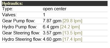

Found a log splitter locally on CL and would appreciate a sanity check on whether my tractor can handle it or not. The splitter is a Speeco 400197 that runs off the tractors remotes, I would like to use it on my Mahindra 3510 gear tractor. From what I can find my tractor is rated at 6.4 GPM? The splitter requires a range of 6-25 GPM. Am I risking damaging the pump on my tractor to run this splitter? Seems like a nice heavy duty unit. Asking price is $450, not sure what they go for? It seems this model has been discontinued from Speeco.

No, you will not damaging the pump, had the pump flow been much higher than the spesification on the splitter you would have built up heat.
/ 3 pt Log Splitter #3
No, you won't hurt your tractor,
you will find that the splitting speed is a bit slow as your flow rate is at the low end of the recommended range.

thank you all, appreciate the feedback. I haven't yet used the remotes on this tractor (its a 2005 with 1300hrs), is it as simple as plugging in the lines and away the splitter goes? Or do I have to engage the flow lever one way or another?

I found the manual for the splitter online, control of the valve appears to operate exactly as you have described it Lou. There is also a note in there detailing how imperative it is to make sure the pressure line (from tractor) is hooked up to the inlet side of the valve.
Now it seems the biggest challenge for me to determine which remote is activated when I push the lever forward or back, I'm going to have to break out the manual for that.

Open center is the usual on CUTS, and on splitters.
You want to fix the tractor remote lever in place and operate the splitter using the splitter's valve. Having to go back to the tractor to operate the valve will make splitting a real pain. Also most splitter valves detent on the return stroke so you don't have to sit there holding while retracting the ram and can go stack your new splits or fetch a new round.
With a 4x24 cylinder (according to the manual) and 6.5 gpm a full stroke (splitting direction) will take about 12 seconds. The return stroke will be somewhat faster but still slow. If it's got a 1.5" rod the cycle time will be about 22 seconds. That's considered long. You'll be waiting a lot.
Your typical low-mid range homeowner standalone splitter has a two speed pump with a high speed around 16 gpm. The two speed pump automatically shifts to low speed under heavy load. For my splitter that's only the toughest logs. It's cycle time on a 4.5x24 cylinder is about 14 seconds which is still a bit long. I often am spending time waiting for the next stroke and often short stroke it since I'm splitting 16" rounds.
You might think oh 8 seconds that's nothing. But add that up for the hundreds of splits that make up a cord and it'll be something. Of course it depends on how fast you move. If you move slow then the long cycle time might not be a problem. If you're reasonably quick and have a normal amount of (im)patience it will probably be frustrating.
A standalone splitter often makes higher peak hydraulic pressures than a tractor, which translates into more splitting force for those tough logs.
Even though it will be close to "full throttle" the tractor won't be consuming as much fuel as if you were really working it. Since the power demand will be low the governor will add enough fuel to overcome the engine's internal resistance to running that rpm and then add what's needed to pump 6.5 gpm at the pressure that's required, which won't be much.
