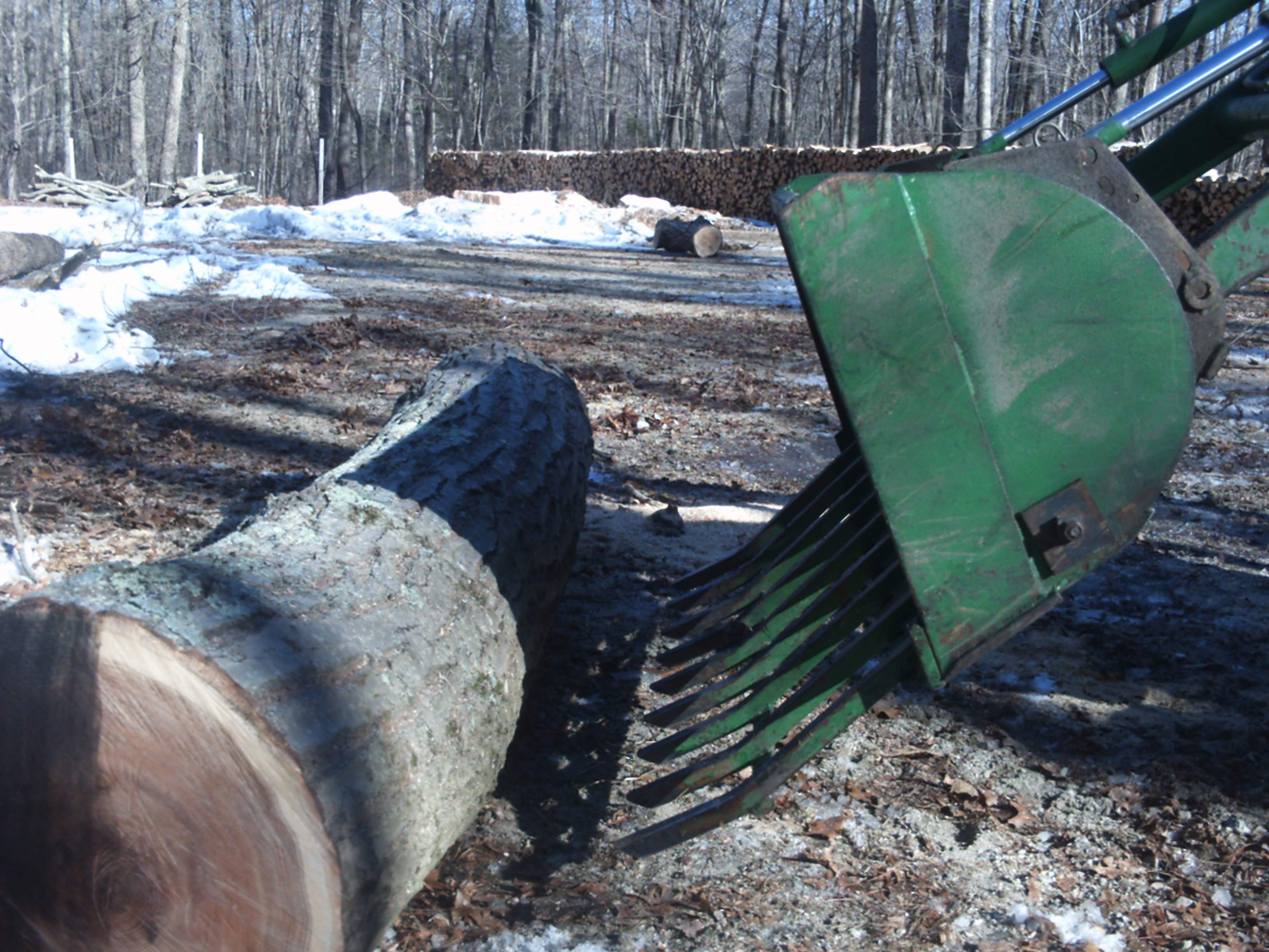

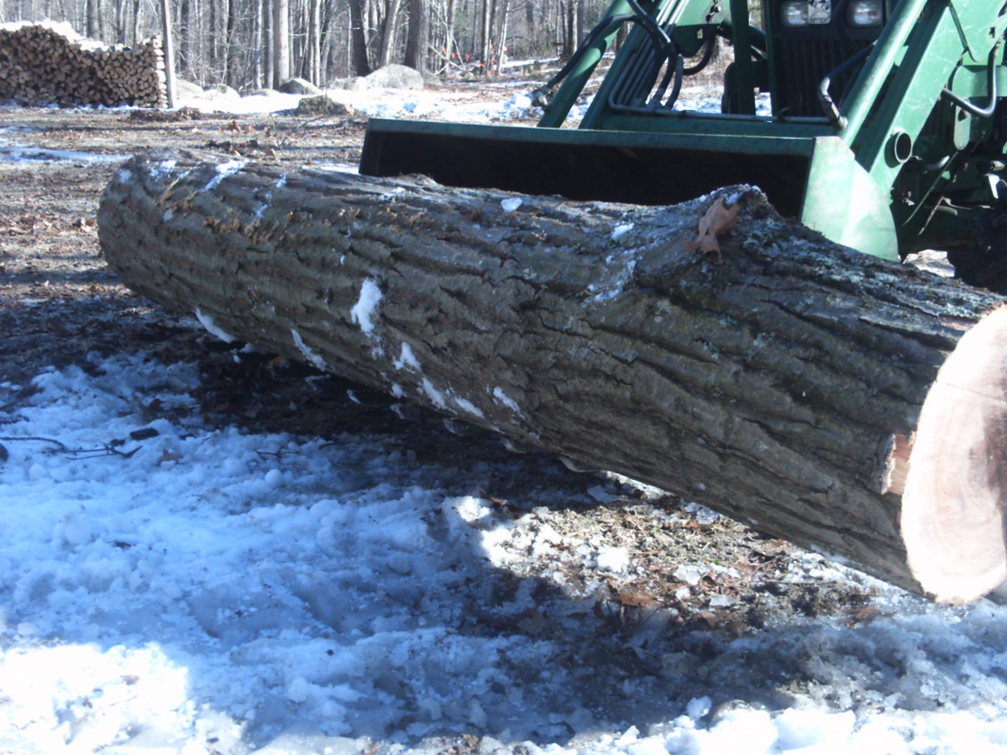

This is a picture of how I move logs to the splitter. This oak one weighs about 900Lbs and is as far as my fel would lift. I can easily get under a log like this with my front tine bar but I know with all the wigglin and wagglin the fel goes through moving to the splitter, this cannot be a good way to move this very spread out weight without the fel, front axle and tires getting beat up in some form or fashion. The question I have: does anyone use their 3 point forks such as pictured, to get under a log such as this or do the straightness or shape of the forks inhibit this manuerver. I carry them up in the air so I can buck them right at the splitter without the stem being on the ground.

Looks to me like the manure tines on the bucket work fairly well. Forks would be easier to get under a log though. A top thumb to drop over and hold the log is what I would like to add (thinking on it).

Also, I did not have the success of flipping a log into the bucket until I bent the front edges of the tines. Before that, the logs just kept rolling off and was wondering if this happens with the straight forks as well.
With the forks much longer than the tines, it shouldn't happen as easily or at all since you would be all the way under and beyond the diameter of the log.

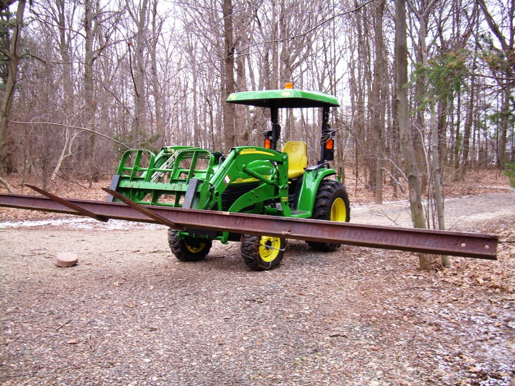

I use these forks on my Yanmar. i dont have the hydraulic tilt yet but they still work good. I tested them on my Dad's 3720 and they started to bend at 5000 pound load. This was by lowering the dumptrailer onto the ball for the forks. It was full of material. So they should always be strong enough on my Yanmar.:cool: I just need to add 2 more weights onto the front because the front end likes to come off the ground with a load over a few hundred pounds. 200 pounds of front weights should help. Atleast i have field brakes.:rolleyes: Would you believe those forks used to be for my step Mom's skidsteer?

In general, I'm not a member of the safety police, and have been known to push the limits of my equipment in ways that could easily earn me a Darwin award. However, Arrow's pictures in post 11 give me the willies. I would be amazed if that trunk didn't outweigh that tractor by at least a couple hundred pounds. I would be very reluctant to skid that trunk with that tractor. Arrow, please at least consider making one cut in the field and bringing that trunk out in two pieces.

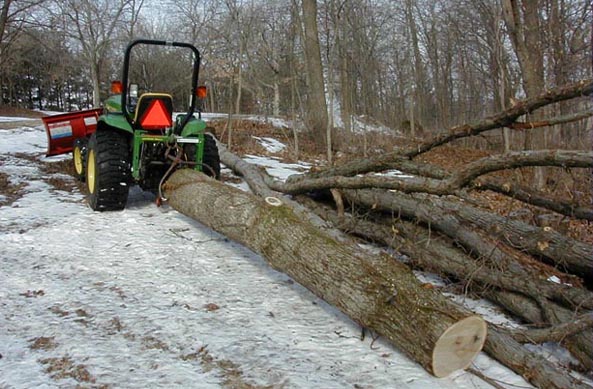

Na Jeff, my woods are a nightmare. I could never get out if I carried them out. I use the traditional skidding method, stack the stems and then bring the stems to the splitter next season.
I don't think you are doing anything "above and beyond" the equipment. Have skidded out many logs that same way. All depends on the logs, where they lay, and if I want to keep them from getting dirt in the bark. On snow helps a lot.
Actually Jeff that stem is probably a little under 2000Lbs. the tractor with fel and loaded tires is approaching 3000Lbs. Thanks for your concern however.
Beenthere: How do you like the tongs for skidding? Are they able to allow you to stay on the tractor for the entire turn or do they take some convincing to get on or off?
See that little upward slant of the forks? This is one of my concerns. This slant does make it easier to get under a log but as you are picking it up, the log will want to roll off. Hmm, I'm wondering if a little 1" slanted ear welded onto the fork near its end would be just enough to prevent a complete fall off until the angle changed on the 3 pt. Thanks for your pic JD.

.......Beenthere: How do you like the tongs for skidding? Are they able to allow you to stay on the tractor for the entire turn or do they take some convincing to get on or off?
Magic: The lifting part or lack there of on my machine is just something I've gotten used to. Its when I walk the log the 100' or so to the splitter that I am concerned about. This is a weight that is sometimes out 6' further than either side of the tractor. That is a lot of torsional force being put on the entire front end of the tractor. Can't be good for such a small machine such as our c.u.t.s. on a repetitive basis such as processing firewood requires. A dirt loaded bucket is one thing and this wide weight is another. From what I see of the contortions my tractor going through with the twisting and such of the fel posts, tires and invisible forces that have already caused a complete split of one of my front 4wd housings, I wouldn't recommend carrying a wide log with the fel for longer travel distances than to scoop it up and place it on the stem pile after skidding it close to the pile.
Arrow
The tongs are very handy and usually can back to the downed log in the woods, drop the tongs and if done right, will slide/open over the log for lifting. Usually can get out of the woods without dropping/losing the log. But I've found the time taken to throw a choker chain around the log when it is lifted is time well spent. All depends on the log. The one in the pic came out of the woods that way, and if all goes well, the tongs can be released without getting off the tractor (dismount...ugh :) ).
