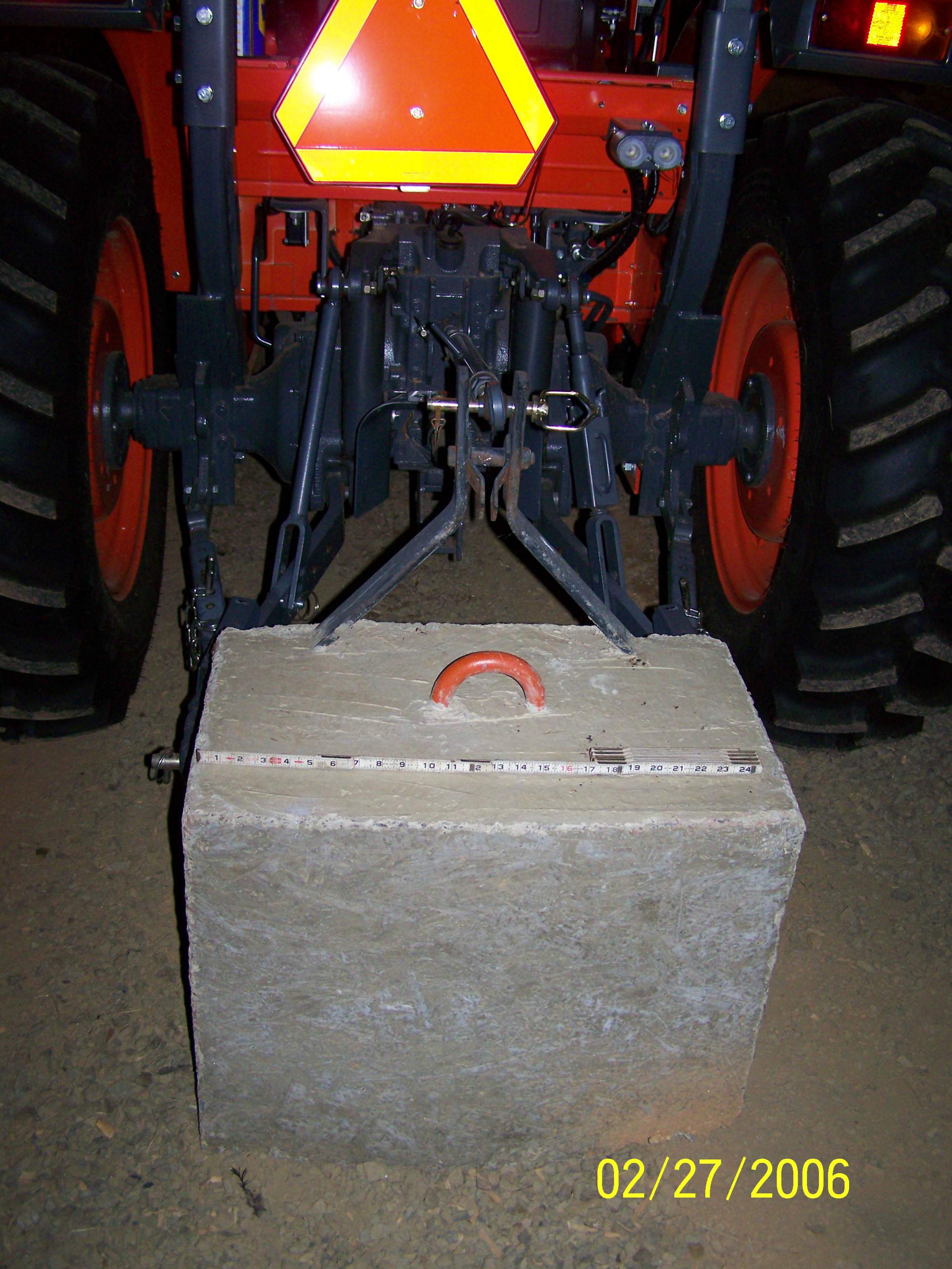

Here is my 800# counterweight. I used a 3PH frame from a junk Bush Hog, and welded re-bar to tie everything together. A friend suggested the lift eye. It was a good idea, because I can easly move it without hooking it up, and it lifts level. One thing I wish I done, was to have cast in a draw bar. If I want to use my chain harrow I drop the weight. If I had installed the draw bar I could drag with the weight on.
Bill
/ 3-PT Concrete Counterweight #39
You may want to run the max tire pressure with that weight.
/ 3-PT Concrete Counterweight #40
Bill
Nice! Do you find it performs well with your setup?
I can lift mine with the upper arm attachment...I welded numerous pieces of rebar to it below the concrete...it isn't coming out. My weight actually balances on the lower arms as planned but when lifting from the top is not at a balance point.
I can tell by your picture your rear tires could be spread wider by adjusting the rims. Did that to mine and made a world of difference from being tippy.
