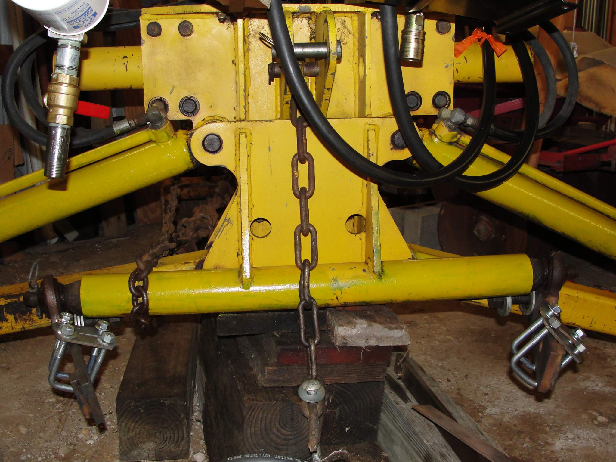

Go to your local JD, Kubota, Case or Kioti dealer and ask them if they will warranty the tractor if you attach a 3pt mount backhoe. Pretty sure all manufacturers will void warranty if a 3pt back hoe is used. But check yourself.
If you watch a person operating the machine with a 3pt bh. Get to the back where you can see the axle. Now squat down and watch as the machine picks up a full bucket of wet soil and swings it 90 degrees to the side. The tire on the swing side will dip slightly. when the bucket dumps, the tire will pop back up. That motion is caused by the elastic flexure of the trans / differential. It's more difficult to see, but if you watch close you will also see a smaller dip and raise of the middle of the machine as the hoe digs and moves dirt. Those motions are not good. Over time, they start cracks and cracks only grow -- never shrink. That same motion is seen in all TLB's, even industrial ones with frames. But the stronger the frame, the less motion and the longer the life of the equipment. Obviously, no frame at all is the weakest configuration.
Industrial TLB's have in the maintenance schedule a close inspection of the frame, trans, diff and mounts for loose bolts AND CRACKS. This is done about every 500 hours or yearly which ever is shorter.
This is a TLB with frame and a cracked bell housing that was repaired and cracked again.
This is the same TLB with a cracked, repaired and cracked again differential housing.
I know because I am the one that had to do the repairs.
Both the trans case and the differential had to be discarded and replaced. Pretty sure continued operation would result in what the is known in Latin as, "Tractorus Breakus Apartus" ;)

There has been several examples of broken tractors over the years here on TBN if you want to search. Most if not all compacts aren't beefy enough to take the stress of a hoe. That is why the manufactures won't warranty these accidents without having a sub-frame. The regular full size Ag utility tractor can usually get by with a 3 point hoe if recommendations are followed. Such as adding a lock out bracket if the tractor is equipped with draft control. Some have other issues that need to be address.
/ 3 pt Backhoe #31
"How was breakage accomplished" . I intend to avoid torturing myself trying to fabricate a 755 subframe or buy the one Woods makes for the 790 and doing a nasty cut and fit job. Any other comments on the amt of abuse a 755 can take w a 3pt BH would be welcome, and please answer Q re the stabilizer link chain. Thx again Gus
If you have a woods backhoe you can make a clean cut and weld of the woods subframe for a JD 855 and it will be a professional looking job and will ensure that the 755 wont develop problems. The rear of the subframe will fit the 755 perfectly and any woods backhoe will bolt right to it. According to woods even the newer curved boom ones will still bolt to that old subframe. I cant verify this as mine is very old and was new about the same time the JD755 was new.
The stress from aggressive digging will do more damage to the 755 without the subframe than the explanation you got from your dealer about going too fast threw the field. The actual weakest link is the weight limit on the rear axels in his scenario not the frame! Which by the way it does have a frame under it. Just get under it and look.

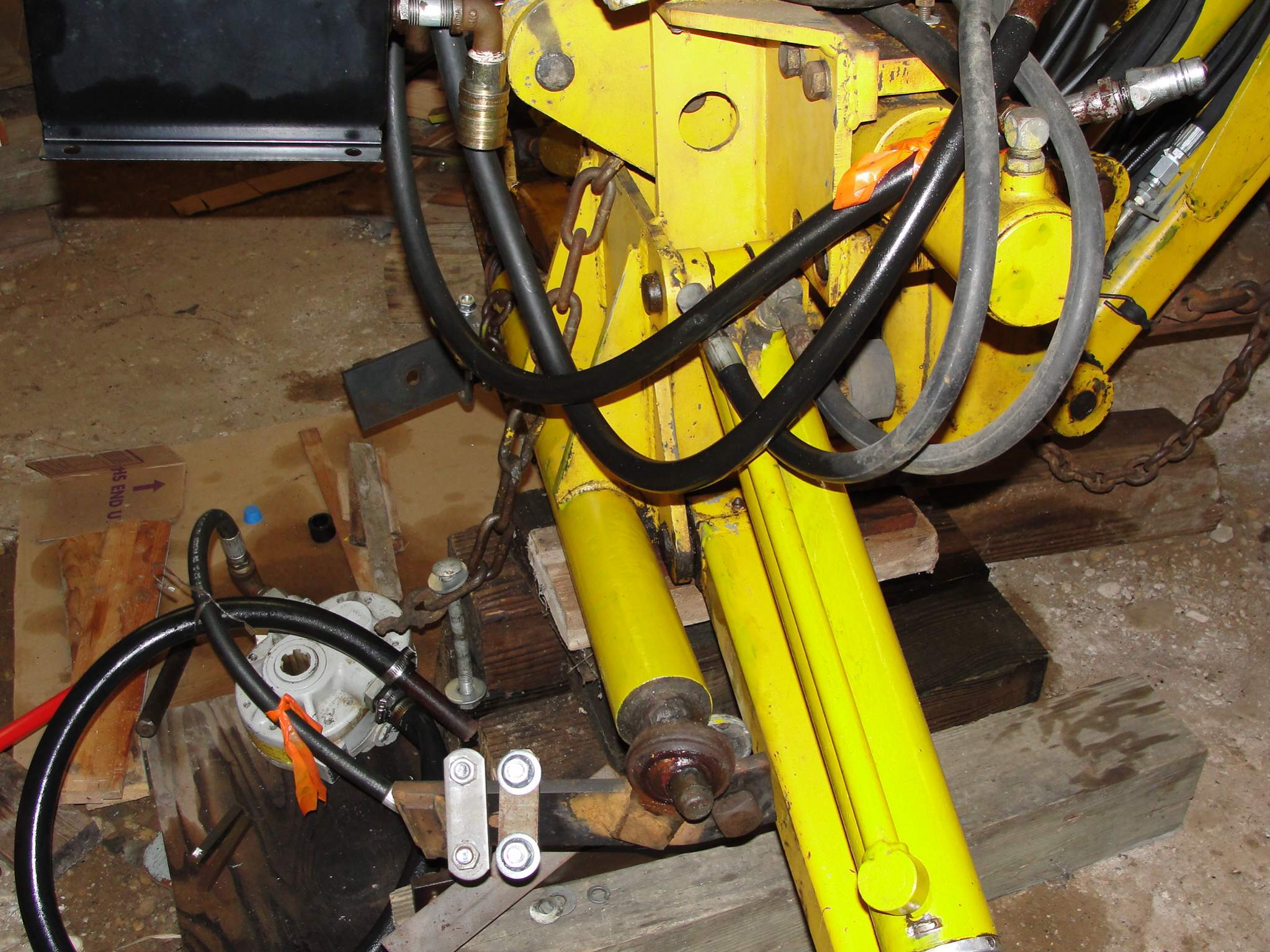

Suggestions? Yeah...don't put a 3pt backhoe on it ;)
Putting it on a quick hitch would be even worse. The farther the backhoe stick out the back, the more leverage it has on the frame/transmission connection which it taking all of the stress. You're essentially hanging the backhoe on a long level and letting it bend the tractor in half. Subframe mounts distribute the stress evenly across the frame/transmission case/differential, and that's why they don't break tractors in half.
