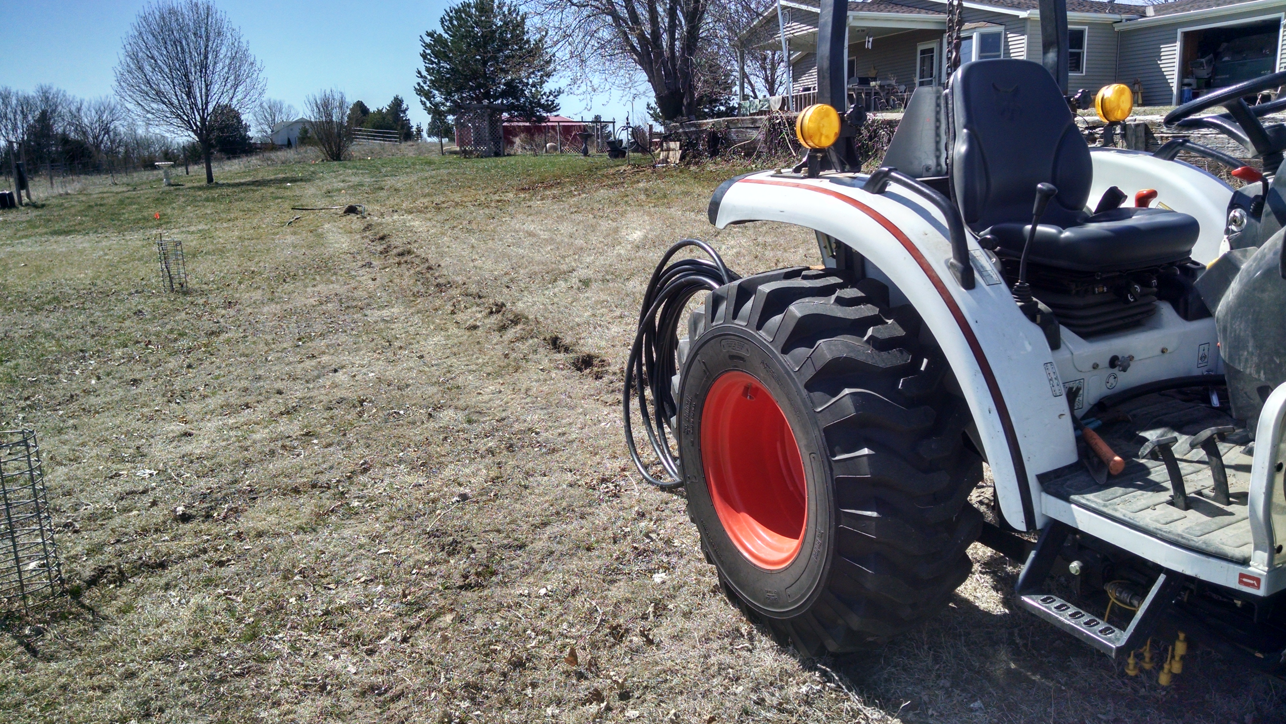

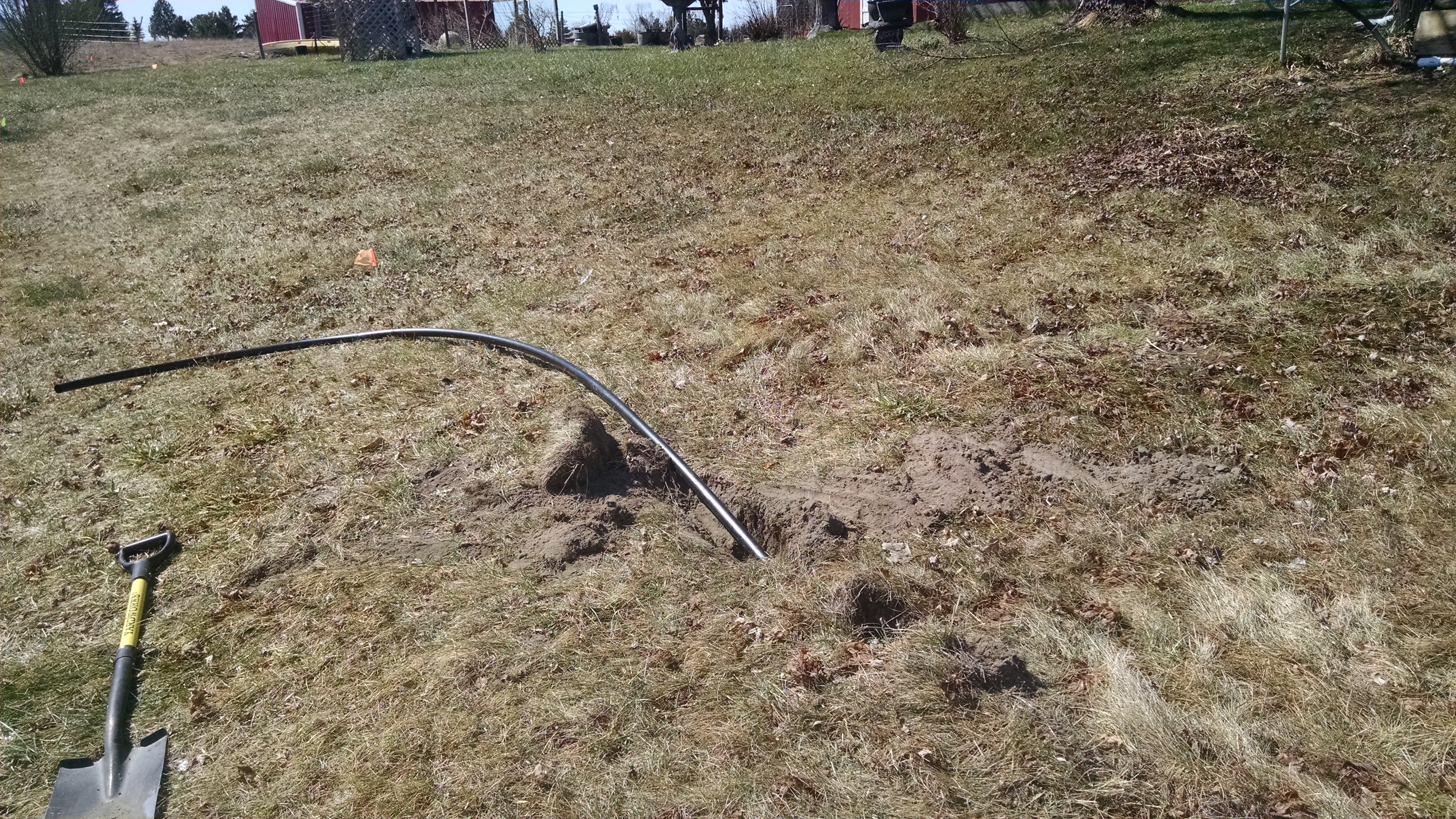

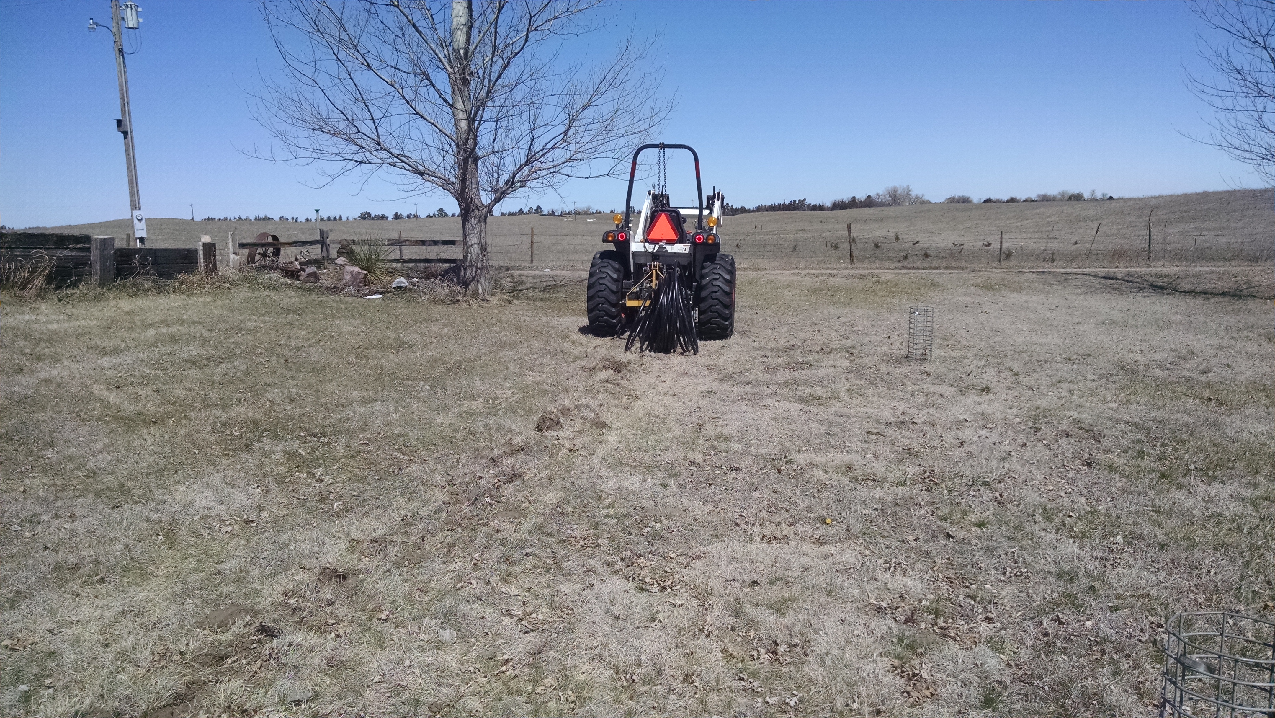

Hi guys did trench in some pipe this weekend worked well I took the shovel off the middle buster and added shank off my box scarper . This set up buried the pipe about 2ft deep which was just fine for what i was doing. Trenched in about 400 ft of pipe in no time at all didn't hardly leave a make above ground.

   / 3 Point Single plow #14
Looks like you did an excellent job although I don't understand exactly how you fed the pipe in there? :confused3:
   / 3 Point Single plow #15
That's what I am wondering as well. How did you feed the pipe in and especially how did you keep from kinking it as you went.
   / 3 Point Single plow #16
The way I've seen it DIY'd is by using a PVC 90 long attached behind the blade of the middle buster. The wire/pipe is fed through that.
#17
I will try and get a pic of what i did. I put a small piece of chain around bottom of my ripper shanks and feed the tube threw it and started pulling worked great and fast.
   / 3 Point Single plow #18
Did you have a helper feeding out the tubing as it was pulled? I've rolled out 250 yards of 1" polyline and it was a huge pain to roll out and keep from kinking.
