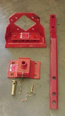

Your question was somewhat confusing. I couldn't figure out if you wanted the receiver hitch to raise also.
If you wanted a fixed drawbar, there a several aftermarket drawbar kits available for the 9N, 2N, 8N series. They simply bolt to the underside of the rear end. Their cost is around $120, last time I looked. You could weld the receiver hitch to the drawbar.
This would still allow full independent use of the 3-point.
If the receiver needs to be raised, then get one of the 3-point receivers as previously mentioned, and be sure to use the sway chains and bars.
Here is a picture of the kit. I had one on my 8N. Much better than the 3-point for towing.

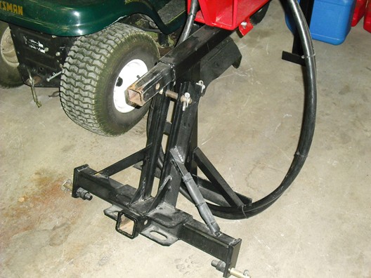

Here's the one I built. I can post better pictures of it want to see more detail.
/ 3 point receiver hitch idea's wanted. #10
The reason I want to make this hitch is while trying to back the woodsplitter up in the woods, the hitch will swing sideways and this makes it very hard to manuver in tight places. Then after the splitter moved into the working area, I want to use the 3 point to skid logs and I don't want to go through all the bother of putting the sway bars on and off.
You need to shorten your sway chains.
Look at a smaller compact tractor if you can. Or look at the picture Kebo posted. There are chains with a turnbuckle that go from the 3 pt. back to a point along the same line created by the pin where the 3 pt. lift arm hooks to the tractor. This allows the lift arm to raise and lower freely, but keeps the 3 pt. from moving side to side.
I accomplished the same thing as a retrofit by running a turnbuckle from the right lift arm back to the left pin and visa versa. This X created the triangulation needed to keep the hitch from swaying, but allowed free range of motion without buckling or binding.

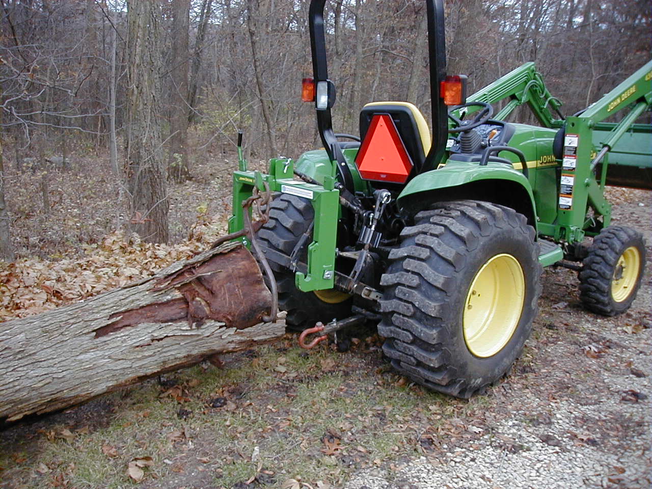

As to why/what questions we use the tractor to pull the logs to a working area. I like to use a "short chain" and lift the butt end of the log to prevent it from digging into the ground and also it adds some weight to the back end of the tractor. Then I use the loader/forks to pile the logs. (The pile in the picture is pretty small compared to some of our cutting areas.)

Besides, the way you pull logs in, you should have something other than the 3pt drawbar, and more like a quick hitch on the 3 point for dragging in logs.
Something like this.
