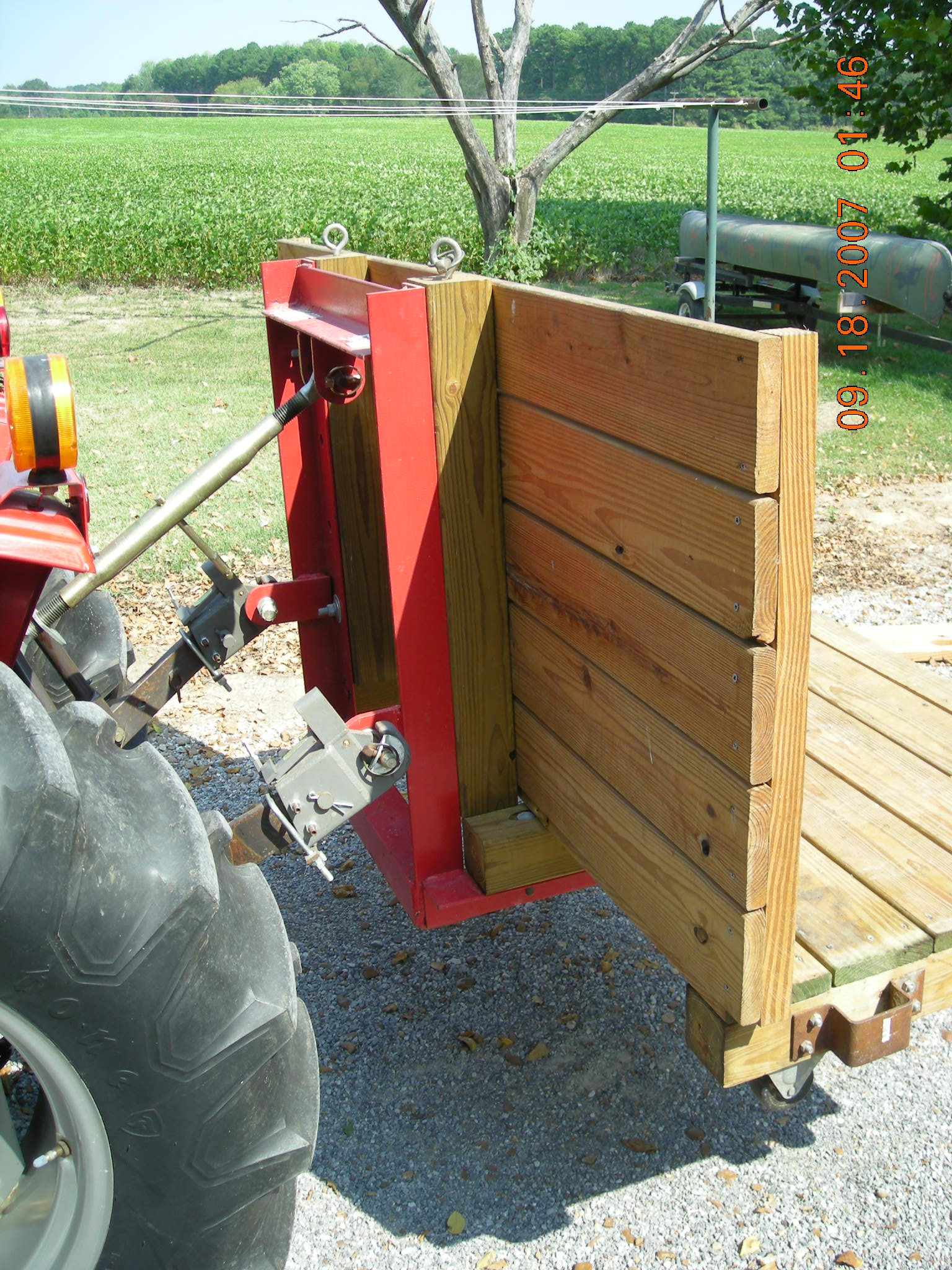

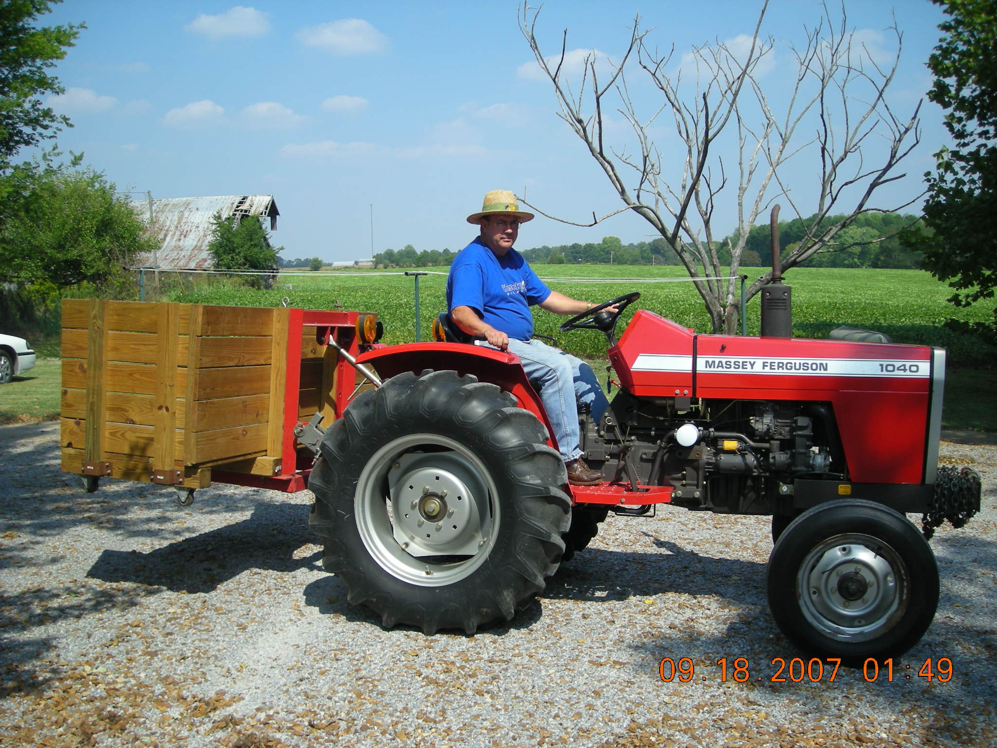

I use a Pat's system. not a perfect solution but other than having someone else change implements for you, I don't think there is a perfect solution. I like the Pats system. You will need to go to a longer top link for most implements. Mine works well on my lifter(see pic) and on my woods RD7200 finish mower, box blade, bush hog, disk, and 2 bottom plow.

ae ted,
nice looking carry all. Do you use that for firewood? Any more pics and info of your carry all, thinking of making one myself.
Thanks
/ 3 point quick hitch on MF compact. #16
ok here are some.
