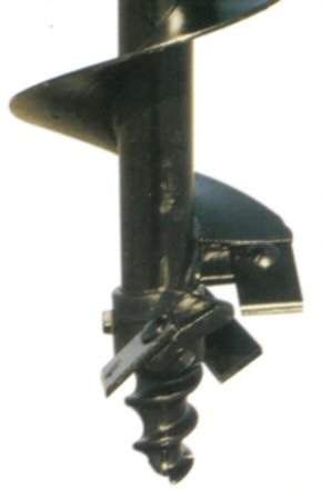

I have a bushhog PHD with a 12" bit like Whistlepig's. No down pressure rig. Cuts holes easily here in my clay soil. Goes through shale pretty good. And big roots are simple cut right out of the way. Same with big AC power cable (not my fault). Miss Utility...... well they missed and I didn't.

Gittyup and Gil, Thanks for the help. Are there teeth on the front edge of the augers that cut thru roots and powercables? Some one had done an very nice job of adding one in a previous post. Now if you could just get a nano jackhammer on the front edge for those fist sized rocks.........
