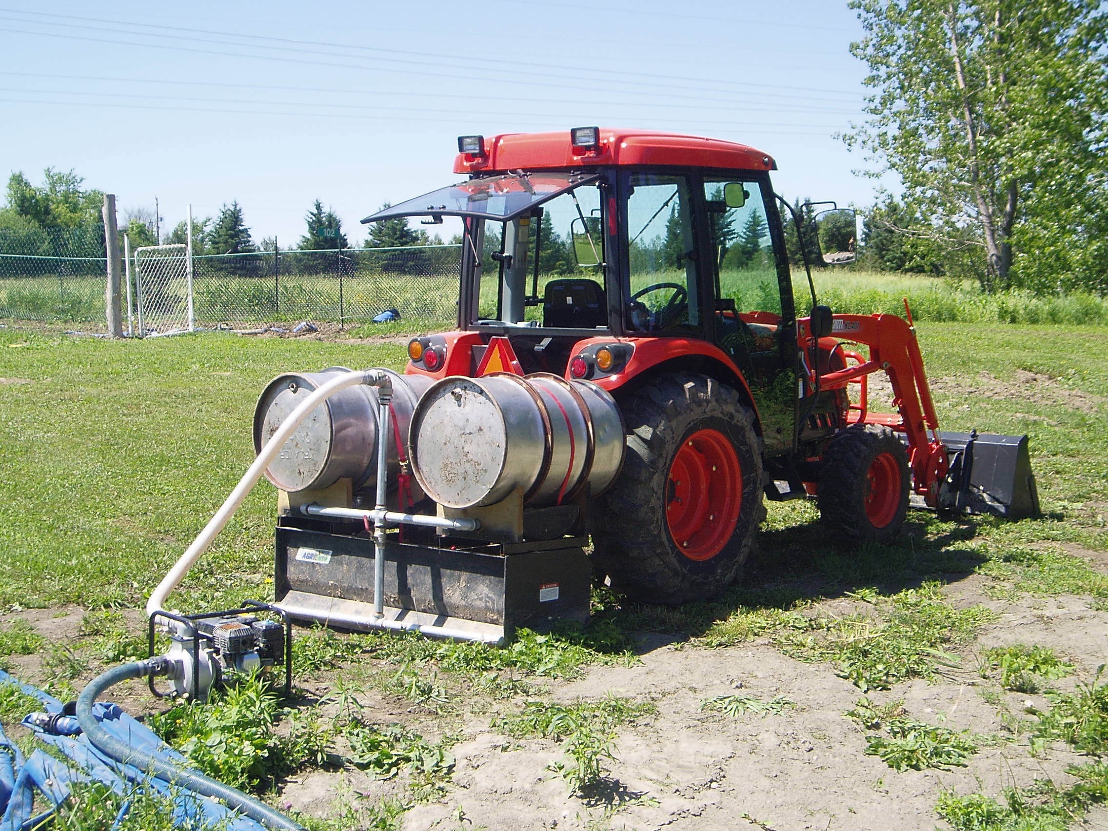

Well the rink is as big as I can make it without having to level more ground, 120' X 65'. Every year I sit back and figure out what took the most effort/time and then go about improving it for the following year. The only way to get a really good ice surface is to get every last flake off it before flooding it, which is why I use the broom. This year I took the rear blade of my box blade off, sharpened the front blade on my bench grinder and the zamboni is built on the top. I pump water from a creek in the back, first using a fire hose and then later in the year to fill the zamboni. We replaced the wood stove at the cottage, so I brought it home, bolted it to a pallet, built a heat exchange out of 40' of copper pipe and a 20' coil and I stick it in the chimney. A little circulation pump draws from one tank and dumps it back in the other one. I've done many many many other crazy things for the rink, but I'll leave it there. We all enjoy having the rink and it gives me seat time in the off season.
No pics in the winter with me, but here's the zamboni in the summer, minus the water bar.
