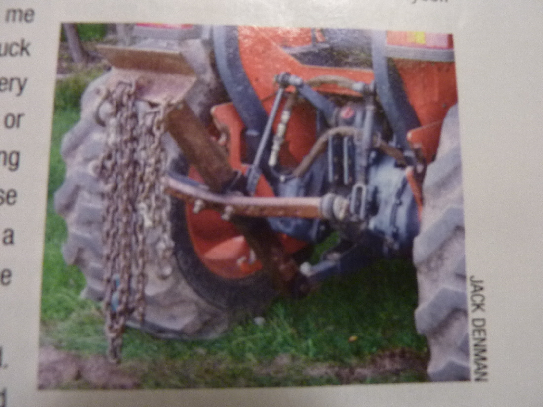

After going through the TBN search engine, looking at images on-line, then looking into my wallet, I decided to make a 3 point log-skidder for my light forestry operations. I usually skid 12' Big Leaf Maple and oak. On occasion, I skid 16' - 20' fir logs. I have 15 years before my wood-lot is ready for wide-scale harvest again; by then, I will have some type of 3 point winch, perhaps a Farmi.
I'm pulling with the draw-bar and lifting with the arm-spacer bar now and it works pretty well on the "flats" and "straights".
I would like the operator's hands farther-away from the logs when detaching the chokers, a little more play at the front end of the logs, and I also want to use the upper link to do something too (not just sit there while the draw-bar & lifting arms do all the work).
Thanks to everyone on TBN for the previous posts here is what I came-up with; 2" square tubes properly welded. I don't have any measurements yet; still in the take-off phase.
I would appreciate any words of wisdom; particularly on the nomenclatures of the types and thickness of metal I should be shopping for.
Thanks.

Your design pictorial looks rugged. I see square tube and flat bar stock the way you have it drawn. You don't show demensions but I am thinking the way you have the lift point for your chains above the top link you must have some fat logs to pick up. I would be concerned with the chain connection point that high up if your logs are heavy. That is unless you know that it will be OK from previous experience. You would be better off (safer) if you could make it lower. ie between the top link and lift arms.
Here is a different type of design that you can get a high lift yet all the weight on the tractor is kept low, on the draw bar and lift arms. Nothing on the top link as it is unused. There is very little force to tip the tractor back with this hitch compared to one that employs the top link. This guy lifted some heavy stuff as you can see.

You don't get all that for free of course - there is always a catch. I can see you understand levers so maybe you already see it. The draw bar pivot is the fulcrum. The liftarms provide the lift with a shorter lever arm than the log. So the max log weight will be less than what you could pick at the end of the lift arms. Max log weight depends on your geometry. You give up weight for height. Your tractor is about 2650 lbs at the lift arms ( I think ) so even at 2:1 you got 1325 lbs available for the butt end of the log.
You don't have that trade off with your initial design.
EDIT; For reference a 16 foot green red oak that is 24" in diameter average weighs 3200 lbs. 18" dia is 1800 lbs.
I'm reading your post and using my index fingers as a method of understanding the mechanics :laughing:.
I now-see the fulcrum being where you call it at; the draw-bar, thanks.
You entire post makes a lot of sense!
If the boom floats on the spacer bar as it rises and falls; lifting the spacer-bar should shorten the boom's length; bringing it closer to the tractor as it rises, measurably increasing the lift-capability (off-setting the trade-off by 5 or 10%).

I actually set the attachment point for the chains lower than the top link to reduce stress on the top link. The lower arms are much much stronger than the top link and are designed for pulling, the top link is mostly just to hold the weight of the implement. With the attachment point up so high, you are not only pulling entirely from the top link, but also also putting all the weight on it too. Just something to think about, would hate for you to rip the top link bracket out of your tractor.

That is beautiful (so glad I asked for wisdom on this thread); I didn't see that thread in the TBN search engine... Your craftsmanship is admirable; especially the right angles and welds, and you took the time to document the process.
My take-away is to measure how high my tractor will lift; make the adjustments Arrow mentioned then mount the pulling point as low as possible (and as short as possible).
