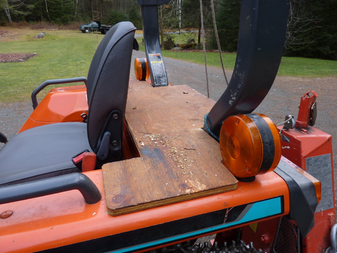

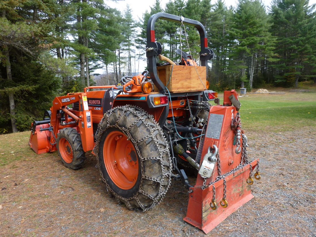

Apparently you guys are fortunate enough to be able to get right to the logs? In my hilly terrain, I can't do that so I need a winch to get the logs close. I had an old box blade that I mounted a HF winch to. It's slow, but it does retrieve the off-trail logs. I added several grab hooks on the box blade for actual pulling, and a chain box for storage. I can drop the box blade to help hold the tractor when pulling.
/ 3 Point Log Skidder #22

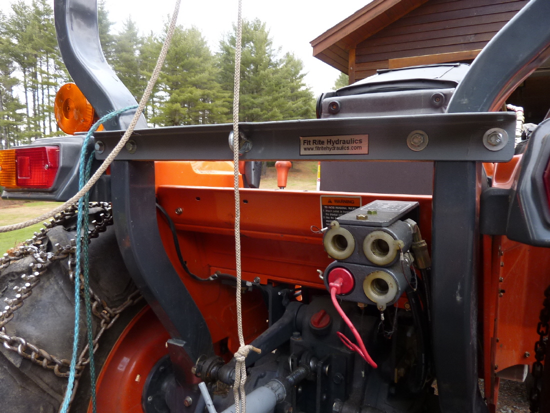

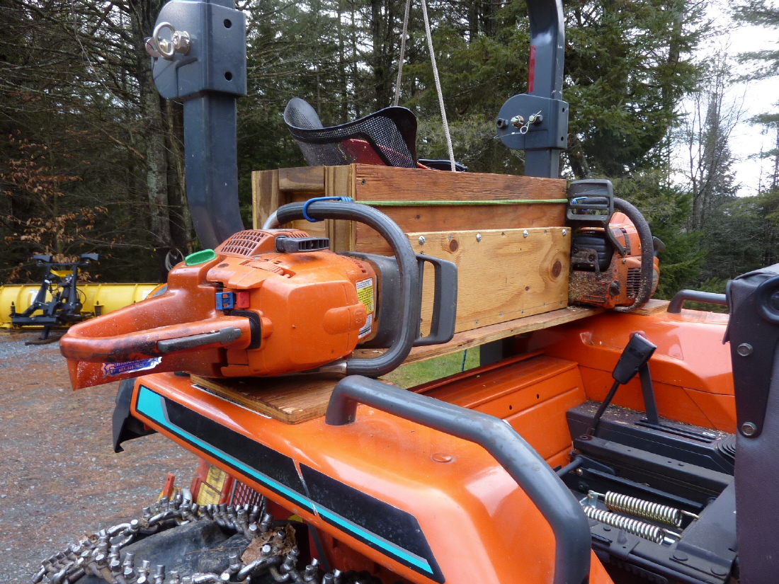

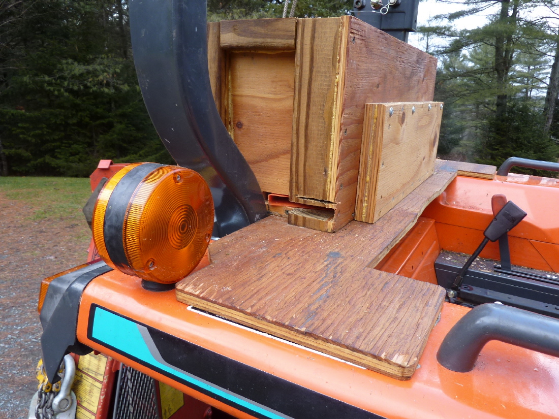

I built a box like this. All removable without using tools. I have a winch so chains go on that. You could make a slotted bar to hold chains like on the winch.

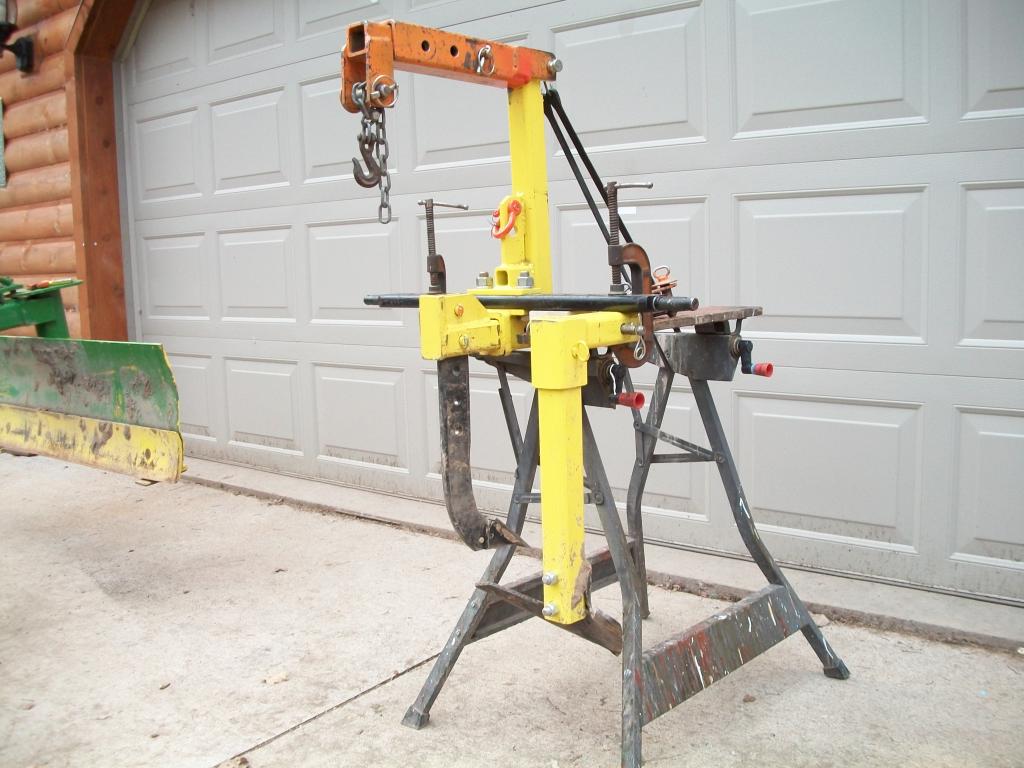

So, I'm gonna set this up and use for a while and see how it goes; dimensions TBD.
I'll post what dimensions I come-up with.
The draw-bar is the lower left; I'll use HD clevises for the links, the boom will float on the spacer-bar, perhaps 2 hooks to hold the chokers at the end of the boom.
I'll also collect materials for the initial drawing and also add a trailer-receiver.
Thanks for the great discussions.

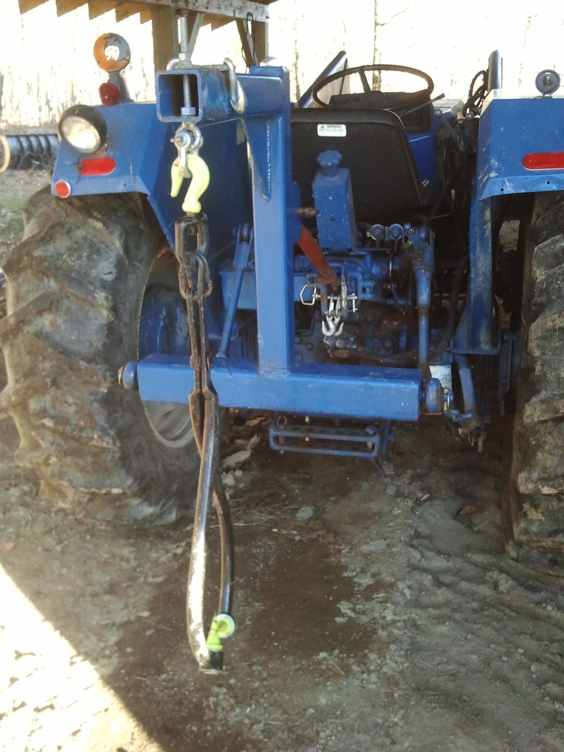

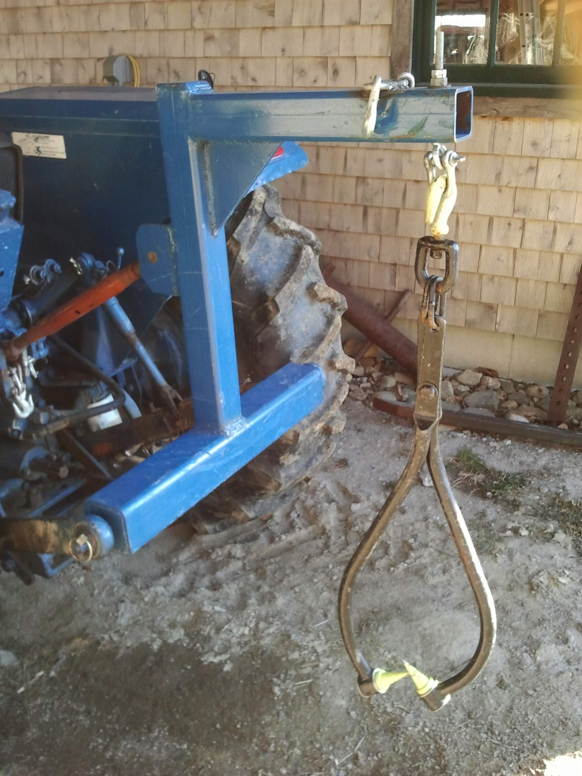

Here's one I made. very similar to the OP's design. I opted for log tongs and a couple of grab hooks for chokers, but basically the same. Works great!

I got a large portion of my project done today using some shop-floor materials and my original spacer-bar n pins. I didn't have any 2X2 tubing for the mast that will most likely have a short boom. Looking at welding the mast on top of the spacer-bar and running it up under the horizontal tab below the connecting link; then gusset a boom outwards.
I bought the hitch receiver in town for $11.
I found some nice 3 point hitches on-line for $70-$300, but I wanted to make this myself.
I'm always looking for ways to stay upright when working so being able to detach the chokers at waist-level would be great.
View attachment 355503View attachment 355502
The last bit of decision-making is to use a 36" floating boom that attaches to the draw-bar, floats on the spacer-bar, and passes through the base of the mast; we shall see if I can find a 3" "I" beam or rectangle.

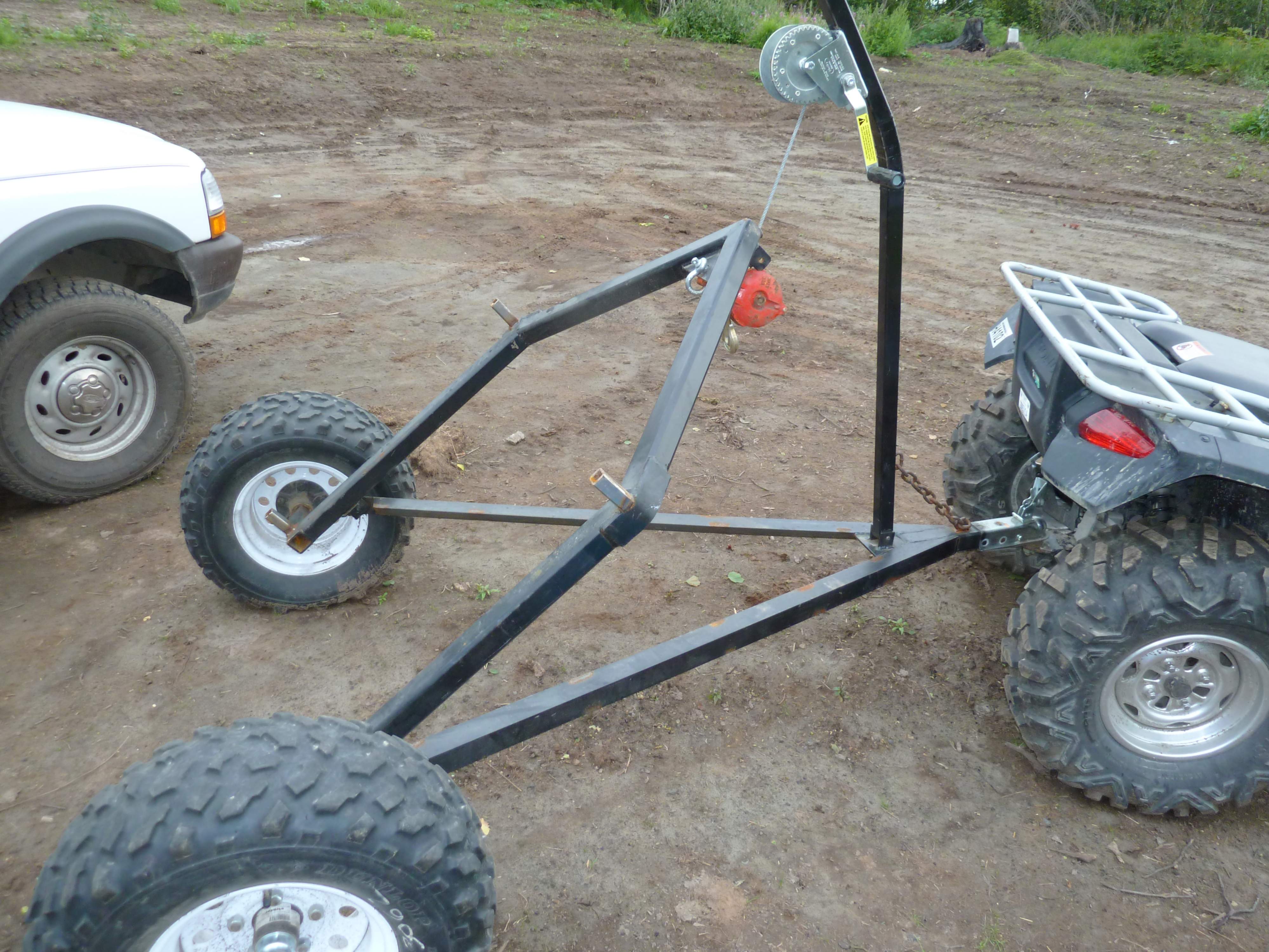

Log skidding arch is a great way to go; I have one I made for the ATV. It worked really well up to 24" diameter logs. The one thing that makes an arch "second" to a farmi-type winch or "high-lead" cable is the difficulty backing up to a log on the slopes. The small arch I made was light-enough for me to detach it and walk cross-hill or down-hill to a log for the hook-ups.

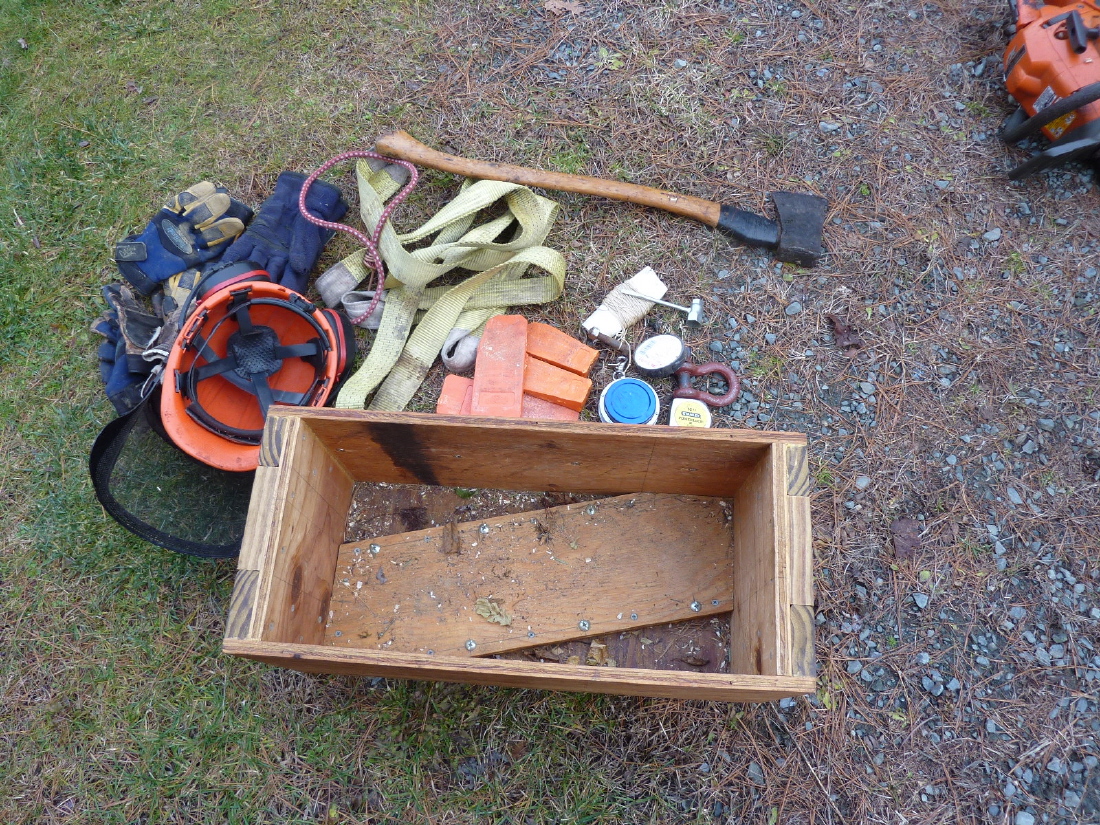

Here's mine! Also serves as my ballast box. Around 550 pounds.
