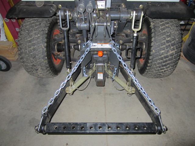

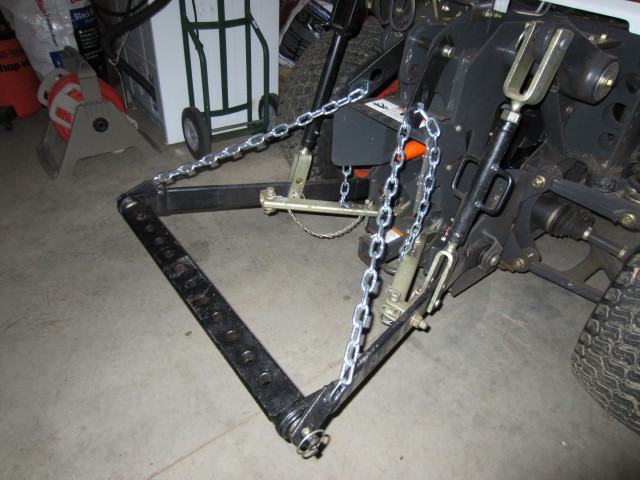

You can buy these support chains and set them for the height you want. The weight will then rest on the chains that attach where the top link pins to the tractor. Neighbor uses these for his old Ferguson.
View attachment 604719View attachment 604720
https://farmerbobsparts.com/deck-stabilizer-kit-fits-many-rotary-cutters-such-as-bush-hog-land-pride-servis-rhino/
Also I believe refered to as "check chains" or "limit chains"....
This is also a solution that works for me as my small tractor does not have really good repeatable control....
