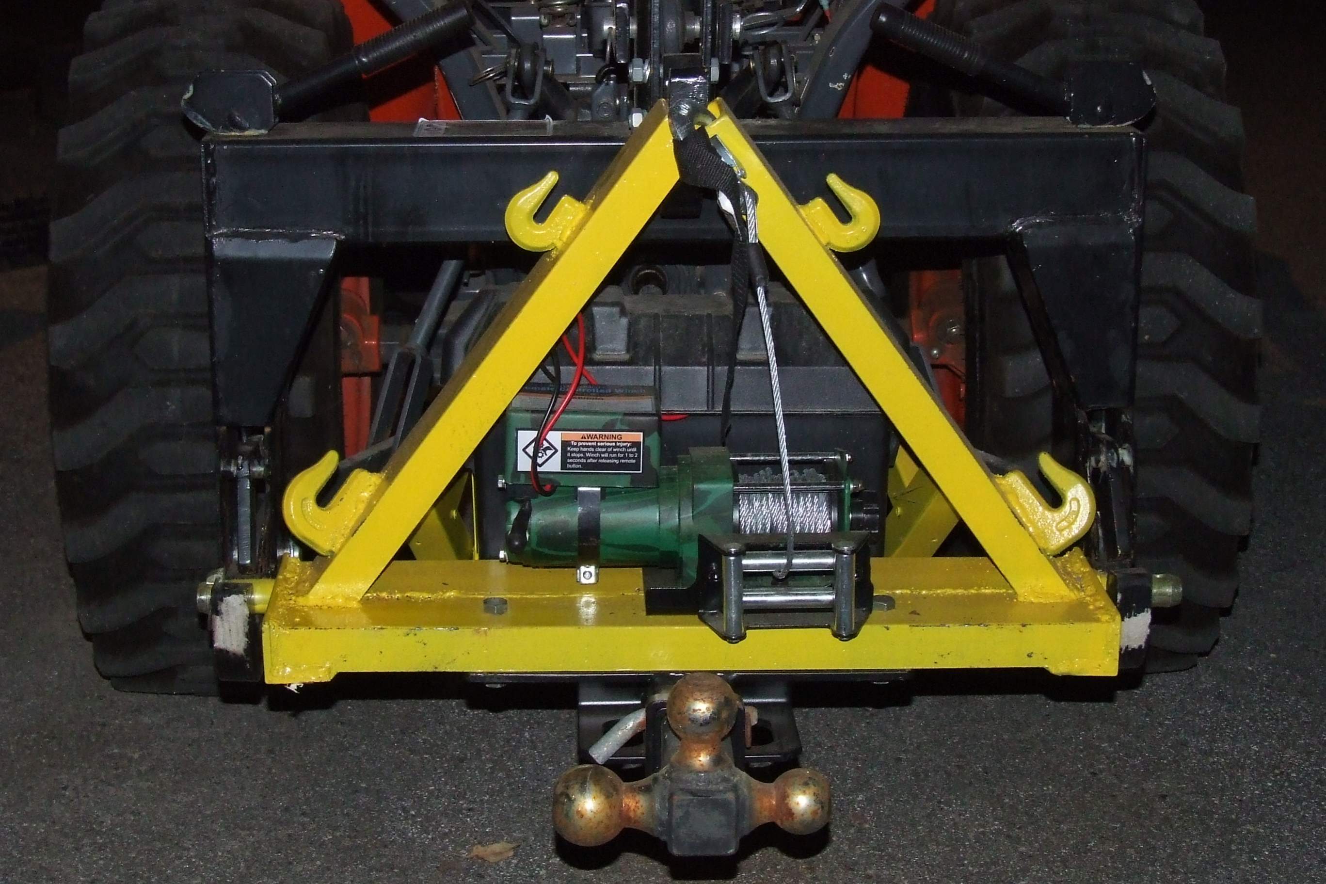

After reading Mudfarmer's thread this past Spring (http://www.tractorbynet.com/forums/build-yourself/165084-cheap-logging-winch.html), I figured I'd try my hand at fabbing a winch frame to attach to the 3PH on my Kubota 7610.
I liked Mudfarmer's idea of powering the winch with a seperate battery since my tractor only has a small dynamo on it. That, along with input from other fine folks here on TBN got me to the original design concept.
First I laid out the Quick Hitch points and then designed the frame using what was available: 3 inch channel and some bits of 2 inch angle.
I wanted to be able to easily run the winch off the 3PH and liked the idea of running it from a remote switch.
Armed with angles from the drawing, I used the power hacksaw at work to cut up the channel at the length and angles needed.

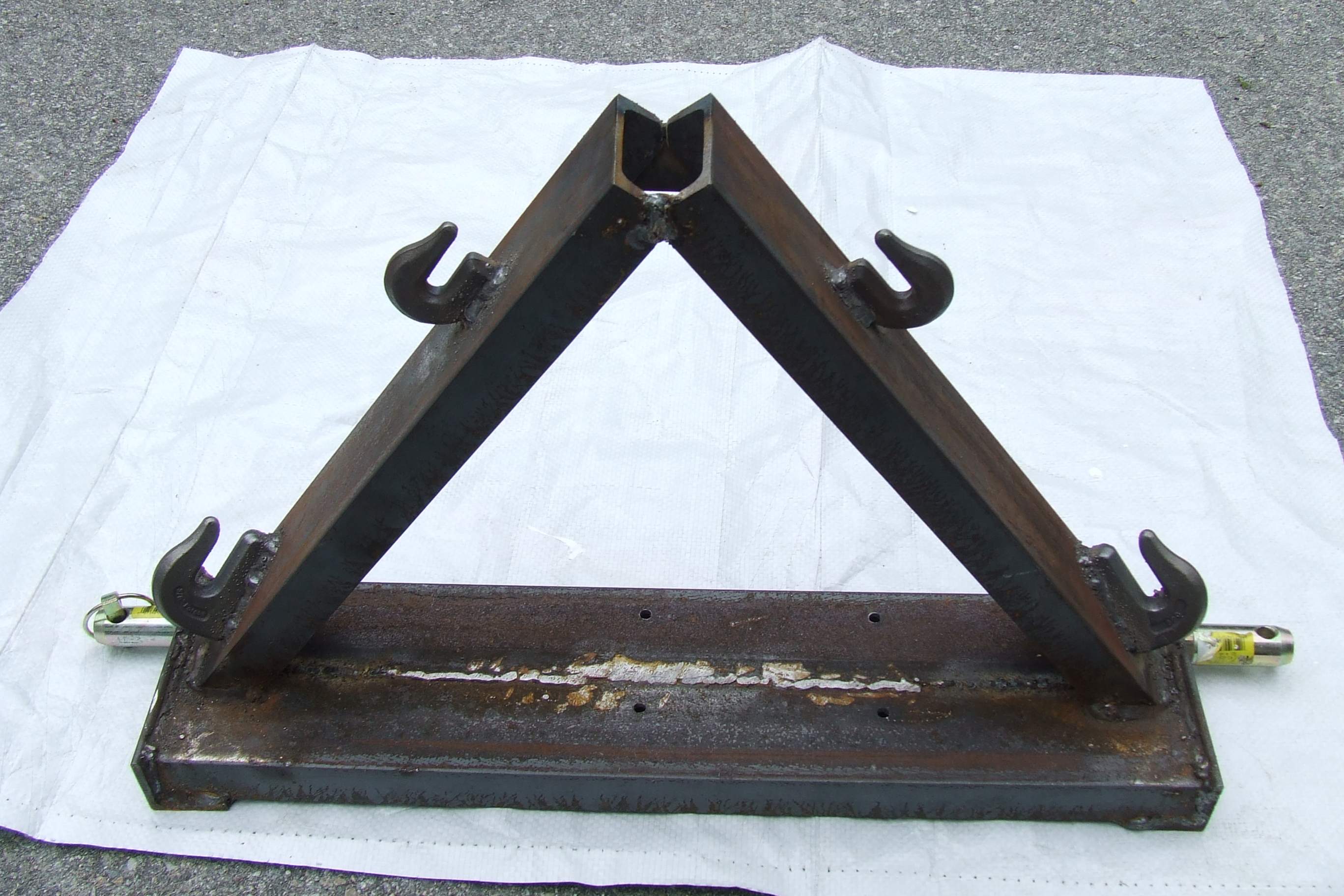

So now I had a bunch of cut up metal that was a bit rough, but I figured I could easily weld it with my 110V wire welder. :laughing:
It actually went together pretty well, with hardly any grinding to fit it together. I started tacking things together and with a lot of advice and encouragement from 4Shorts, it began to take shape. While the shape was good, the strength wasn't, so I brought it back to work and used an old Lincoln stick welder to get some better penetration on the welds in the heavier walls.
Around this time, 4Shorts was clearly concerned :) and decided to send me a LWH (Lucky Welding Hat). :thumbsup: This item, along with other similar good luck charms, helped get the basic frame in a somewhat put-together state as you can see.

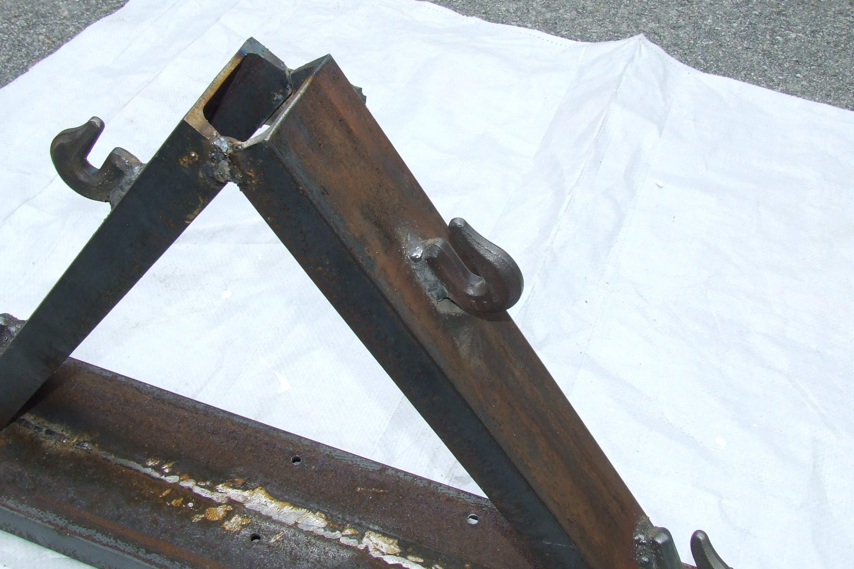

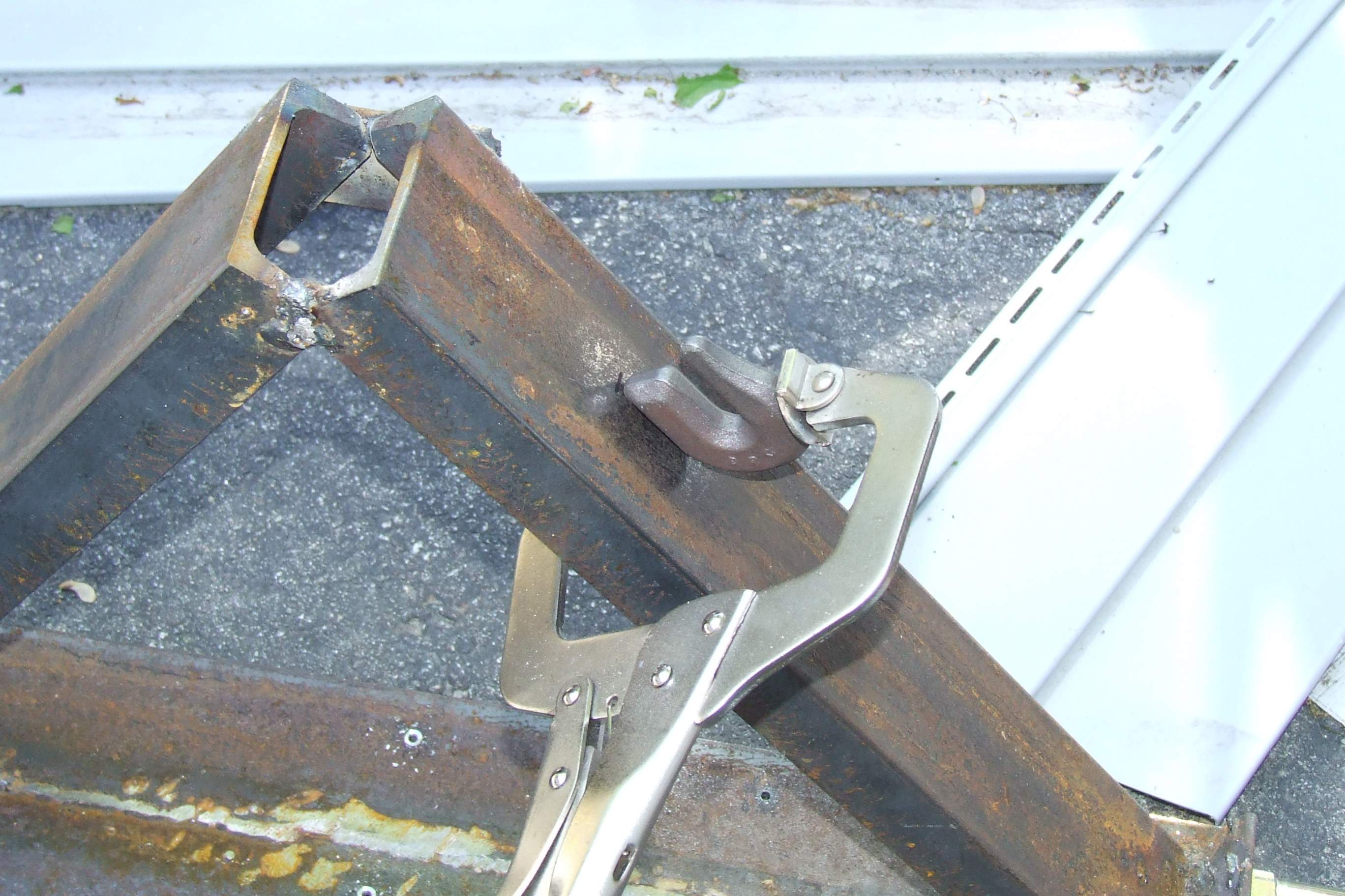

Another thread on TBN showed some way cool weld-on hooks for chaining stuff and maybe a little skidding. Tractor Supply had the 3PH pins, but I had to visit a heavy equipment shop for the hooks.
Not being happy with the 110V welder, Harbor Freight had a sale on a refurbished 220V 30 amp wire welder and I got it right away. (Honest Honey, I've had that for a long time now!:rolleyes:) The hooks welded up really well and the Lucky Welding Hat was paying off big time!:D
Just look at those welds! They aren't up to mjncad and 4Shorts standards, but the hooks will stand up.

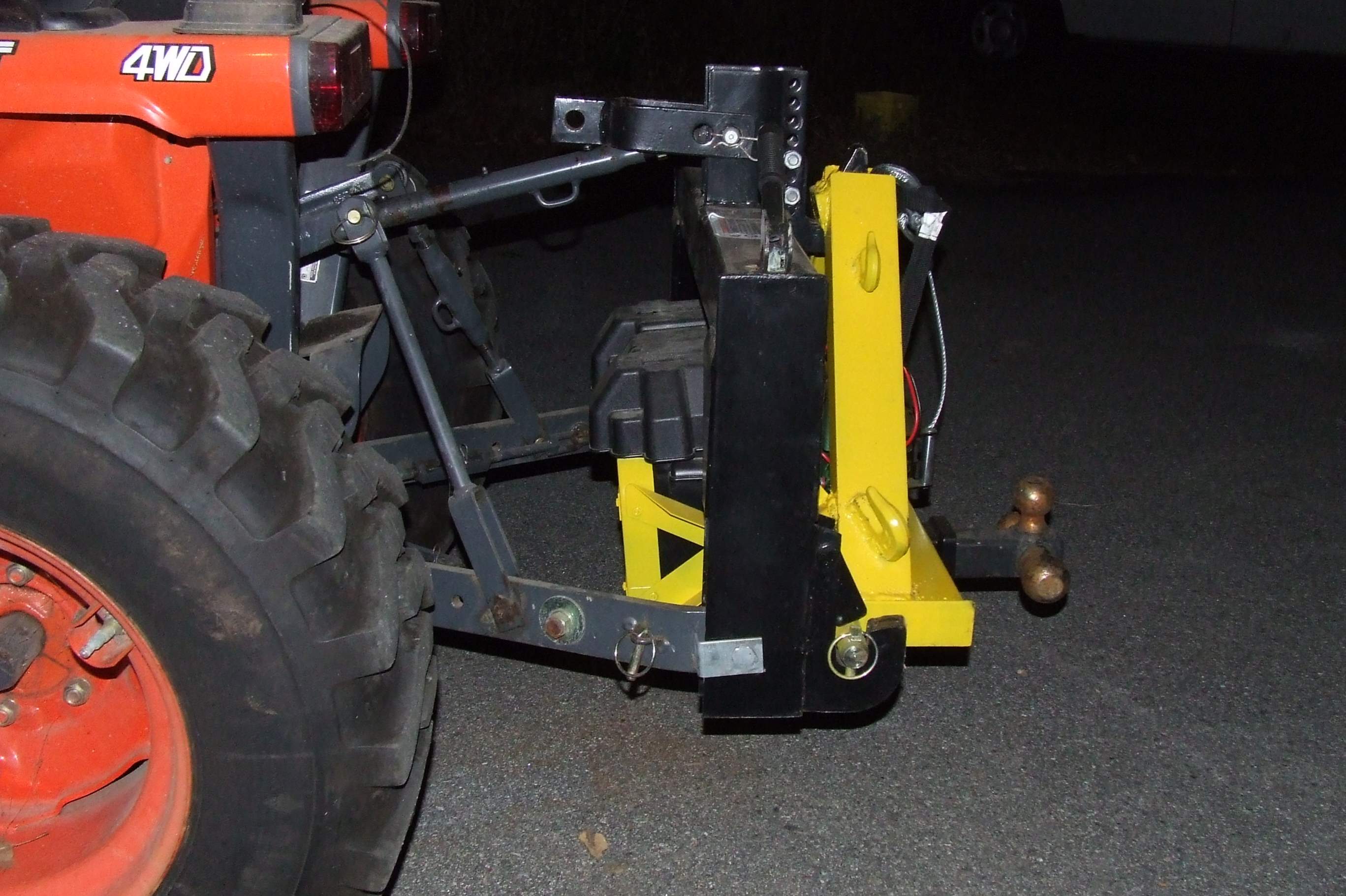

I wanted this piece to be multi-functional so I added a 2 inch receiver on the bottom. I chose a bolt-on HF special cause it was fast and allowed access to the winch mounting bolts. Mudfarmer really liked his little 3000# winch, so I went for one of those too. It's been fine for my needs thus far.
The last thing was to add a battery box on the back for a deep cycle battery to run the winch or the sprayer (as soon as I build the bracket that slips into the 2 inch receiver:eek:) At first I thought I over-built the battery holder, but after taking a running start to yank some bushes out, the box stayed in one place and didn't bang around.
Overall this was a fun project. I learned a ton and the whole thing can be set down, chained to a stump, and pull on it's own without having the tractor there. That works well when I need to drop a tree and tension it to a specific direction, but not have it hit the tractor.
I'll probably add casters. It weighs a fair amount!
Thanks to 4Shorts for his help and counsel during the build. That and the Lucky Welding Hat. :cool2:

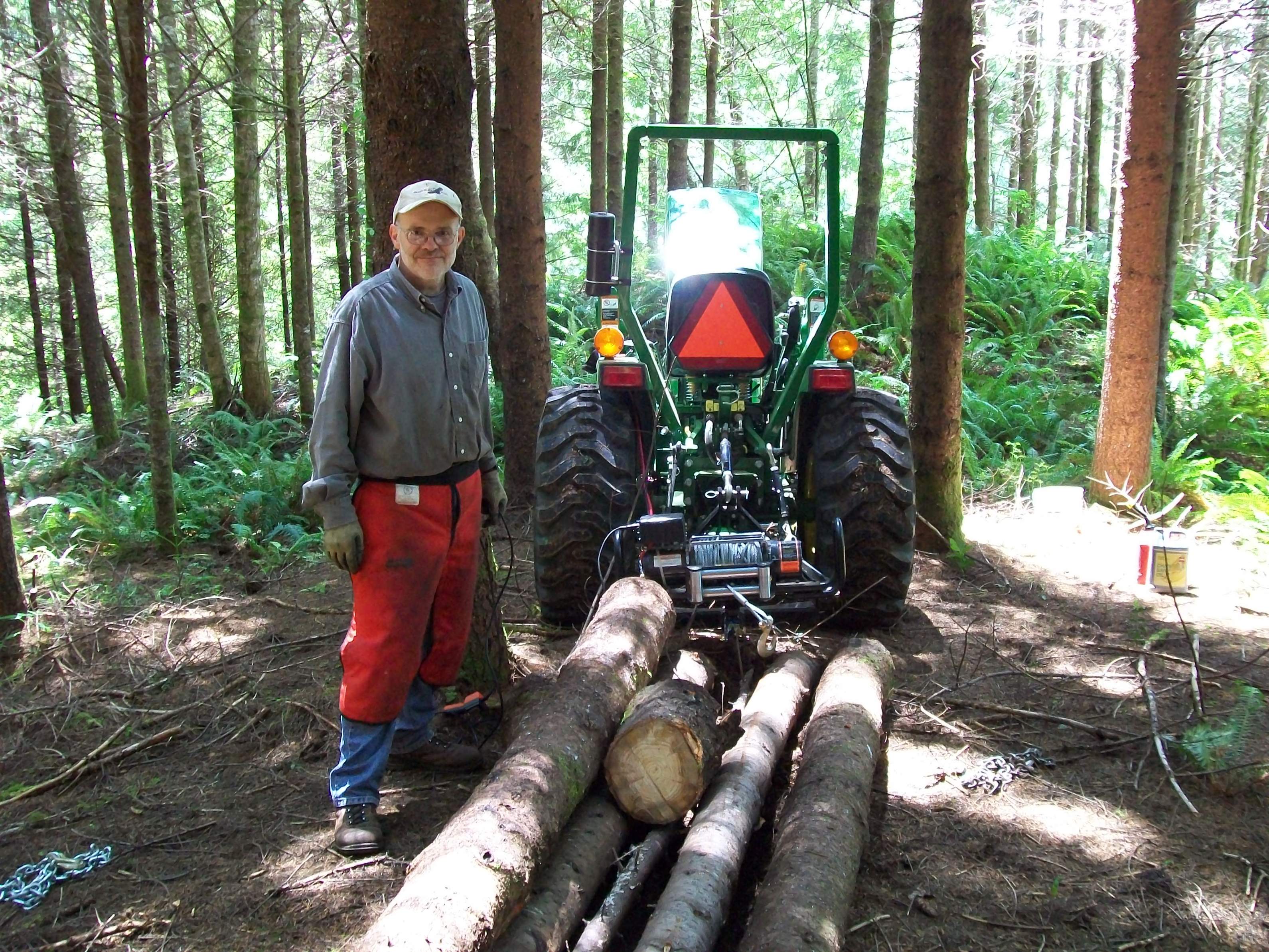

I like it!! I have found that running a 12 volt winch that calls for 660 CCA works fine on a 550 CCA battery. I keep the engine running at about half throttle. Currently using a harbor freight 8000# and it yards any logs I have tried it on. (Pulled the tractor back only once when a log hung up).
Haven't put a quick couple on the wiring yet - just pop the hood on the JD 3005 and hook the winch up with salvage jumper cable clamps hooked to he winch by 6 feet of 4 guage welder wire. I keep my winch on a HF 2 inch receiver winch mount so I can move it from one tractor to the other and to my Pickup if needed.
Just hooked a four inch receiver to the base of my boom pole. Just looking for a cliff to dangle it over. Pictures will follow when I have found some use for the latter. Seriously thinking about a hydraulic toplink to make my "crane" more versatile.

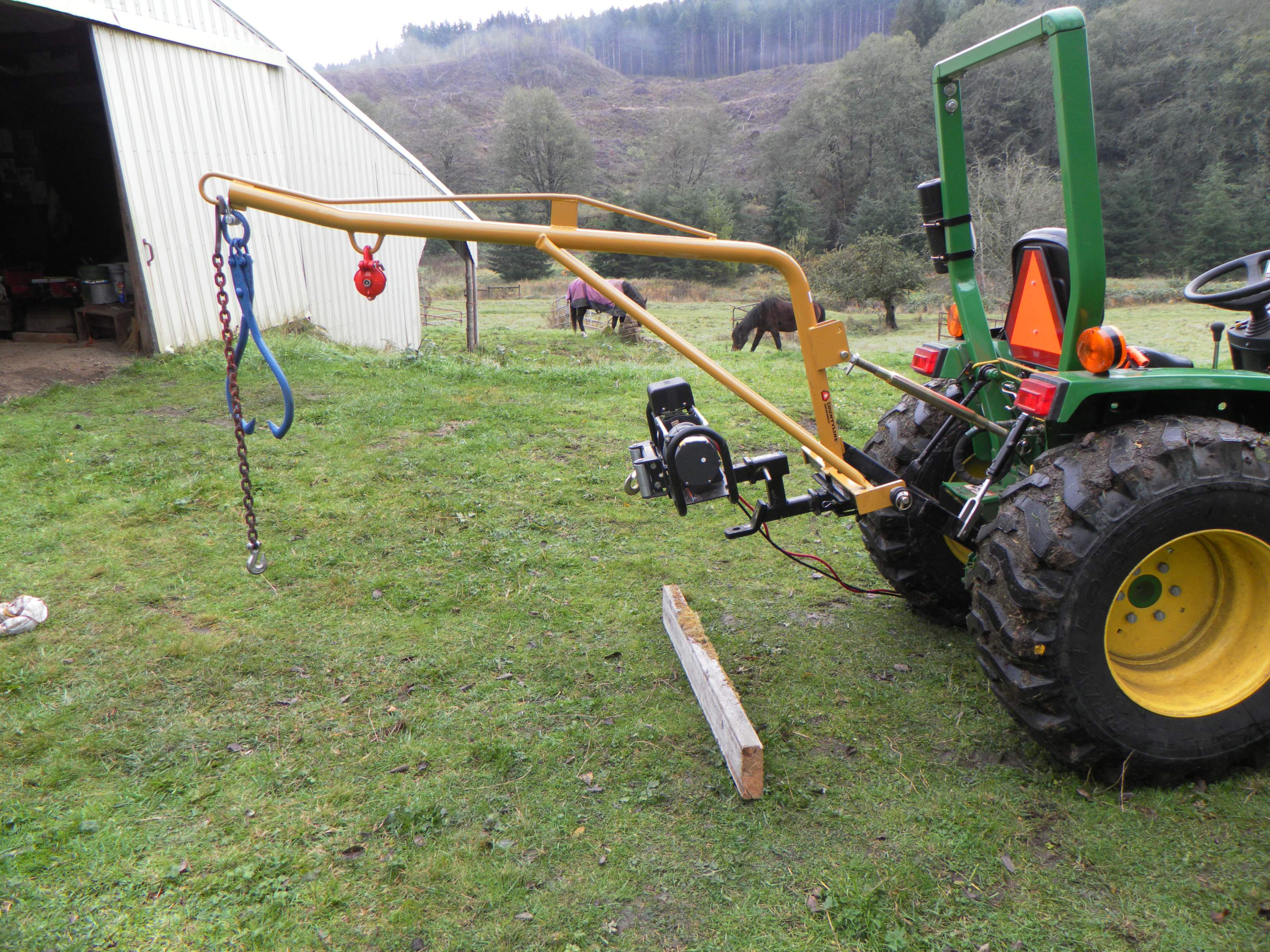

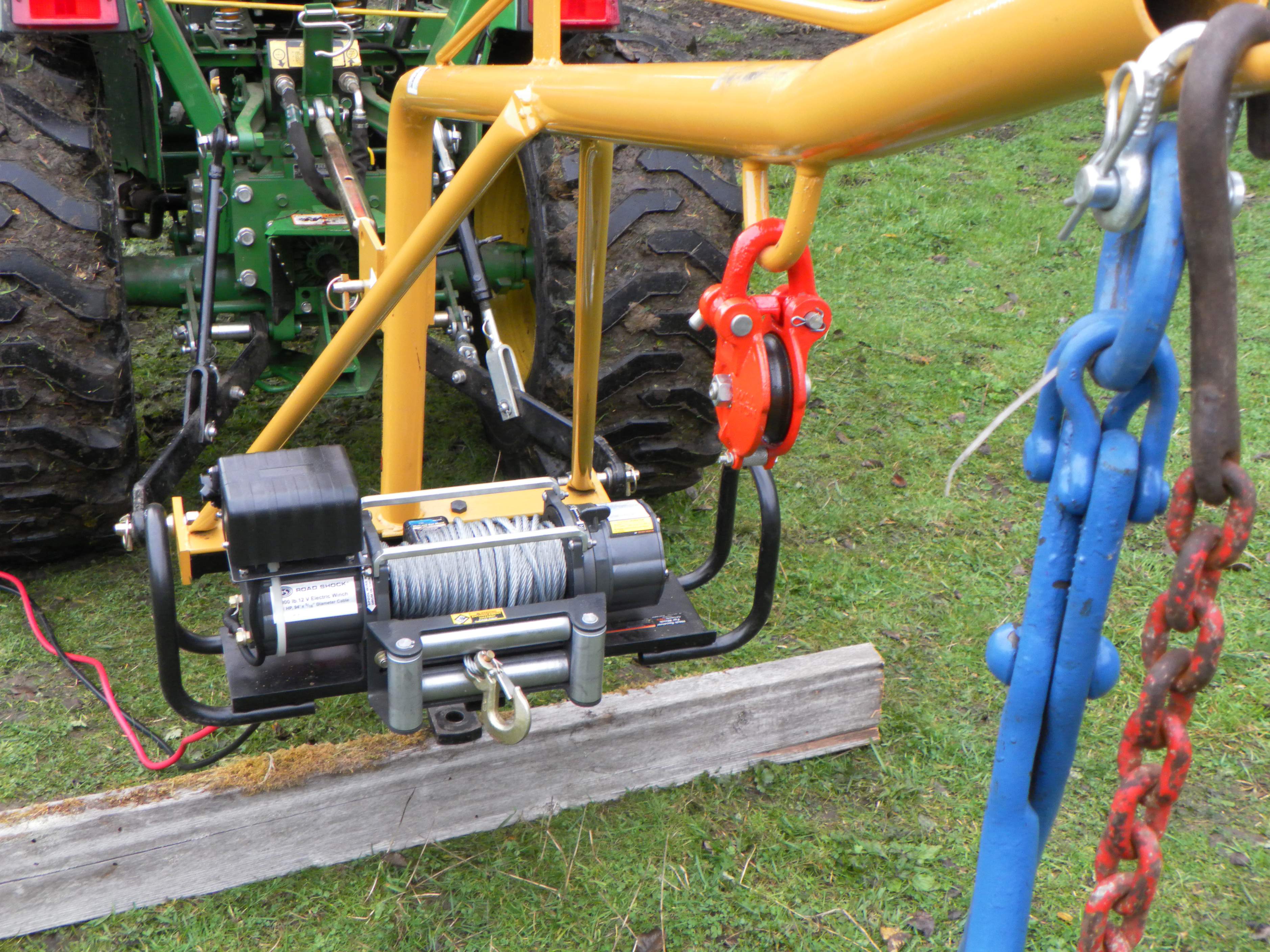

I have to admit that I haven't used the HF 3000# winch much. I decide to use that with my Kubota 7100 (small tractor, small winch) but haven't had anything to pull. On the other hand i have used the HF big winch a lot. The solenoid malfunctioned on the first one I had. The switch to wind in worked fine but the power out stopped working. I was able to finish the job by freewheeling, but found that can be a bit hard if you winch up too tight. In any event HF honored the replacement plan and I got a new winch. The first one was 9000# and discontinued. The second was 8000# and pulls wahtever I have. I like it a bit better since it has 3/8 line rather than 1/2. The former spools up better. I do have a roller fairlead more by default since it came with the first winch.

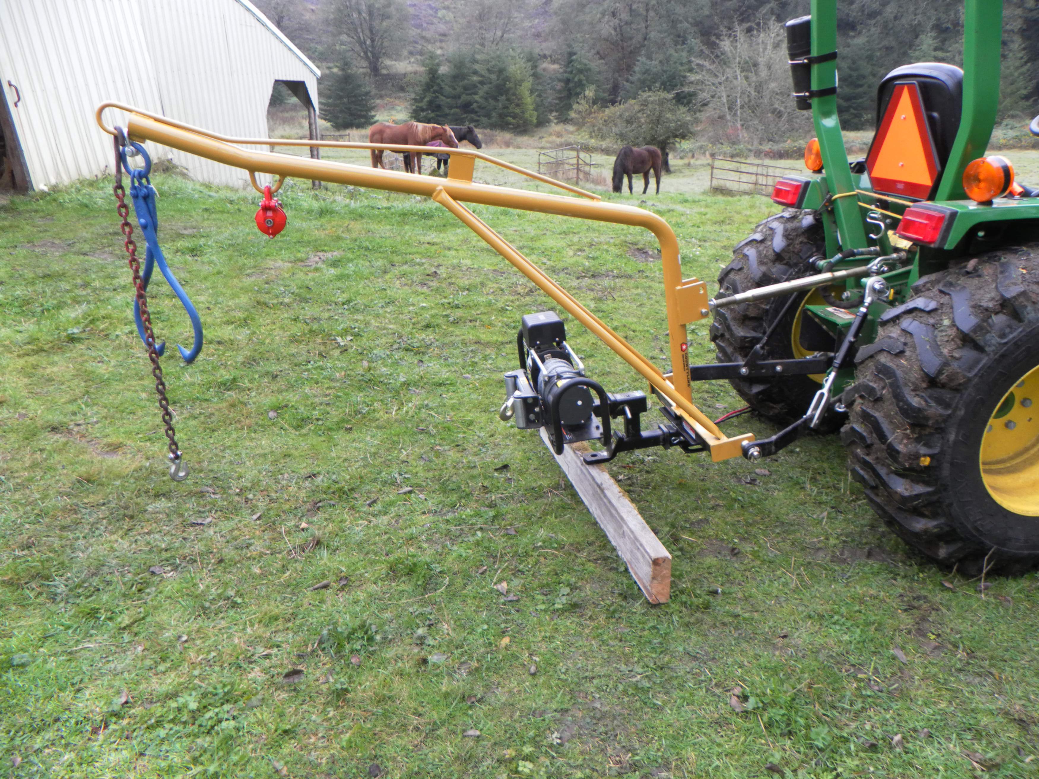

I have been using the winch mounted on an A frame like you have constructed. But as I mentioned before I am going to try it with a boom. Pictures of the latter attached. To be fully effective i think the boom needs to be easily adjustable at the toplink. I'm going to splurge on a hydraulic toplink I think. Although I haven't tried it yet, I am theorizing that by having the snatch block out on the boom that will make the winch reel in more symmetrically without having to carefully line up the tractor. We'll see. I am not sure how much weight the boom will take - certainly not as much as the winch. The tongs are more or less stored on the end of the boom for now. Take a look.

Another picture f what i know works
Mf

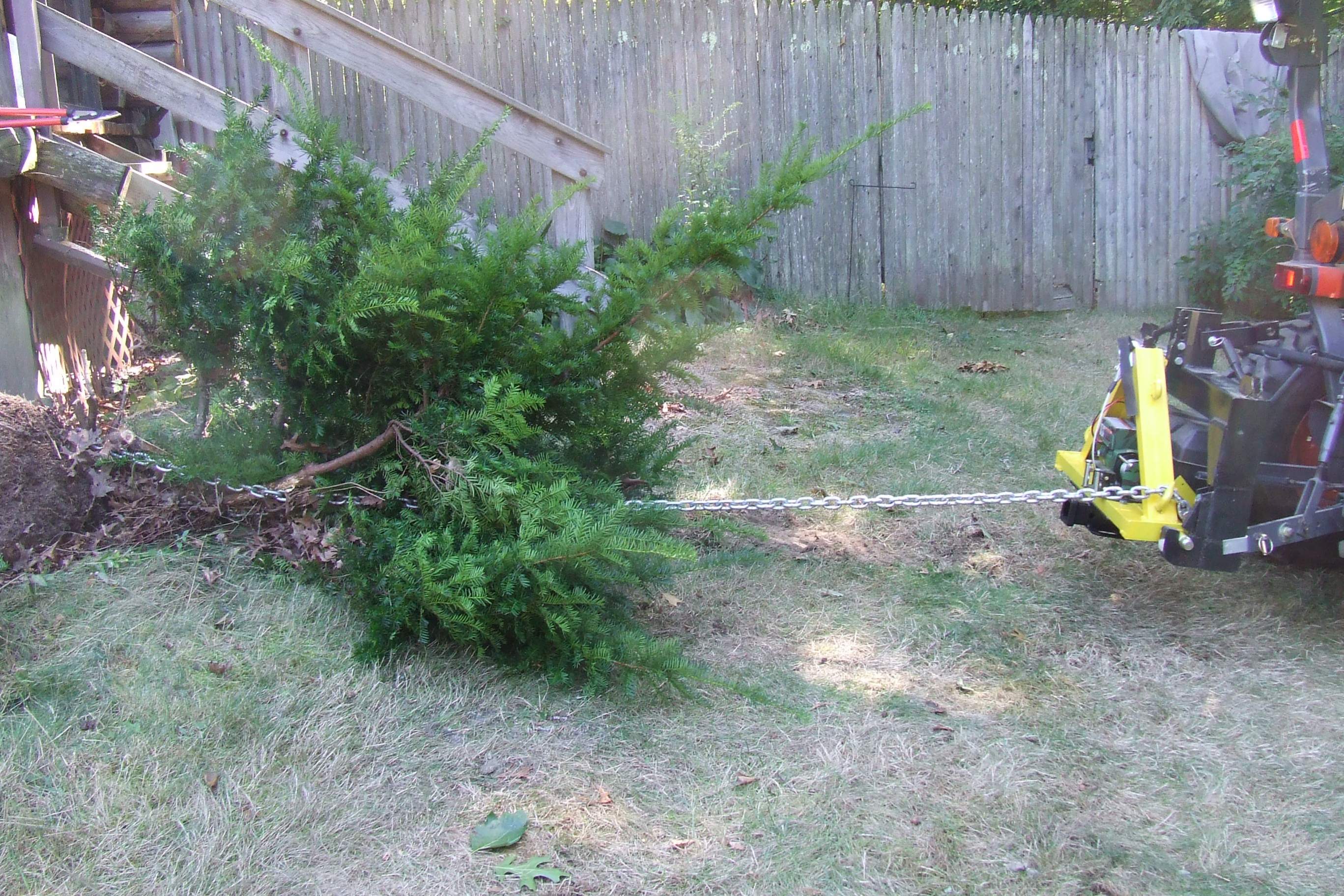

Thanks, Matt. The winch has been the best for little too-tight-to-pull with a chain situations. Also, dropping a tree AWAY from the garage seems to keep my wife a lot happier! I've been able to tension things in two directions with a rope to a snatch block to the tractor and the winch pulling for that added insurance in a different way. I can adjust the tension of it even in the middle of a cut. It's worked out pretty good so far.:)
