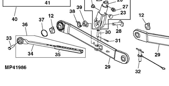

That seems like an inconvenient form of sway control. You may want to fab something like this with a pin adjustment.:thumbsup:

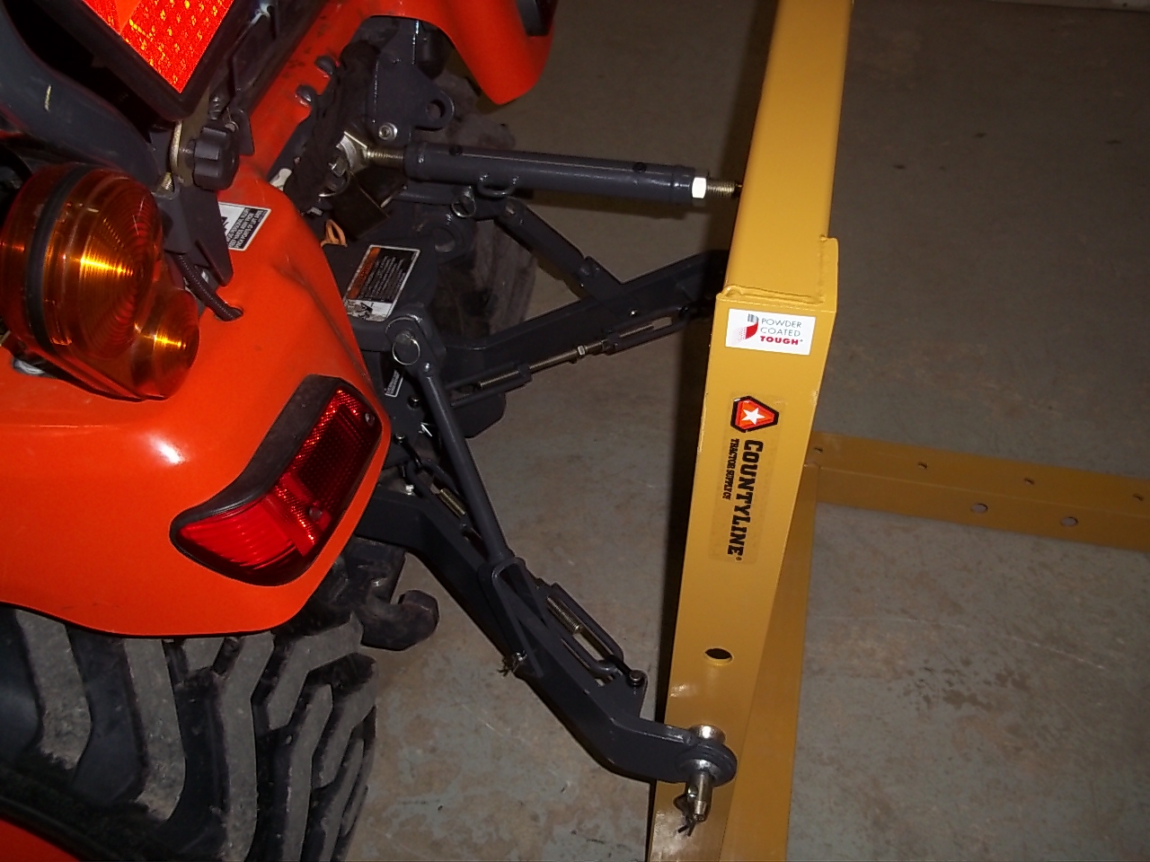

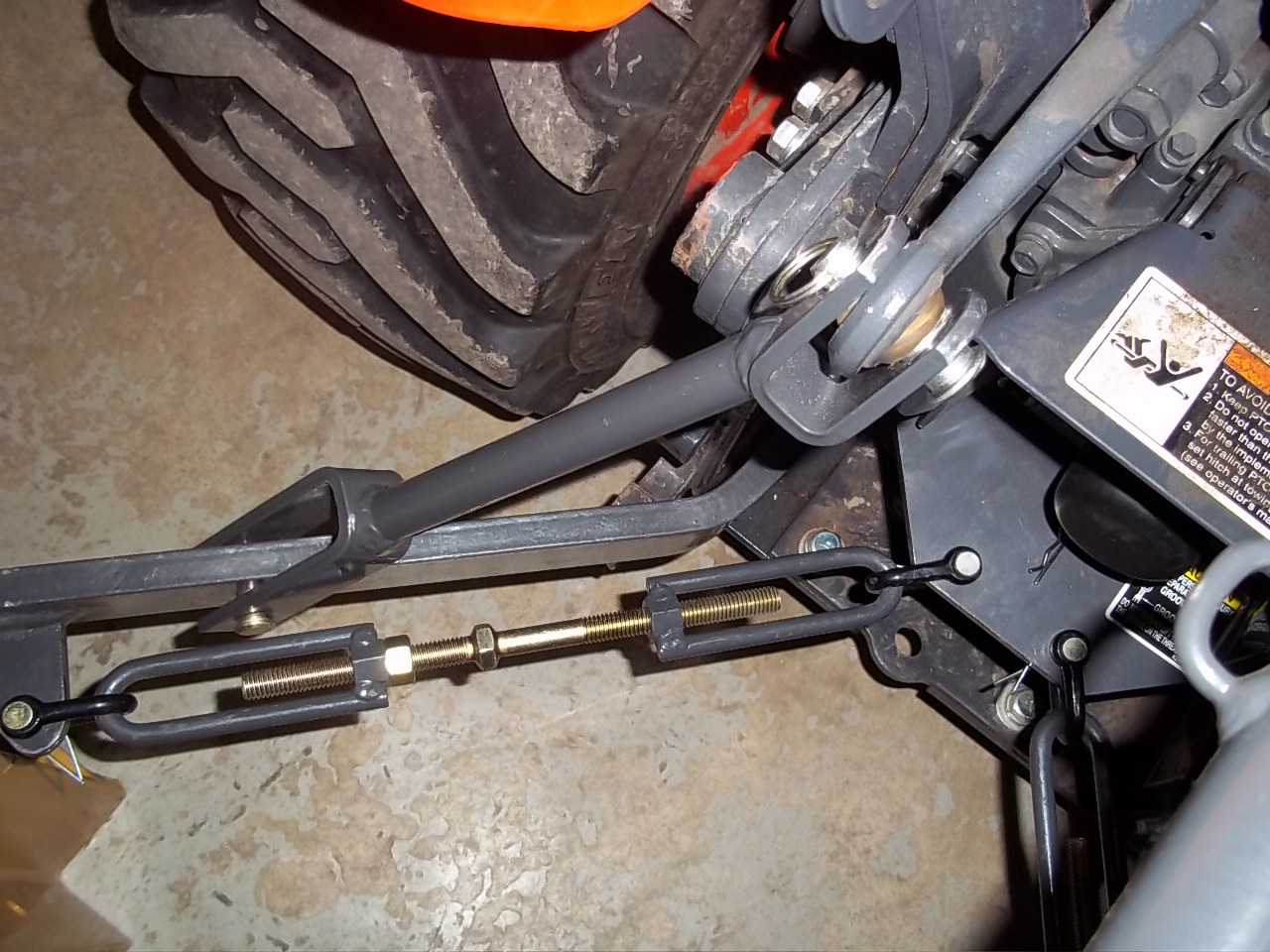

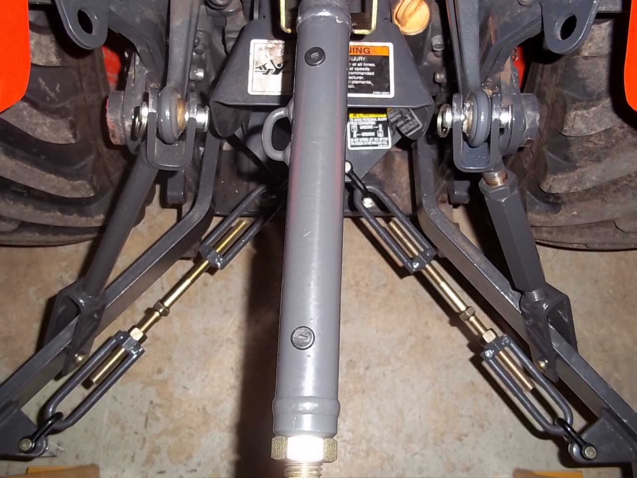

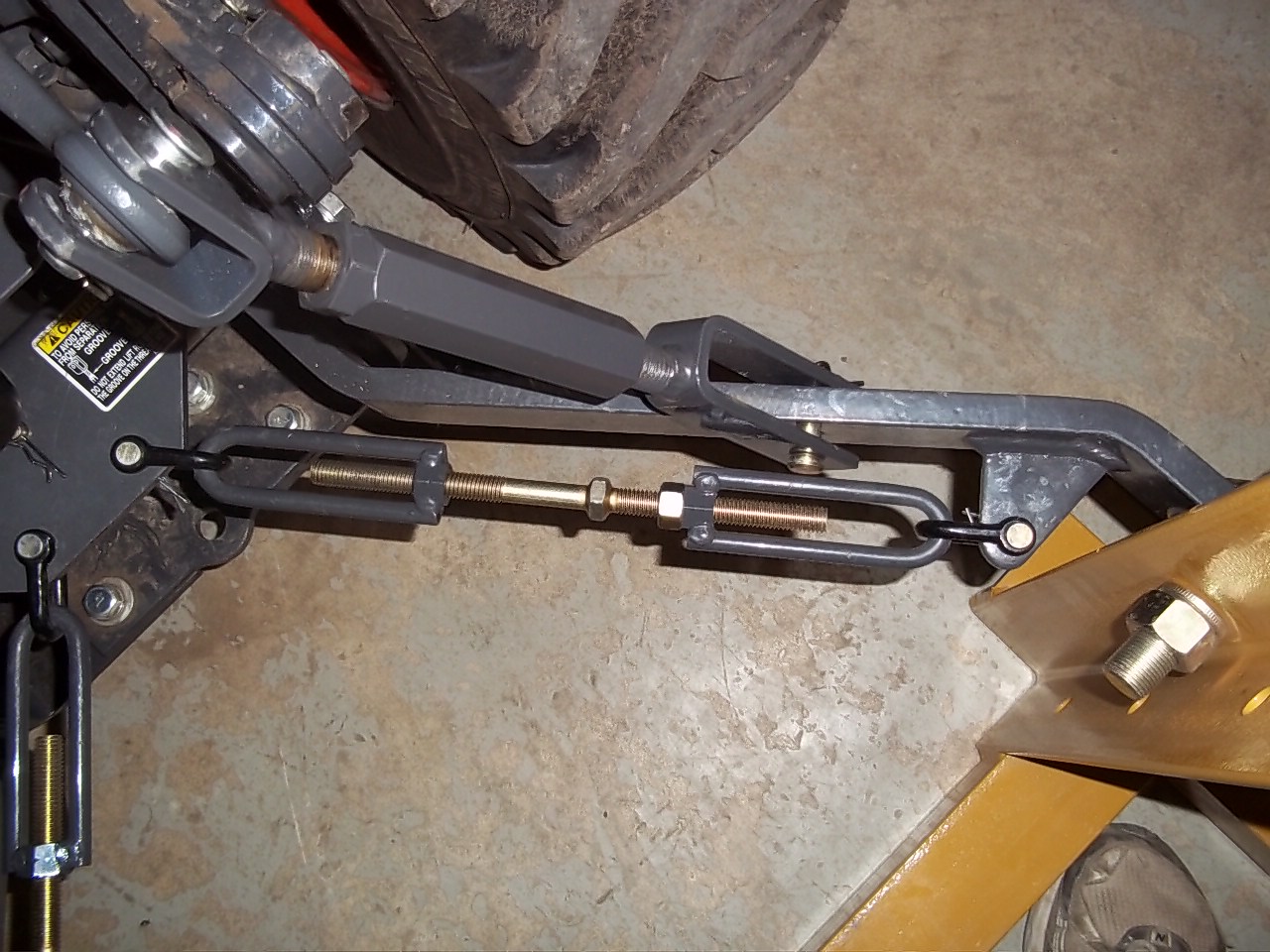

Glad you got that figured out. Looking at those turnbuckles...I don't think I would like them, either.?? Do they "dangle" when you have them loose.??...I think Not.??
Like I said before, my carry-all is a bugger to hook up. Part of the reason is that once you install your planking of wood it leaves no space for the 3pt. arms to go back beyond the pins. I know, it's hard to explain.....
In your last series of photos look at the first frame. Look at how your 3pt. arm (the very end) is flush to the frame of your carry-all. Now, imagine your carry-all with the wood in place. The arm is going to collide with the wood, leaving no wiggle room to hook up.
The thought just came to me to leave a void in the wood where the pins are.
Does anyone understand.??:laughing:
My carry-all is the lightest attachment I have and it is the worst gosh darn hook up that gets to swearing everytime. I'd rather hook up my snowblower, as I mentioned earlier in this thread.
Kyle, it is important to understand the turnbuckles. When you get a heavier attachment on there you'll want to be certain that the attachment will not "sway" into your tires. A bit of sway is good in most cases, but keep it to a minimum....say no more than 2 or 3 inches of sway. (or less).

The turnbuckles do not dangle, they are rigid. When I was taking the pictures I was thinking the same thing about there not being any room to hook up the lift arms...About it swaying, I watched a video earlier and the guy explained all about the swaying...

This is what I did. I hate the turnbuckles. I'm making the adjustable side links now.

I'd say it's time the OP considered a Quick-Hitch, and use cotter-rings instead of the various pins mentioned. Check out McMaster-Carr www.mcmaster.com and search for cotter rings.

Thanks for the help everyone!!! :thumbsup: I was able to get the nuts loose and get everything tight and level. Now I have one last question: to get the implement off, I just turn the main nut the opposite way and leave the stop nut in the same spot, right? Oh, and here are the pics:
You have the right idea for removal of the carryall.
It is a PIA to keep turning that turnbuckle each time you put on an implement, however.
Larger tractors have the turnbuckle (or chains) on the outside of the arms so it is simply a matter of swinging the arm wide and then swinging them back to mount to the pins - no adjustments necessary. That is why teg mentioned earlier to turn the lift pins on the carryall to the inside. Then your lift arms would swing out to engage the lift pins.
However, a trick I used was to remove one of the pins from the clevis on the end of the turnbuckle. That frees up the arm to swing out and then back to connect. Then put the pin back in and no adjustments have to be made. A "hairpin" clip on the clevis makes it much easier.
Finally, I ended up getting a Pat's Easy Hitch and all of this nonsense was over. Just back up, lift the arms to engage the pins, hook up the top link and away you go.
