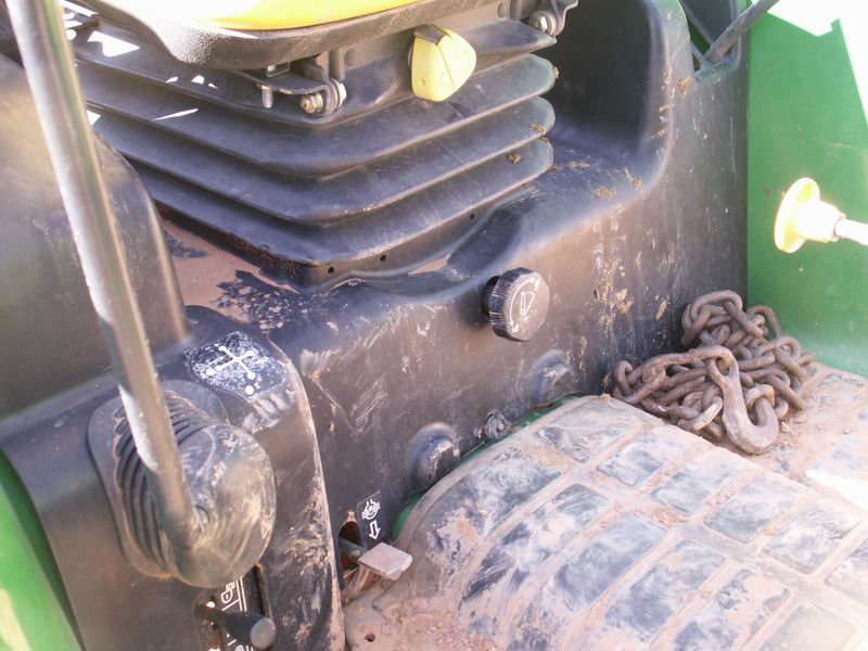

Check to see if the rockshaft rate of drop knob is screwed all the way in. That will stop it from raising

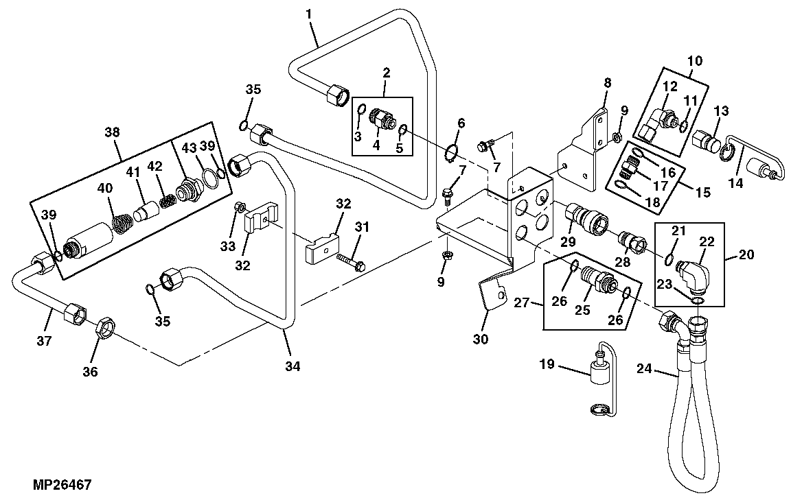

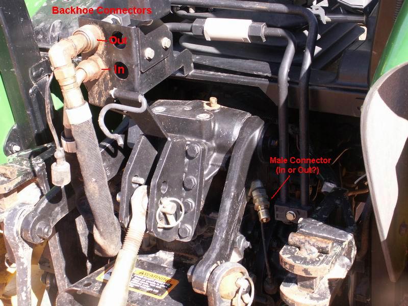

OK, thank you for all for the suggestions. I have now :
1. added the proper JD hydraulic oil to get the correct level (it was a little low) . Thanks JD4300 ,I found the sight glass
2. Checked and opertated the rate of rise/drop valve knob under the seat in all positions.

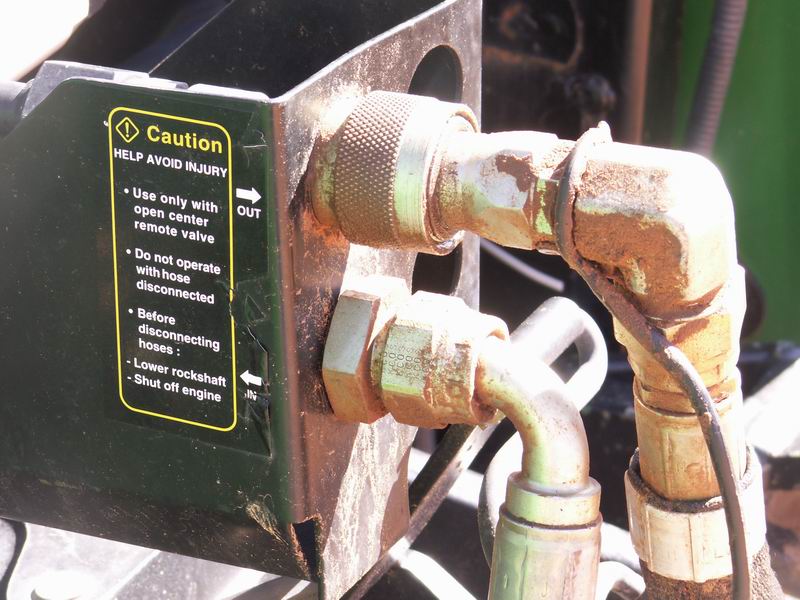

3. Rechecked all my hose connections. It is connected now identically to the way that "rully" in the thread shows in the picture for the hoe disconnected and the 3 point hitch to be operative. (loop out from the top connection back in to the bottom. This is actually the only way it can be connected since there is only one QD female on the tractor) Thanks, kennyd
4. I can tell that the arms are movable by hand (there is about 1/2 free play upward with the hoe attached)
Still it doesn't work. Not a sound, not anything.

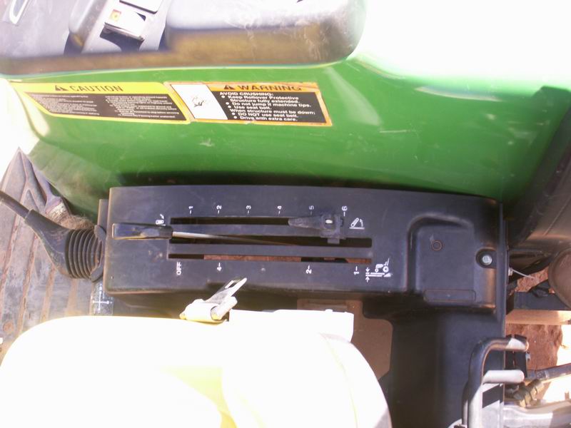

Did you check the rockshaft control linkage? I would thnk you would hear something if fluid was applied and no movement was detected. If your hitch has position control it may be out of adjustment, just a guess.

The 1050 may have a more "organic" problem.. I'm guessing that sambo has the older, model 8 hoe and the model 80 loader. I had the 8A hoe and the 80 loader on my 970. The power beyond circuit is as staightforward and the sun comin' up (always in the east). And the PB can only go - male connector to female.

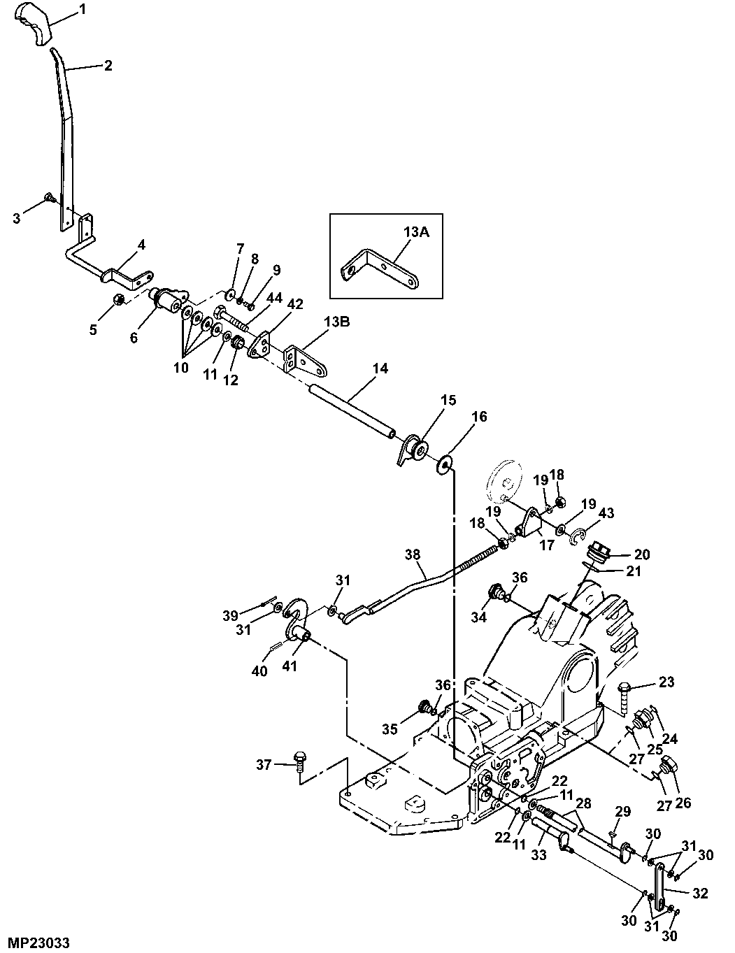

Diagram below of the rockshaft linkages:

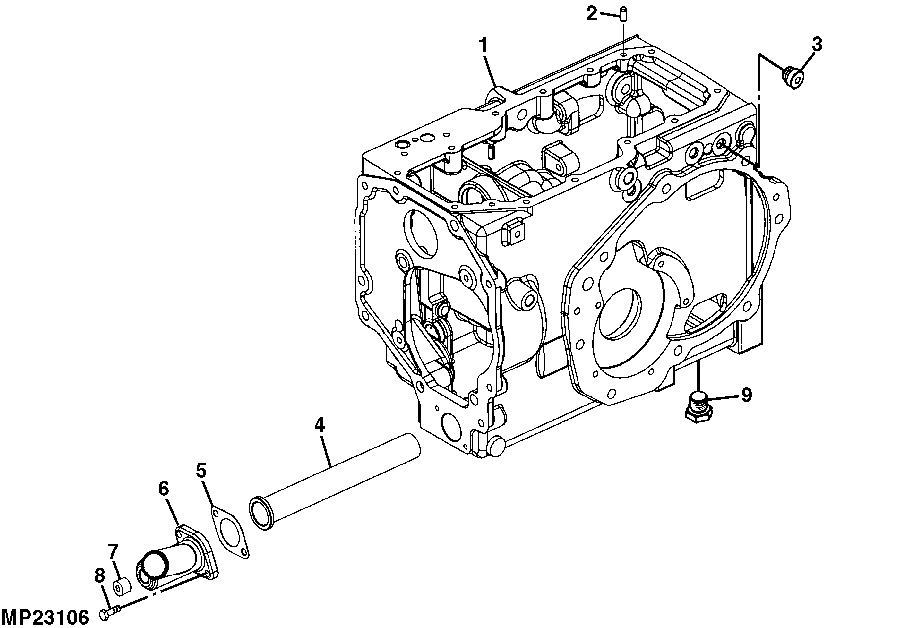

Kennyd,
Do you know anything about that "oil suction screen"
It says in the manual, that if it gets clogged the 3-point hitch won't work.
/ 3-point hitch not working #29
I have never seen that switch on mine.
Kennyd,
That's the main screen in the bottom of the sump (#4 in the diagram)...if it's clogged then the loader would not work either-and the tranny would be having issues as well.
This is a simple problem...I just know it is!

The 3PH is disabled by plugged the return line from the BH into a different coupler that bypasses the 3PH-I explained this in the above posts and included pictures.
There is very little electronics on a 4x00 machine, hence the need to bypass the 3PH by other means.
The manual is showing a "rockshaft control valve filter"
Note: If changes in the operation of the 3-point hitch lift capacity are detected or the rockshaft control valve should begin to react slowly, erratic or fail to cycle properly, performance of this service procedure may be required.
Its showing in a picture to take the seat and the whole platform out, to get to the "Rockshaft Control Valve Filter"

I am now confident that all the hoses are connected properly. Kennyd is correct that the 3PH is bypassed hydraulically when the BH is attached, because the backhoe fluid goes to a return directly to the sump. When the BH is removed, the the return is connected to a line that goes somewhere under the seat and presumably to the 3PH valve. Mine is now and has been connected correctly since I started reporting here. I rechecked all connections
Last night I removed the return connection at the Power Beyond to check flow. I had great flow of the fluid, so no clog in the flexible lines to that point. Tonight I will try JD4300's idea that there is a filter at the point that the solid return line enters under the seat assembly.

OK, I have finally diagnosed the problem, but I have not fixed it yet. The problem was the limit control. (position control?) I removed the entire seat assembly. I could then see the two shafts coming out of the rockshaft area of the transmission , the higher shaft is the lever linkage and below it, the limit control shaft. I assume that this limit shaft is some sort of overflow valve that tells the rockshaft valve not to operate when it hits the limit point. So when the dealer installed my 447 BH two years ago, he failed to readjust the limit control. So the 3PH position with the BH mechanically mounted on the tractor was beyond the limit point, so no movement at all. I had to disconnect the limit linkage and move it by hand PRESTO!!! the rockshaft came to life! Now I am really annoyed because the nuts that require adjusting on the limit control linkage will require some fancy side load wrenches becasue it is really tight working in there. It got dark and I could not work on it any more tonight, but thanks you all for all of the ideas. I would not have had the patience without the daily help and ideas.
Kennyd, do you have the diagram of the limit control linkage? It is really hard to tell whether some of the threaded areas are seperate links or one piece, I'll need to figure it out to make the adjustment.
The one I posted in post #26 should be the one you need...if not I will dig deeper later when I get home.
