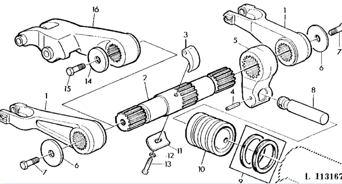

It's possible, if your connection between the rockshafts and their rotary actuator is splined, you could reassemble the rockshafts a few spline teeth upward to raise the range of motion.

The rockshaft adjustment suggested above may work also.
