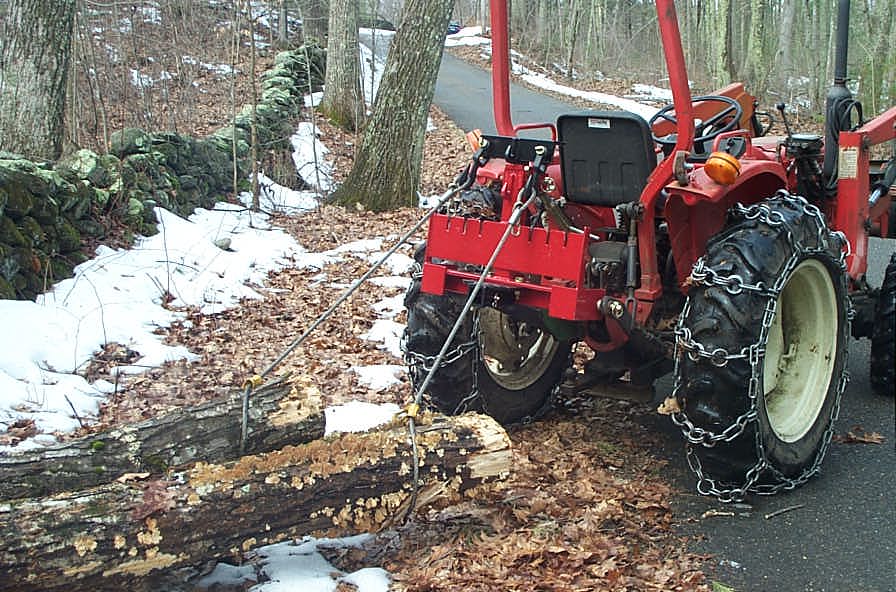

Very interesting. I would be interested in seeing what the prices are If the prices are up at the level of the Farmi logging winches, it would seem that they would be a better choice in that they can drag stuff to the tractor that the tractor cannot get to. OTOH, if it's all accessible to the tractor, then a grapple like these can do an easier job of grouping a bunch of stems together.

Hi there. I am in the process of building a logging grapple/winch combo. It is based on a Farmi JL601. This is a serious winch which can pull anything a farm tractor up to about 130-150 hp tractor can handle. I needed to be able to winch in a load and then just lower the grapple, grab, lift, and then go!

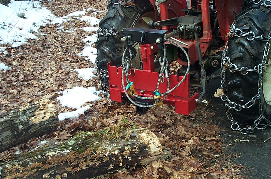

Simpler and less expensive.
A less expensive alternative.
