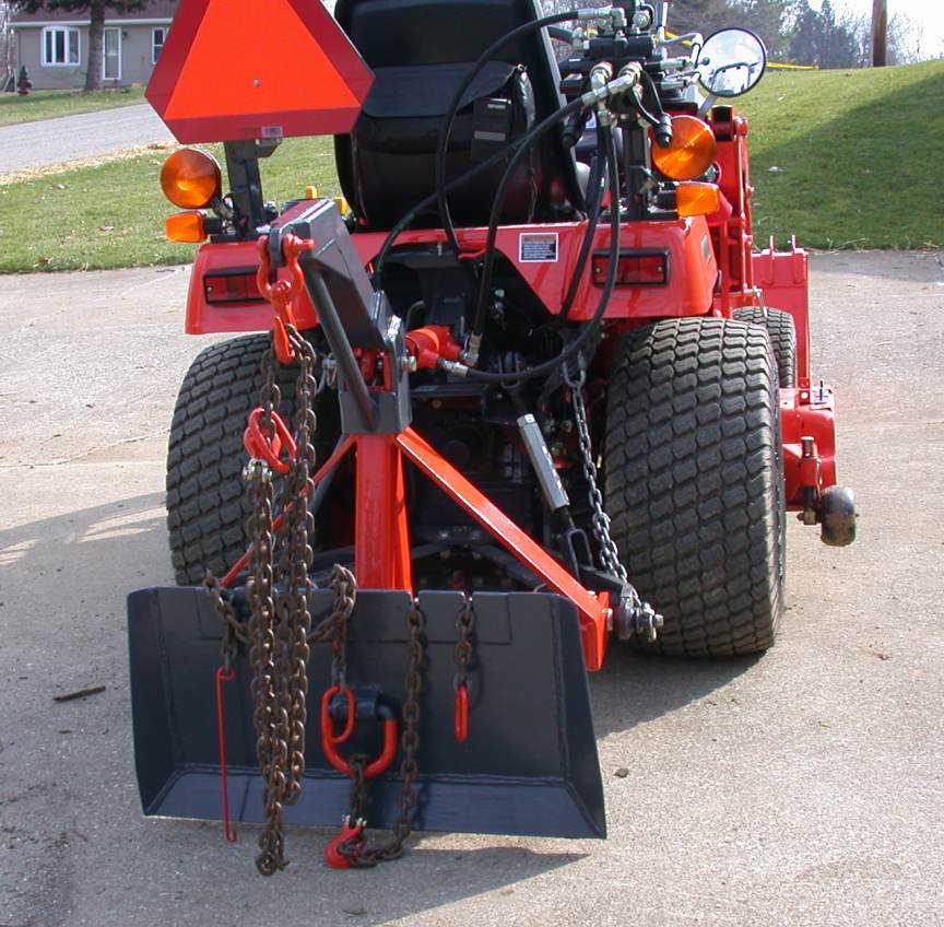

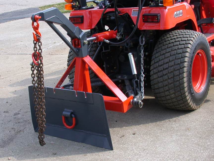

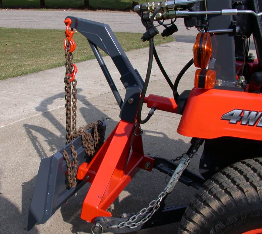

I've used mine for one season so far, works pretty well. There are four grab hooks mounted at the top to hang chokers from.
Sean

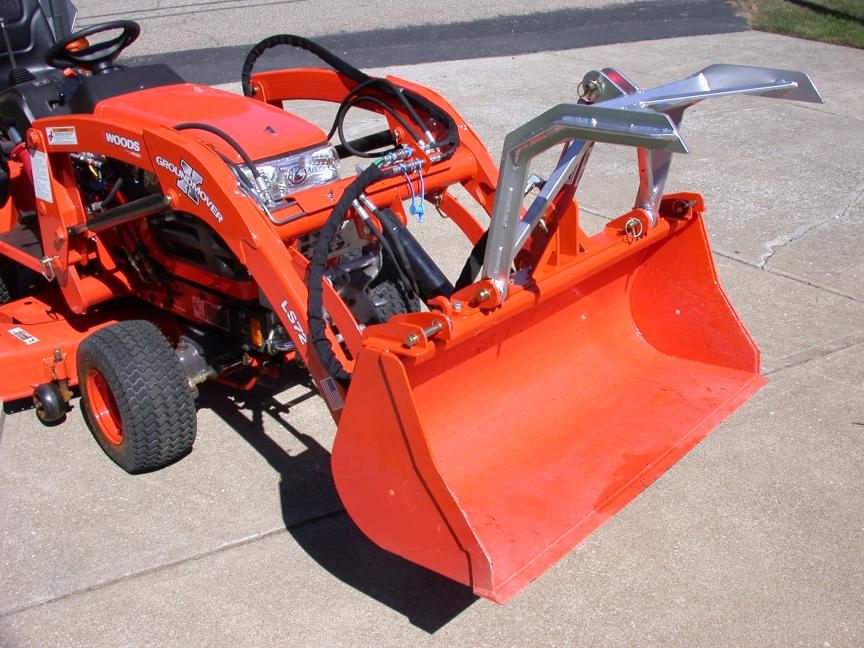

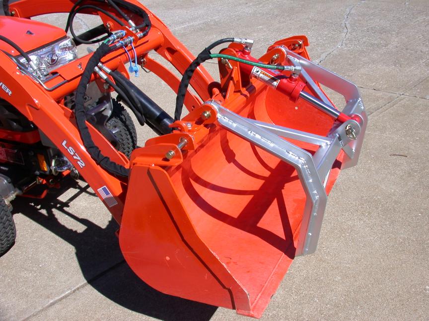

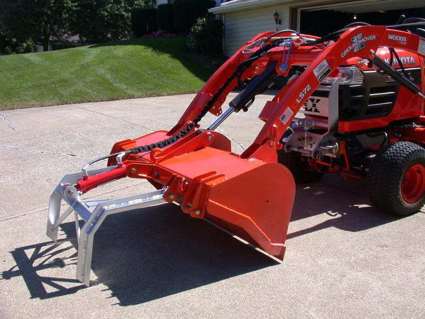

Hey, HarleyScooter that looks like a great setup. What are the wider clevis attactment points on the bucket for. Thanks, Dan
They are for a set of brush forks.

Do you always run without pins in the drawbar or do you crank the turnbuckles tight so they are not needed?
Yup after bending a turnbuckle because of too much play. I crank the turnbuckles tight so there not needed. The 2 ears below the PTO are pinned.
My son came up with that quick efficient hook up but it's better without the hitch pins.

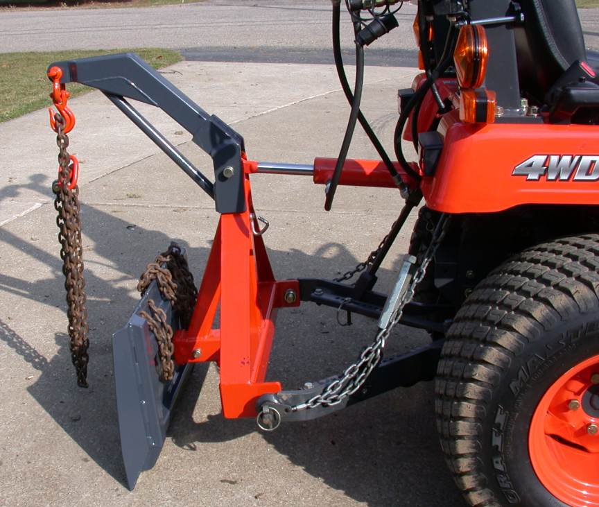

HarleyScooter, what type/model valves did you by and where did you mount them? Some pix of that set up would sure be appreciated. why not tap into the loader valve fro the grapple valve? Thanks a million.
/ 3-point hitch log skidder #25
Rusty, I used Kubota valves and hooked into where the backhoe hyd lines are. I already had the rear remotes so eight extra feet of hose was a lot cheaper than the extra valve set up, it took a little getting use to but now it is no problem.

To restate SWLT's comment, this is my basic rule:
Lift with the 3pt; pull with the drawbar.
And by drawbar, I mean the one that's permanently under your rear axle.
It's a little more work to make both hitches, but there's never a hint of the front end go skyward.
I usually use a choker chain and and a grab link on the drawbar instead of the 1" rope.
That particular log was to big to get the choker chain around with enough left to reach the drawbar, hence the rope.
This is especially imortant if you try to climb a substantial grade with a similar load.
I have a HF quick hitch that I plan to modify with a blade on the bottom and a beam on the top for holding the tongs. A separate draught chain will be hitched to the drawbar.
