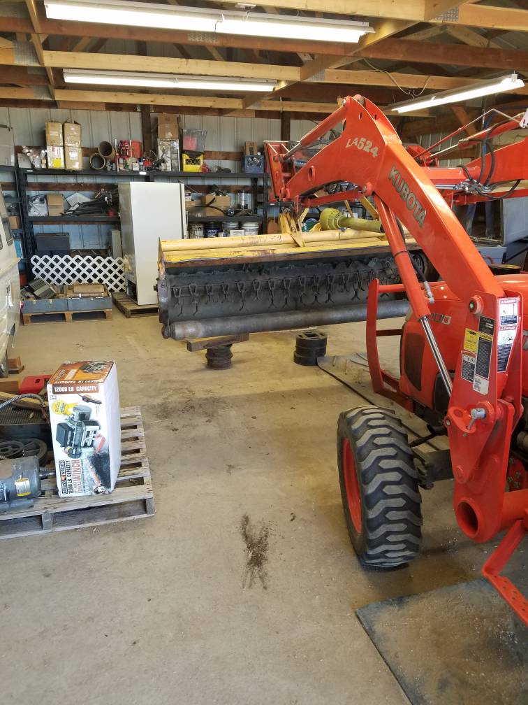

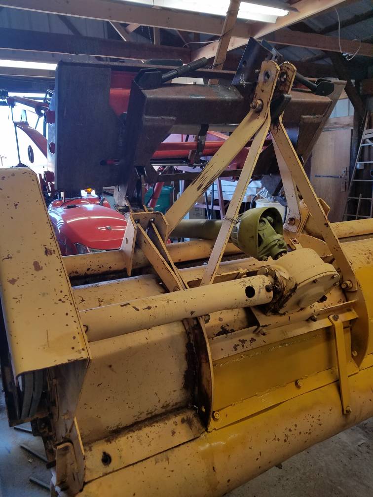

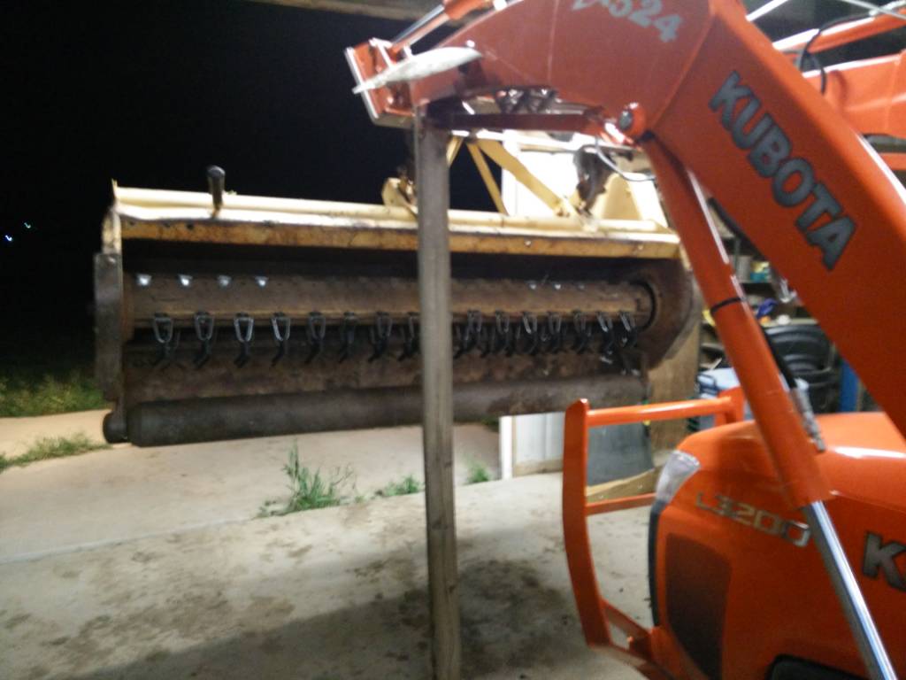

I built one. SSQA plate & welded a quick hitch to it. Worked great & was the mount for my old snow plow. Handy for servicing the knives on the flail mower too.
It ran off with the plow & the old L3200. Picked up some SSQA plates from a garage sale & another QH (from a TBN member who doesnt like them) at cheap used prices. Need to get around to welding them together.

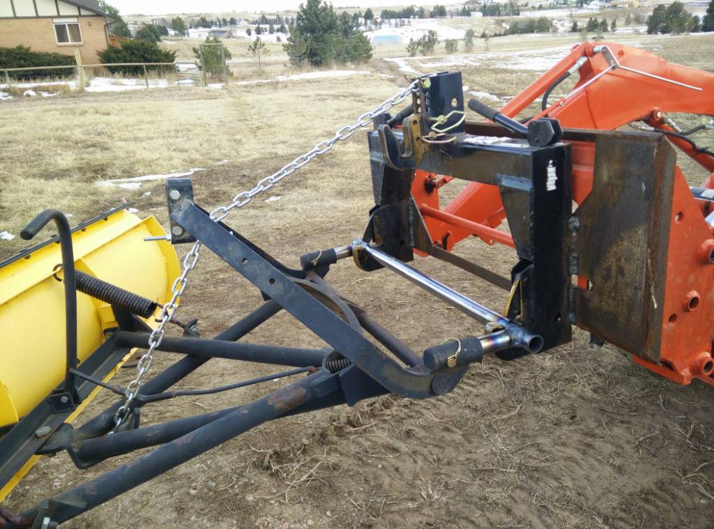

Instead of having hooks on my bucket, I welded them on the adapter. Here is the Snowsport plow on it for the first time. And the carry-all.
3pt adapter 001_1.JPG3pt adapter 002_1.JPG008 (2)_1.JPGTC snowsport 1_1.JPGweld hooks 002_1.JPG
