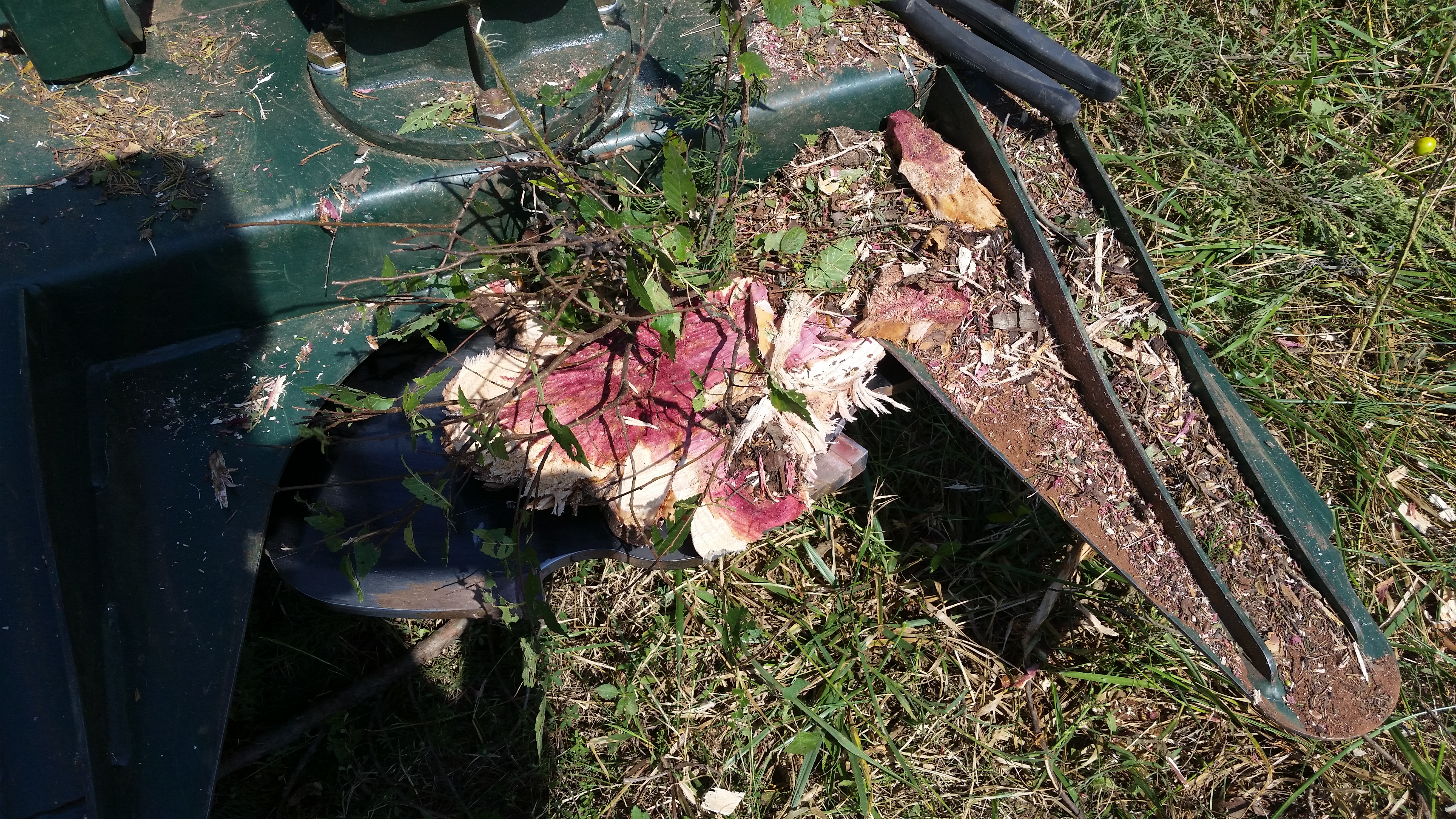

While I was out cutting today I learned another consideration with any tree saw similar to this one. It is possible to jam the blade with a wedge that is cut off a stump. Here's a pic of the jammed wedge.

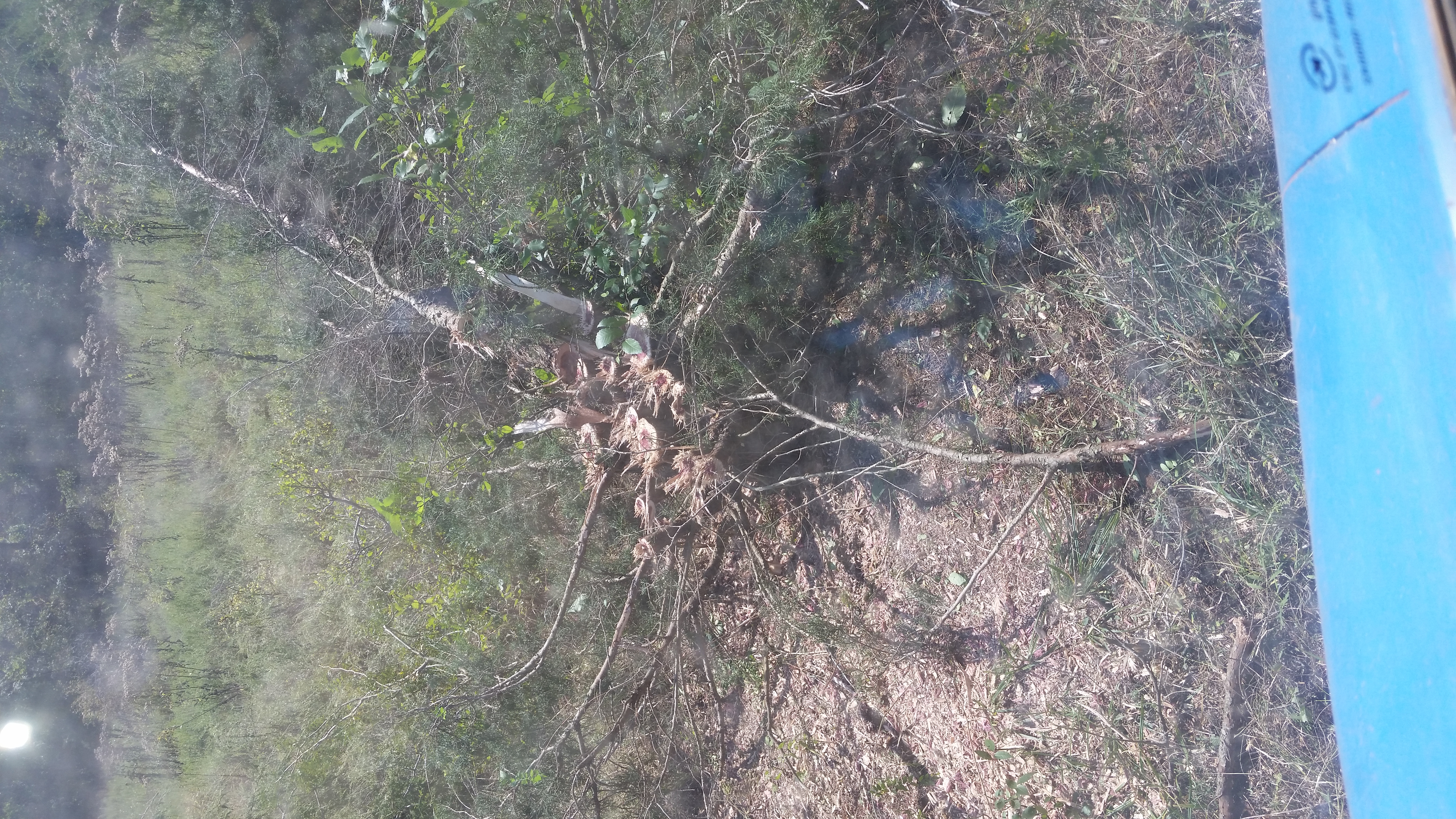

Here's why I was cutting wedges off of the stump.
Some cedar's have multiple heavy branches that are right on the ground. When you back into this type cedar the heavy branches keep you from getting close enough to the stump. My solution is to cut the cedar up higher so you can now see the stump. Then start taking slices off until you can cut at ground level. One of the slices jammed in between the blade and housing. It's no big deal and was easy to pull out once I shut everything down.
I have also noticed that small saplings can get jammed in between the blade and housing at times. So I just clean those out every time I stop and clean the radiator out. No big deal but something to keep watch on.
